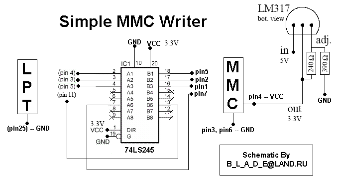

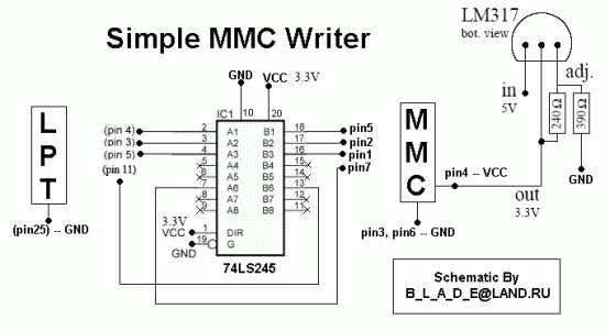

If you cannot find such a card reader - make it by yourself, you should create something similar to SIM-card reader which connected to LPT or COM-port and after that write the program which can send MMC-commands to your card

Here is manaul of MMC-cards - http://www.jedec.org/download/search/JESD84-B42.pdf
You can find lock/unlock command there
See the picture for example of LPT cardreader
File comment: MMC LPT cardreader

That's some good info Doomer, you just saved me plenty of hours of net jetting :lol: Thanks!

Thanks Doomer, I was giving it a fast look, actually, I didn't understand how to send the commands (through a program?), I'll look better later

You should develop a program which will use LPT port data-lines and send serial MMC-commands (sequence of bits) to your MMC-card
