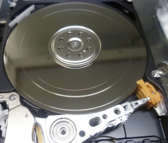

In as few questions as possible, how did I get a near perfect clone of this drive? :-)

Spildit wrote:
- Drive depoped at factory, no data on the damaged platter.
+1
- Drive contains less data and last used sector was before the first scratch from inside out.
Data Recovery Pakistan
 Post subject: Re: Quiz time!
PostPosted: January 31st, 2016, 6:56
Posts: 7864
Yep, top platter surface unused. De-popped at factory!
One very lucky lady got all her family photos back! :-)

WD refurbish a drive that shows this kind of scratches and put it back on business??
I wonder why they fail... :shock:

Lucky client Sean,
I do not think that these damages left the factory, a later crash is the cause.
Your client made a superior choice in you, could imagine others would have rejected this case after lifting the lid.
Have seen it before that 1 or 2 heads are not used, if the failed qc or simply downgraded to lower capacity i can only guess.

I have seen one case at Tom's Hardware (?) where a 500GB (on the label) WD drive benchmarked like a 3-head 750GB drive that had been shortstroked.
PostPosted: February 1st, 2016, 2:25
Posts: 16960
If the drive had left the factory in a crashed state with the affected surface disabled, then the whole platter would have been reduced to glass or shiny metal in very short time.

The drive had been dropped.
PostPosted: February 1st, 2016, 4:53
Joined: July 12th, 2010, 4:38
Posts: 1451
And only the top platter was damage?
No other problems?
If so, why did WD depoped that head? Some kind of problem was detected there....
