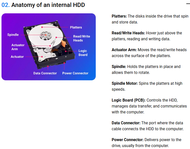

See the "Anatomy of an internal HDD" section:
https://www.westerndigital.com/solutions/hard-drives/internal-hdd

I'm not sure what you mean by that, but there are 3 bad mistakes in the picture.

I'd say 4.
Logic Board vs. Heads Connector,
Actuator vs. Magnet
and obviously data connector and power connector.
