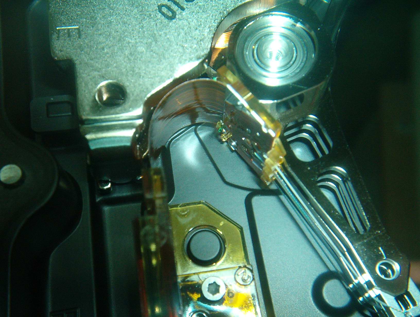

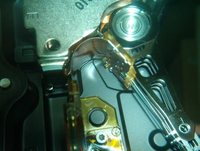

Hello, friends
Somebody wanna guess, what is the problem?
The drive comes with no detection in bios.
The customer replaced the pcb, and no change.
I have measured, the preamp with dmm and looks good. :D
Any idea? :D

Some soldering? :)

pepe wrote:
Some soldering? :)
Yes, the VC's wire left the pad, caused by cold-soldering.
You are the winner! :D
Congratulation!
Janos
