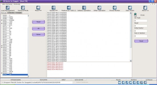

 Post subject: ST9320320AS FW:HP07 probleme
PostPosted: July 10th, 2013, 15:02
Joined: June 13th, 2013, 5:58
Posts: 52
Location: french
Hi
I have an ST9320320AS FW:HP07 drive that can load normally whith hd doctor
have some mod errors
so it can not be detected by os and bios
how to solve please.
I begin to sincerely unsatisfied by the hd doctor; the support is very poor.
i posted several posts with no replys!!!
ST9320320AS_2.JPG [ 155.3 KiB | Viewed 8946 times ]
ST9320320AS_1.JPG [ 83.28 KiB | Viewed 8946 times ]
 Post subject: Re: ST9320320AS FW:HP07 probleme
PostPosted: July 10th, 2013, 15:07
Joined: June 13th, 2013, 5:58
Posts: 52
Location: french
i mean the salvationdata support
thx
Users browsing this forum: No registered users and 37 guests
