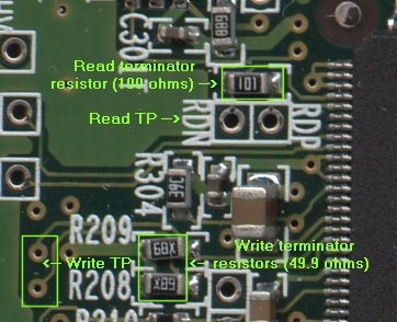

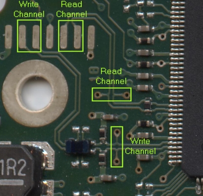

Forum rules
 Post subject: Tip: How to identify the Read Channel test points
PostPosted: March 17th, 2014, 21:11
Posts: 17323
Tip: How to identify the Read Channel test points
The read and write differential pairs are identifiable as two thin parallel signal traces running between the HDA connector and the MCU. They are terminated in resistors at the MCU end. The read terminator connects across the differential pair, while the write pair has a resistor on each side. Each pair of traces is of equal length, and they terminate at the HDA pads in a characteristic "Y" pattern.
Here are several examples:
http://www.users.on.net/~fzabkar/HDD/RW_TestPoints/
Some newer PCBs have no visible termination resistors on either the read or write differential pair. In such cases it may be possible to identify the read channel by measuring the two signal pairs both on and off the HDA.
The write channel is driven by the MCU whereas the read channel is driven from the preamp. When the PCB is off the drive, the voltage on the read channel test points will be 0V with respect to ground whereas the write test points will be 1V or thereabouts (possibly 1.8V). When the PCB is on the drive, the read channel test points will now rise to around 1V or so, and the write channel will settle into a similar range.
I'm not certain if the above observation is applicable to all drives, but I have verified it on a Hitachi.
Original article:
http://malthus.zapto.org/viewtopic.php?t=123&p=1632
WD800BB-53CAA1_RW_TP_comp.JPG [ 121.91 KiB | Viewed 18766 times ]
WD800BB-53CAA1_RW_TP_bot.JPG [ 58.28 KiB | Viewed 18766 times ]
ST3120022A_RW_TP_comp.JPG [ 81.77 KiB | Viewed 18766 times ]
ST3120022A_RW_TP_bot.JPG [ 95.79 KiB | Viewed 18766 times ]
SP2514N_RW_TP_comp.JPG [ 81.05 KiB | Viewed 18766 times ]
DiamondMax16_80GB_RW_TP_top.jpg [ 89.34 KiB | Viewed 18766 times ]
DiamondMax16_80GB_RW_TP_bot.jpg [ 53.8 KiB | Viewed 18766 times ]
 Post subject: Re: Tip: How to identify the Read Channel test points
PostPosted: March 17th, 2014, 22:22
Posts: 4001
Thanks for posting that here, I was looking for it the other day while Spildit's was down.
Could you please clarify what is commonly refered to as Shorting the Read Channel?
Does that mean just put tweezers ove the 2 read test points, or you actually ground them? What is the shorting supppsed to achieve, is it a prposely built in feature to enable added functionality to Terminal, or enable it when disabled, or it tricks the MCU in some way?
 Post subject: Re: Tip: How to identify the Read Channel test points
PostPosted: March 18th, 2014, 4:16
Posts: 17323
The read channel is the data path between the MCU and the preamp. It is also the path that servo data takes. AIUI, the read channel is interrupted by bridging the read pair with tweezers, or by introducing a noise signal into the signal path. I believe one can also add an RC filter across the pair under certain circumstances.
AFAIK, this procedure is used to prevent access to the SA at appropriate points in the power-up process. For example, the 7200.11 BSY bug had a corrupt SA module that prevented the drive from reaching readiness.
 Post subject: Re: Tip: How to identify the Read Channel test points
PostPosted: March 22nd, 2014, 15:39
Posts: 17323
Here is a Toshiba/Hitachi PCB:
DT01ACA300_HDA.jpg [ 179.42 KiB | Viewed 18673 times ]
There is a kink on one side of each R/W channel pair. These kinks are intended to equalise the lengths of each trace.
 Post subject: Re: Tip: How to identify the Read Channel test points
PostPosted: March 25th, 2014, 15:31
Posts: 17323
Here is a Seagate 7200.12 PCB:
Seagate_100535704_RW_Channel.jpg [ 116.08 KiB | Viewed 18633 times ]
