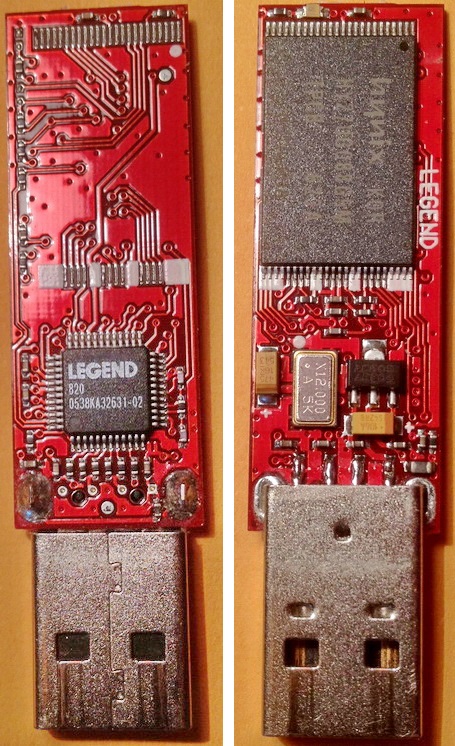

I have this older 1Gb flash drive in to recover. The Chip dumped fine
// Chip
Company      Hynix
Name         HY27UG088G5M
ID code      ad dc 80 95
// Structure
Bus          8
Banks        2 x 512 MB
Page         2112
The controller is one Ive never seen, and cant seem to find any ifo - probably a fly by night rebranded one:
There is definately no XOR applied:
I tried creating an image with a few different parameters, GDB on the image gives pretty good filenames but files corrupt.. pictures are quite close though.
Anyone have an idea what controller it could have cloved or seen one of these?
cheers

Whenever I have needed to reverse engineer an unknown part (eg one that has had its markings ground off, or has been rebranded with an OEM in-house part number), I have determined its pinout by way of its connections to known components.
In your case you could trace each of the Hynix NAND flash pins back to the controller.
You could then determine the Ground and 3.3V VCC pins with reference to the 3-pin linear LDO regulator IC and the USB ground.
Locating the USB Data+ and Data- pins would be straighforward.
The 12MHz crystal appears to be associated with 2 capacitors and a resistor (~1Mohm ?) near the "-02" marking on the controller.
The date code on the controller (820) suggests that it was manufactured during the 20th week of 2008, so that might help narrow down the candidates.
HY27UG088G(5/D)M Series 8Gbit (1Gx8bit) NAND Flash, hynix:
http://www.hynix.com/datasheet/pdf/flash/HY27UG088G(5_D)B%20(Rev0.2).pdf

The Controller itself would probably be impossible to track down, and likely no information exists to help figure out the mix of data. The only reason knowing a controller helps is to narrow down likely candidates for how it stores the data on the NAND, and a single controller number could have 30 different possible data mixes. There are common attributes that can be used and common operations done to the data that can sometimes be easily identified, but it is extremely time consuming if the actual data mix you have in your hand is not supported in the recovery software.
What you are looking at in the other thread is a very basic and probably old data mix.
what do I mean by data mix? It may pay to explain that. When the data is sent to the flash drive for any reason, formatting, saving files, deleting etc., the controller does operations to it to save the NAND wearing blocks out and to save ECC data. It does this depending on the firmware. It also does this knowing a certain structure is on the NAND.. block sizes, page sizes, where the ECC and other OOB Data(SA, Spare area, Service area or whatever you want to call it) is stored..
the way it is structured has many variations. The OOB data could be stored at the end of each page in a block, a few pages and then all the OOB data, start of pages, or even in the page itself. The number of ECC bytes can be different, the markers for the block different, inverted, rotated, operations on the Spare area can be different to the data, There are literally hundreds of ways to store data on a NAND.
Add to that the data could be XORed with some string of bytes, of varying sizes, the SA might or might not be. The blocks are not in order. The pages in a block may need to be shuffled around, or even need to be striped with other blocks, data inverted etc. Different numbers of chips and banks add more complexity.
Also, a computer expects sector sizes, whereas a Flash drive may not care so you would need to take the "sectors" and transform them to match.
Another thing the controller could do is to allow for shitty chips, such as cut a certain number of blocks from use from the start, the end of the image, the bank or after a certain number of blocks. You may have a 16GB chip in a 8GB Flash drive, with the data stored say the first half of 2 banks, or the last half, or the middle half.
Then you have errors in the drive such as a block that was copied but the old block exist with the same block number, or even a block with a few bit errors. It does not take a very big mistake in putting all this back together to have a corrupt or unusable result, sometimes a single correction can be make or break.
There are other factors as well, different things like a block being logically rotated by some bytes
Imagine going into a library and putting together a shredded book where you don't know how big the pages are, the pages in a chapter, or how many pages it has...
The other thread example, I am well on the way to figuring it out, but had many interruptions. It is an extremely simple flash drive, no XOR.
Take this as part of the answer for the other thread.
cheers, thanks for taking an interest in these issues.

Update:
I've recovered all files. 980 Files, 79 Folders. Only 26 corrupted files, so pretty happy with the result.
Never ID'd the controller, but in this case it is a non issue.
cheers :)
