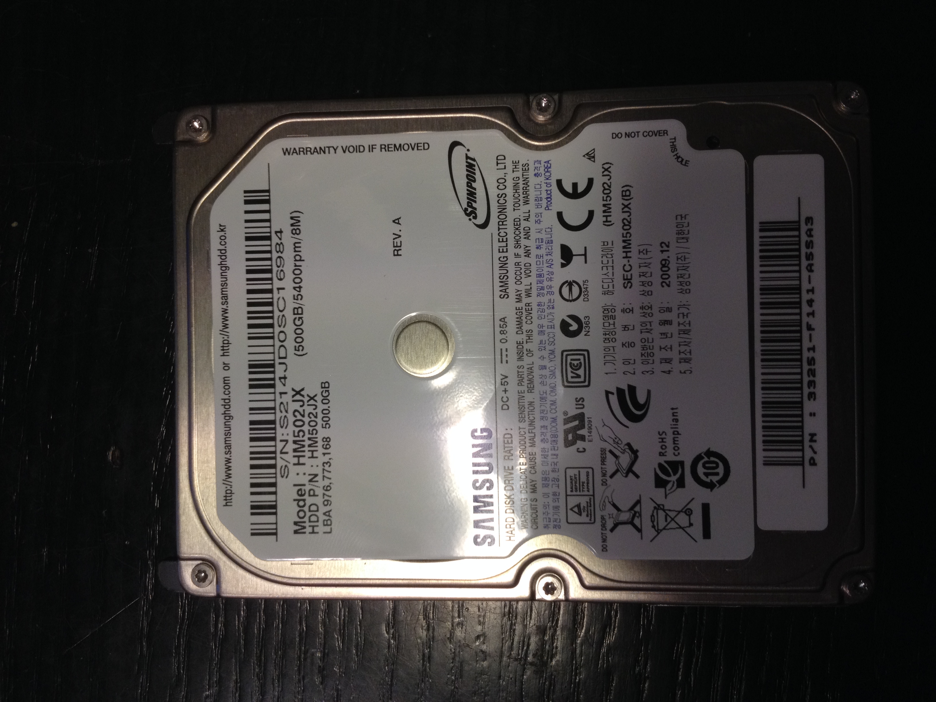

I have a HM502JX Samsung that doesn’t respond whatsoever and no Led blinking when I try to connect it.

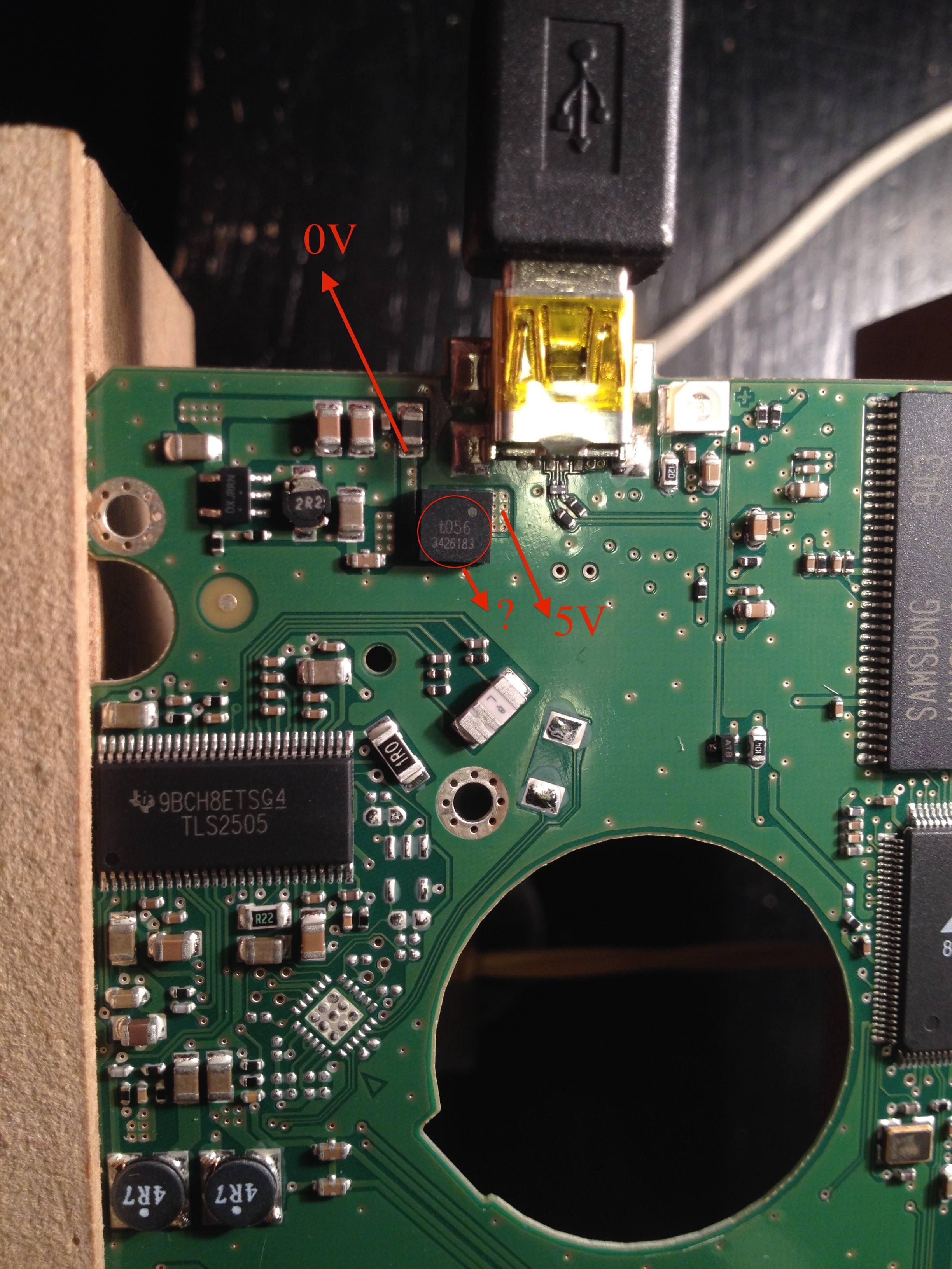

Measured where I receive power:
Sidenote: is the black IC just next to the mini usb connector some kind of mosfet ? I don’t find anything about this chip (S/N: 3426183 t056)
So I don’t get any power to my regulator because this 3426183 doesn’t allow any current to pass.

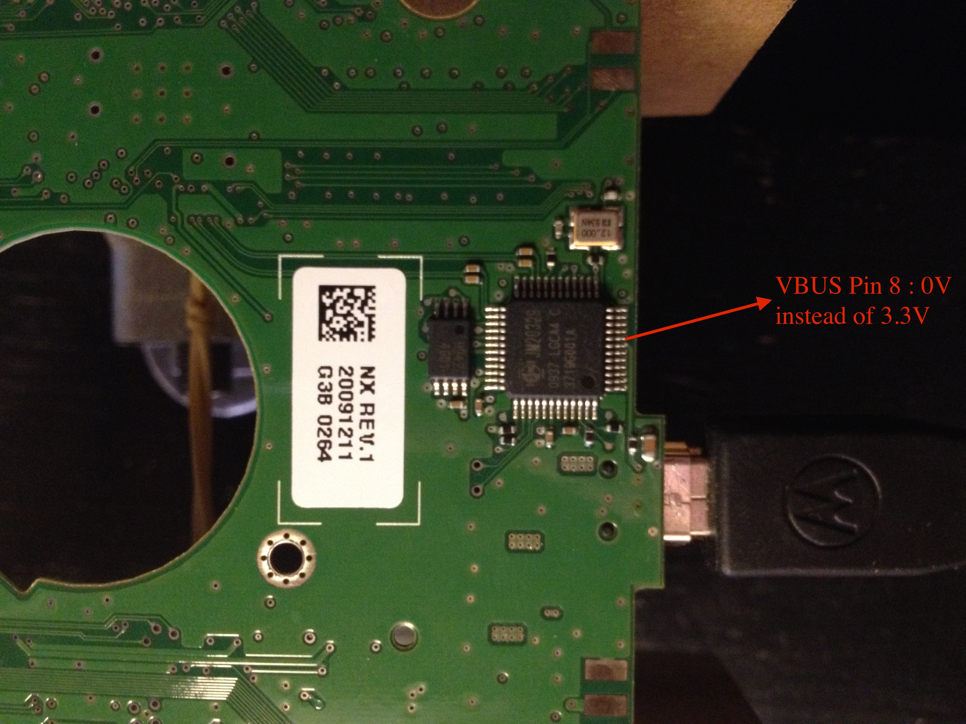

There is a VBUS pin 8 on the jm20329 chip that checks if 5V supply is connect via a resistance divider, see data sheet (provide by Arvika in another topic):
http://www.hxwtek.com/upload/jm20329_standardsch_lqfp48_1v0_for%20open.pdf
And I measured the Vbus pin, no voltage when 5V is present on connector.
I also measured the resistance and I have a 4.3 K between Vbus pin 8 and Gnd and 4M between Gnd and Vcc on the connector.
Now my question is:
Can someone point me to R2 and R3 (numbered like in the data sheet)? because I assume it’s a bad soldering…

I suspect that the "t056" part is a choke which filters the +5V supply.
 Post subject: Re: HM502JX Samsung: missing Vbus signal
PostPosted: December 3rd, 2014, 20:46
Posts: 17316

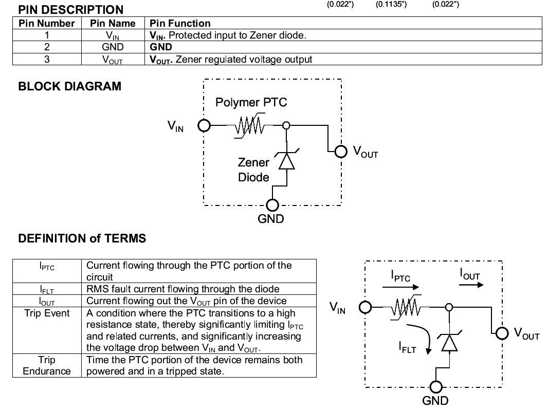

No, it's a PolyZen.
USB Peripheral Protection using PolyZen Devices:
http://www.circuitprotection.ru/upload/ ... PZ_USB.pdf
ZEN056V130A24GS, Raychem, PolyZen, 5.6V, 1.3A, marking t056:
http://www.farnell.com/datasheets/1500300.pdf
http://www.comtec80.com/files/polyzen.pdf

Thank you, fzabkar!
Again good lesson, never assume how a component works.
I will first test if its bad soldering because its a bit twisted on the board.
And then replace it.
I will let you know if it fixed.

If the PolyZen proves difficult to obtain, you might like to replace it with a polyswitch and 5V TVS diode. Alternatively, you could use a 2A fuse, or if you are certain that there are no other problems and that your PSU is good, then you could link Vin and Vout with a wire.
Good luck.
BTW, you can find polyswitches on old motherboards. They were/are used as current limiting devices on USB ports.
