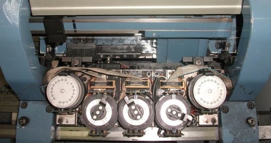

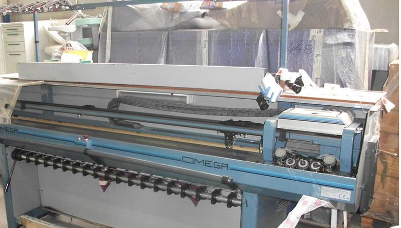

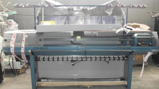

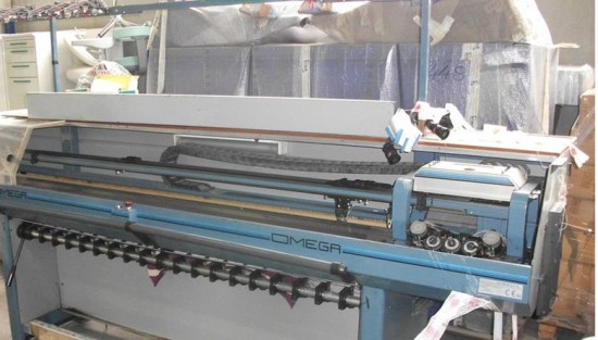

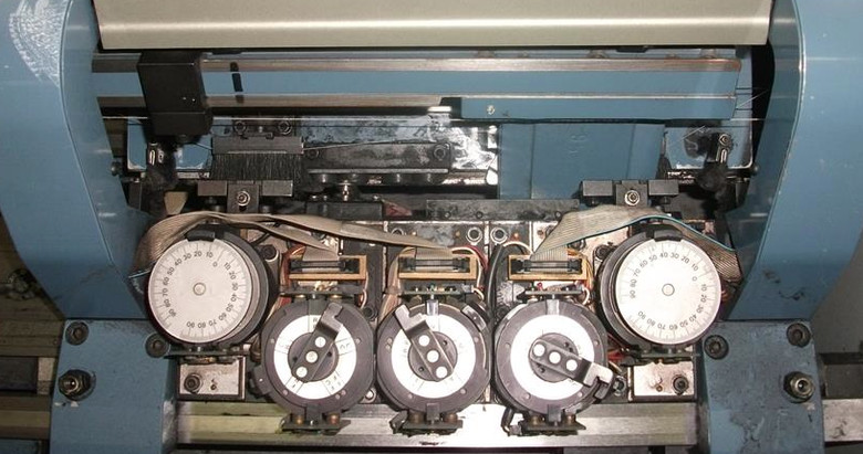

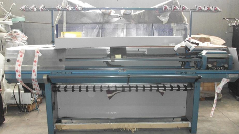

Is this the machine you own ?
This request may sound silly, but once the company that is in the building next to ours once had a issue with a corrupted firmware of a machine that wasn't supported anymore (no web presence, company bankrupt...) After googling a bit they ended up finding a ex-worker on LinkedIn of the manufacturer of those machines and he was able to retrive the latest firmware and get it back to work again.
Google for Omega Echo webtex.ag and try sending those guys an inquiry!
or FTL time.
Good luck!
P.S: Excuse this english, been all day trying to correct the pads of a tsop48, I can't even...

This machine has only one cart... The one we are refering to has 2 carts so the hardware is not the same. That means that the software and firmware are expected to be different as well. Since the manufacturer is the same, the story must be very similar.
There are several omega models.. Such as nikita, echo and zip. I dont know if there is any chance of compability... But hey... Making a contact doesnt hurt..
Thanks for your help.. I appreciate it.. :)

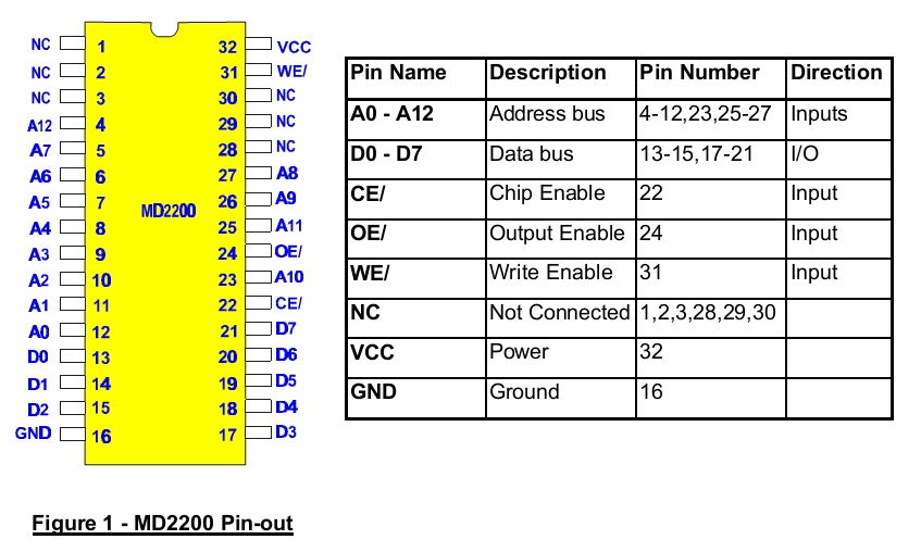

The DOC PCB has a 3.3V LDO regulator IC at the bottom left corner. Therefore I suspect that the DOC is a 5V part. Measuring the Vcc and Gnd pins at the IC socket on the main board should confirm this.
LM3480IM3-3.3, Texas Instruments, 3.3V, 100mA, LDO regulator, marking L0A, SOT-23
http://www.ti.com/lit/ds/symlink/lm3480.pdf
I would first check whether the regulator is working.

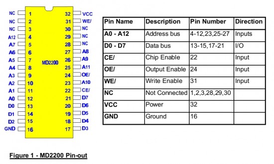

The NFDC-2148 flash controller appears to contain the IPL boot code in its internal memory. Therefore ISTM that one way to test whether the controller is alive would be to read the DOC as a standard 32-pin JEDEC flash EEPROM in a regular chip reader. You could select any device with the same voltage and pinout, eg SST28SF040A.
http://www.metatech.com.hk/datasheet/ss ... -10-DS.pdf
Of course you will only retrieve 8KB of data (the rest of the address space would be aliased).
The LM is OK.. it was burned... so we have replaced it and tested it. Since this was done, and we didnt knew the extend of the damage we managed to get a new board from another equal DOC bought from germany. The new DOC board was equal to the original (all references equal.. same controller, resistors, etc).. so.. 100% sure the LM is ok.
We have replaced this controler by another one from a new board (as mentioned above) as we have suspected it had totally burned because the LM was initially faulty. Is it possible that the failure from this DOC was because this controller became also damaged and that the new controller's IPL was blank or based on a non x86 platform?!? Are you sure that the IPL is on the NFDC-2148? The donor controller (2148) as mentioned above was from another equal DOC that we managed to get.. (but i cant make sure what it had inside.. so i dont quite know if the donor controller had a x86 platform originally.. to be quite honest... we didnt even knew this had a ROM within.. i know... what a dumb thing to find out now.. :\ )
