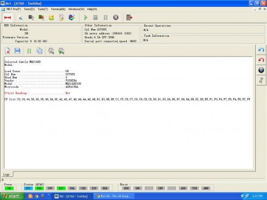

 Post subject: help fix hdd toshiba 1TB
PostPosted: April 23rd, 2016, 4:53
Banned User
Joined: January 1st, 2016, 11:12
Posts: 90
Location: Viet nam
I have a new working toshiba.
Selected family:MQ01ABD
Model:
Load Zones : .........................:OK
Cyl Num : ............................:207055
Head Num : ...........................:4
Vendor : .............................:TOSHIBA
Model : ..............................:MQ01ABD100
Microcode : ..........................:AXFA1U9A
G-List Reading : .....................:Err
CP list:33,34,44,56,92,95,98,9A,9C,A2,A5,A7,A8,A9,AA,AD,AE,B1,B3,BB,BF,C1,C5,C6,C7,​C8,C9,CB,CD,D0,D1,D3,D4,D6,D7,D9,DA,DB,DC,DD,EF,F1,F3,F4,F7,F8,FA,FB,FC,FF
help me data recovery
1tb.JPG [ 92.24 KiB | Viewed 12174 times ]
Banned for spamming
 Post subject: Re: help fix hdd toshiba 1TB
PostPosted: April 23rd, 2016, 12:38
Joined: February 16th, 2016, 3:31
Posts: 6
Location: Russia
If the disk hangs in "BSY", try leaving it alone for a while. Perhaps he will give the readiness and it will be possible to clear the g-list.
Or you can remove the contact between the PSB and the connector that go to the heads, turn on the power, wait until the disk will give the readiness, then give the command "sleep" and not turning off the power to re-establish contact between PSB and HDA - you will have access to SA.
 Post subject: Re: help fix hdd toshiba 1TB
PostPosted: April 23rd, 2016, 14:46
Banned User
Joined: January 1st, 2016, 11:12
Posts: 90
Location: Viet nam
sandy_t wrote:
If the disk hangs in "BSY", try leaving it alone for a while. Perhaps he will give the readiness and it will be possible to clear the g-list.
Or you can remove the contact between the PSB and the connector that go to the heads, turn on the power, wait until the disk will give the readiness, then give the command "sleep" and not turning off the power to re-establish contact between PSB and HDA - you will have access to SA.
thank you i did try but not ok
Banned for spamming
 Post subject: Re: help fix hdd toshiba 1TB
PostPosted: April 23rd, 2016, 15:06
Joined: February 16th, 2016, 3:31
Posts: 6
Location: Russia
can you give your Skype?
 Post subject: Re: help fix hdd toshiba 1TB
PostPosted: April 23rd, 2016, 21:56
datahdd116 wrote:
I have a new working toshiba.
Umm.... I'm pretty sure if it's new and working you don't need data recovery. Just copy the data.
 Post subject: Re: help fix hdd toshiba 1TB
PostPosted: May 8th, 2016, 13:55
Banned User
Joined: January 1st, 2016, 11:12
Posts: 90
Location: Viet nam
data-medics wrote:
datahdd116 wrote:
I have a new working toshiba.
Umm.... I'm pretty sure if it's new and working you don't need data recovery. Just copy the data.
I checked and the first hdd head replacing faulty data recovery success
Banned for spamming
 Post subject: Re: help fix hdd toshiba 1TB
PostPosted: May 10th, 2016, 6:35
Joined: May 10th, 2016, 6:29
Location: Faridabad
can we recover from internal storage disk of any device?
 Post subject: Re: help fix hdd toshiba 1TB
PostPosted: May 10th, 2016, 16:28
Banned User
Joined: January 1st, 2016, 11:12
Posts: 90
Location: Viet nam
Spildit wrote:
Ok ...
Whatever...
Did you swap heads and you were able to recover data ?
yes thank you
Banned for spamming
