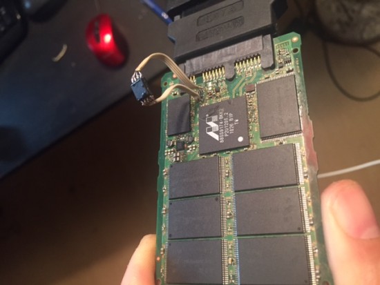

Good morning, my English is not that great. I wanted to know if anyone can help, I have a 512 GB SSD C400 crucial MFTDDAA512 has the firmware damaged a chip n25p80. I try a raw copy of the chip firmware data to be able to be programmed via SPI and then risaldarlo on the board.
I found the firmware but it is in .iso format and is not compatible with via SPI programming. Thanks for your help

firmware n25p80

My ssd bios chip Is empty. Ssd Is invisibile in sata bus. Only programming in spi mode firmware possibile sution for successive visibile ssd in sata mode and extract data.
 Post subject: Re: SSD Crucial c400 firmware raw format
PostPosted: June 14th, 2016, 3:05
Posts: 17335
The EN25P80 chip has a capacity of 1 Mbyte. That's a lot more than 37KiB. My analysis of the firmware update may be incorrect, but in any case you have no information as to the structure of the firmware in the SPI flash. So how do you propose to rewrite this chip?
PostPosted: June 14th, 2016, 8:24
Joined: June 11th, 2016, 10:29
Posts: 55
Location: italy

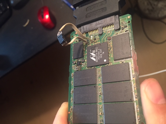

I'll rewrite the chip with SPI interface with flash programmer .
Now I'm buying a second ssd who unmount the chip and always I copy with the programmer . Only I found a ssd 256 and not 512 then there will be some modifcare parameter. I hope to keep the disk sata interface so you can then update the bion properly.
For now, the disc is of course invisible to the sata

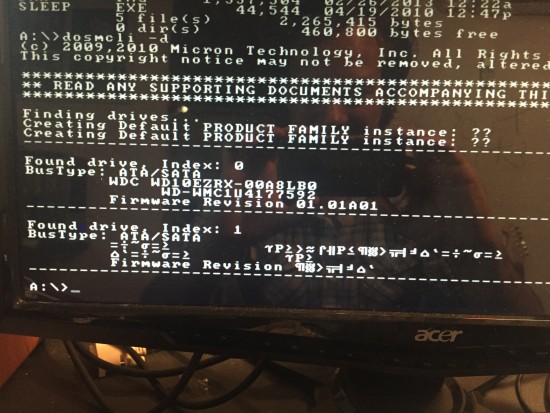

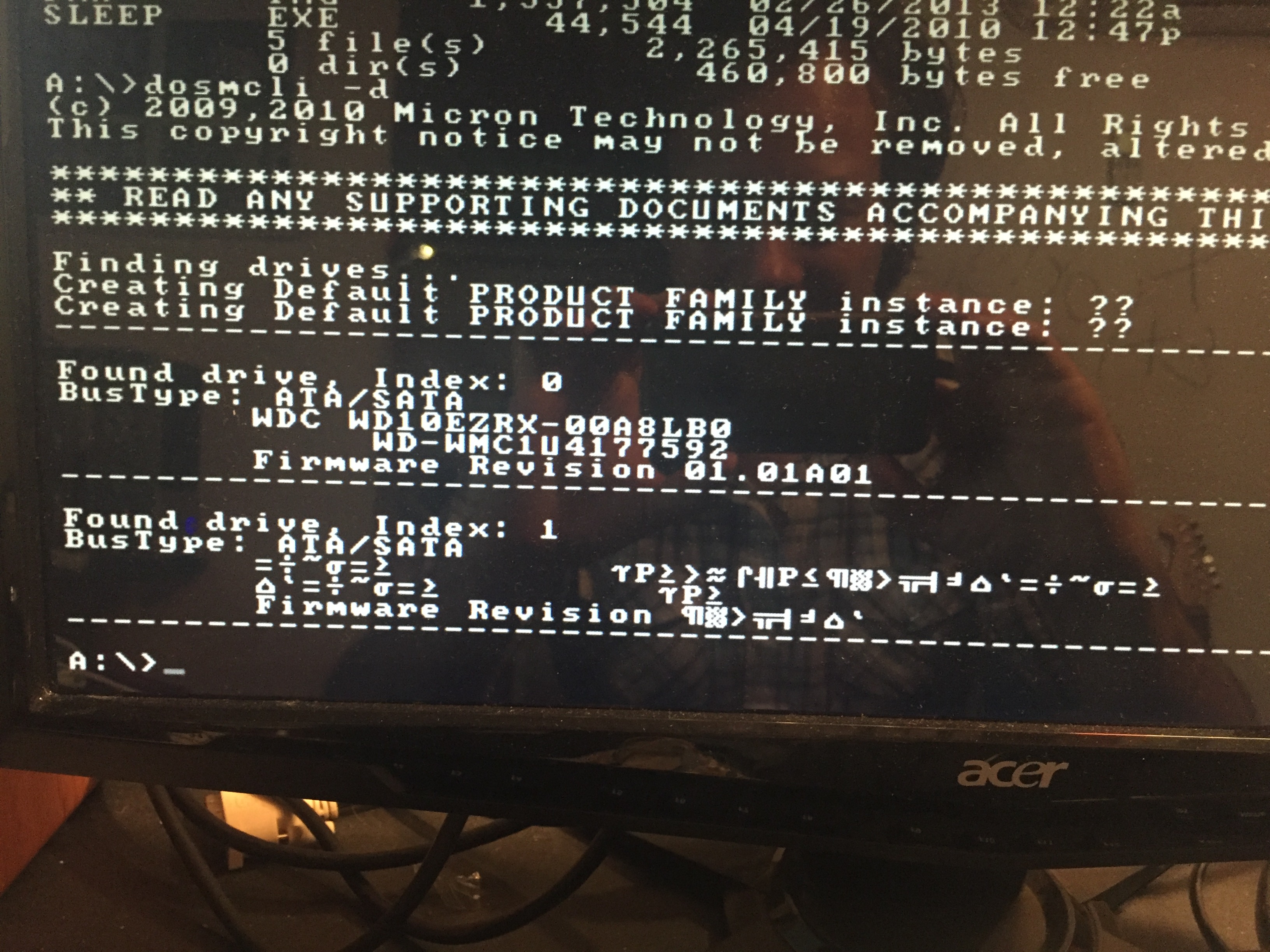

I copied from spi ssd microns c400mftak 256GB inserted into the bios chip and reconnected to SSD 512 not working. connecting via SATA now gives me a disc with a name full of strange characters and a huge capacity in GB. however, no data access unfortunately. I do not know if the bios is necessary to enter the serial number and other data. the fact is that the c400 name does not appear but appear strange symbols. I have repeatedly made the bios verification and writing is correct. I am desperate.

Id problem
File comment: Id problem
