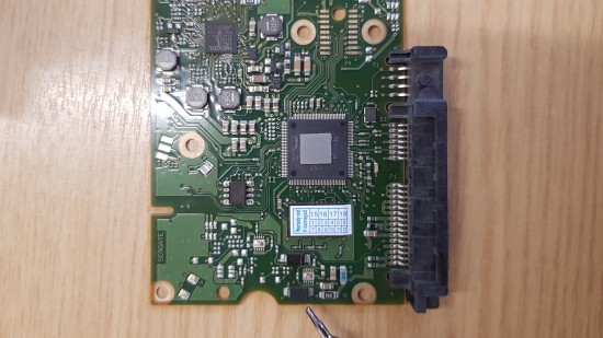

Can you post a pic of the PCB from both sides
 Post subject: Re: Seagate Barraccuda Fried
PostPosted: October 18th, 2017, 9:55
Joined: October 18th, 2017, 9:41
Posts: 13
Location: Manchester
OK - This is the new one, but where the screwdriver is, that was the part that appeared to be burnt out.
The other side looked normal
I will try and find it now.

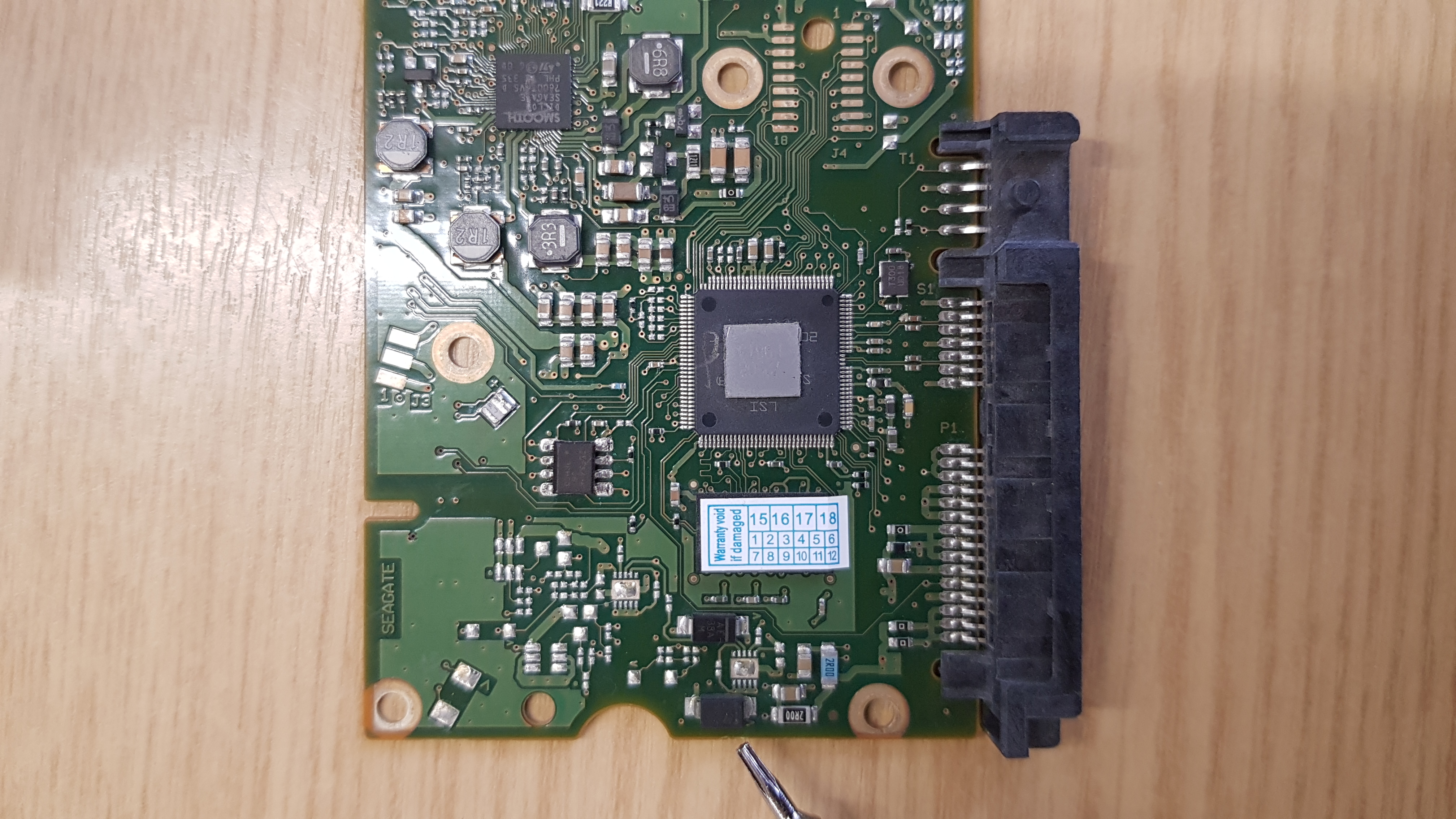

OK, I have the old one see here:
https://imgur.com/a/aPpeS
You will have to ignore the burnt area now as someone tried to solder on a new iodine part or something, which didnt go well.

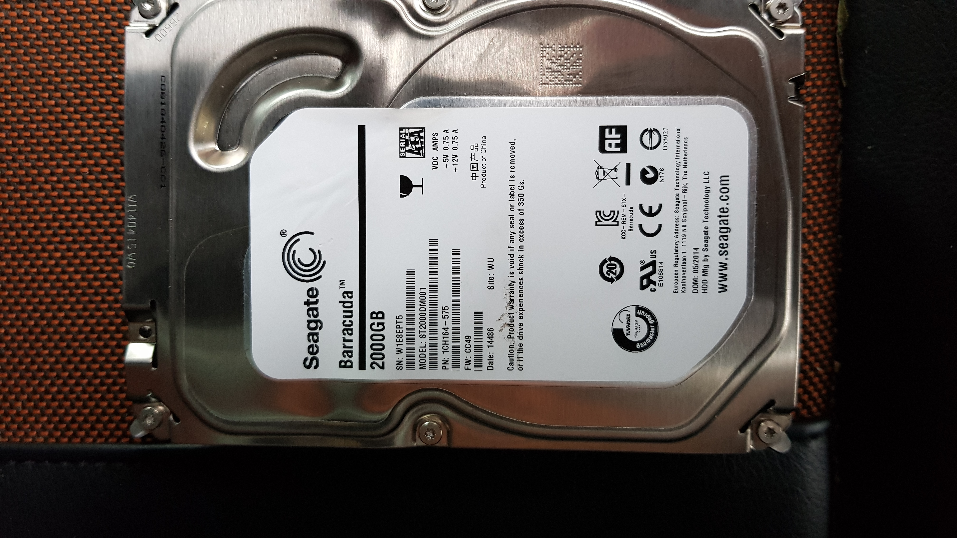

Please, post pics of the burnt pcb and the new pcb.
Also, pics of the drive label.

@Liquidic3, the drive should have spun up with the new PCB, albeit without access to your data. Therefore ISTM that your USB-SATA bridge PCB may be damaged as well. Can you upload a photo of the bridge PCB?
I have uploaded the post above yours with the images.
Here is the drive label

The simple solution should have been to snip the shorted 12V TVS diode and attach your drive directly to a SATA port on your computer's motherboard.
