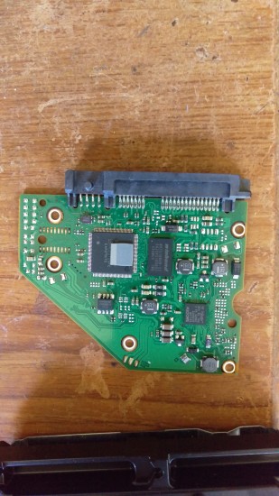

Thank you for reading my post.
As a newbie and possibly the oldest member here,i need help and advice.
having plugged my laptop power lead accidently into my Seagate external hdd i believe i have now have a dead HDD.
I managed to remove the drive from its casing and set it in place in my tower pc as a normal hdd.
i have done this before with a previous external drive with success.
as you probably figured,this time it did not work.
i am wondering if to try replacing the PCB? On the back of the drive itself,but unsure if this is the way to go.
If it is i am confused of the exact component to get,or indeed where from.
here is all the info i have
Seagate ST2000DM001
100724095
GTC18V-0?? C-1432=03-22 (Two digits i cannot read)
i am based in the UK England,so if its the last straw i will get it done by whoever you can recommend,but would very much like to try to fix it myself as a challenge.
thank you ...Fredrick

Im afraid its a bit more complicated than simply replacing the pcb... how technical are you?

In any case, search for @fzabkar's posts about TVS diode and associated zero-ohm resistors.

Do you have multimeter to check TVS diodes and zero ohm resistor continuity?
Can you show us a pic (high resolution) of you pcb?
Will do as soon as I can get hold of that star screwdriver and get it off the hard drive.
My friend has a multi meter,and will check.
I wont see him till sunday,so please bear with me all......thanks for all replies

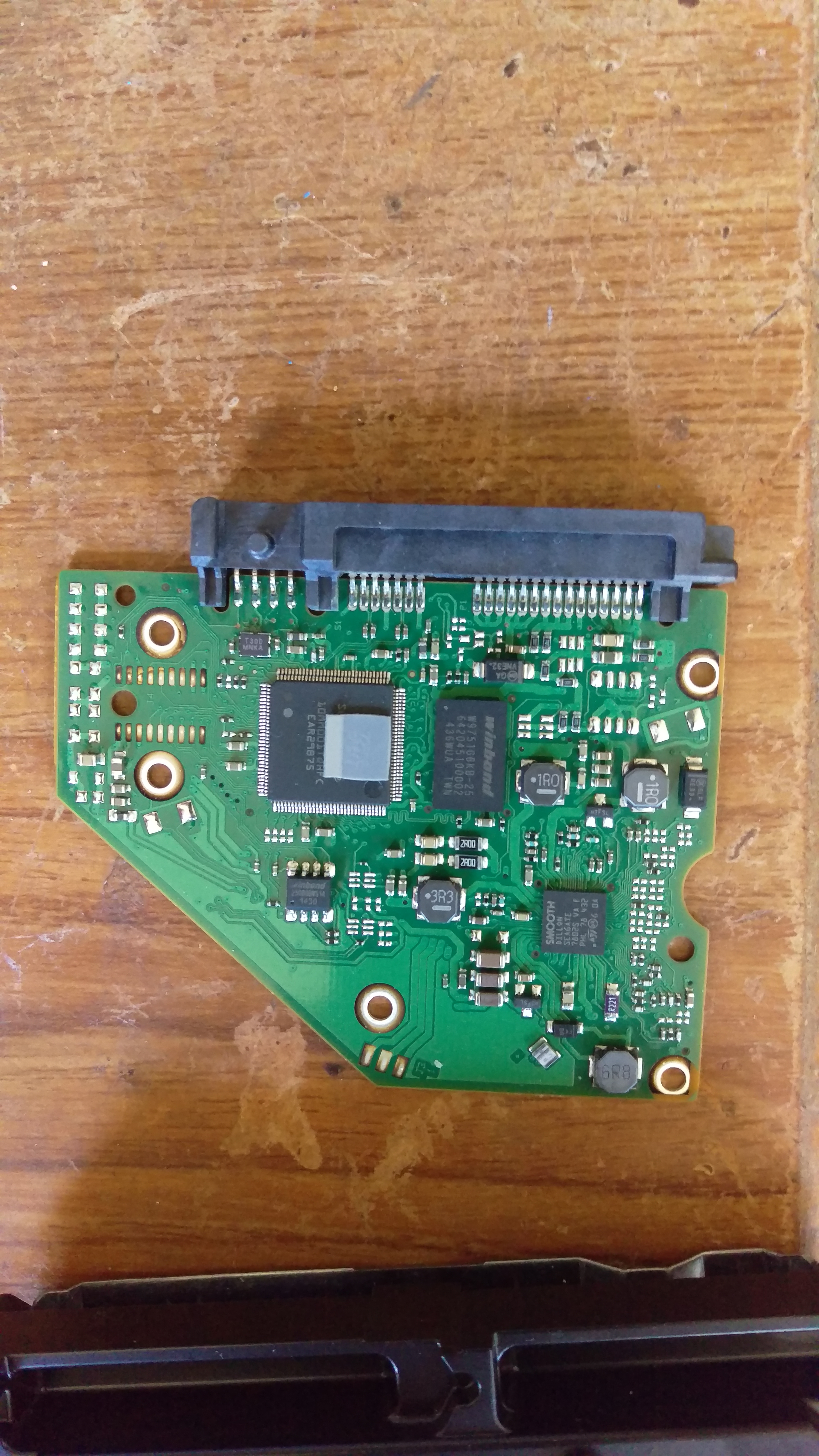

Here we go

How does the pc show it when connected via normal SATA ? Detects as something, or no detection at all ?
When fitted into my tower it shows nothing,no signs of life
I have another ex hdd that I did the same wrong power connection to (classic !!!)
but that did work in my tower once removed from its housing,but it was not a Seagate,i think that one was WD

Just an update.......
I sent the drive away to be repaired in the end.
Returned to me repaired,so I'm very happy.(no data lost)
Not sure if I am allowed to name companies,so please delete if needed.......
I used pcimage, up north.
Very helpful guys,good communication,and no hidden nasty surprises....recommended.
