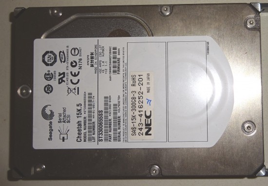

Dear HDDGuru Community,
many thanks in advance for this very good web community, I am here for ask your help about my hard drives.
I just bought a lot of Seagate Cheetah 15k.5 SAS ST3300655SS 300GB, but I have the same problem with all of them.
In Windows Disk Managment, I can't do initialization of any disks, when I try to create a partion it say me I/O Error or Disk not ready.(all disks the same error).
I can say that all disks are certified by NEC Vendor Company as showed by all disks.
I use a controller SAS Dell 6 I/R model UCS-61, I haven't problem with dell and HP certified hdd drives(but Still Seagate drive models)
I think it is a Controller SAS problem, that can't recognize any disks. So, I already tried to upgrade the firmware of my controller SAS, but anything is changed.
I tried also to install Dell Seagate firmware for model ST3300655SS, But it say me "System not compatible" (tested on Windows 7 and Windows Server 2003).
My pc is not a server or workstation, maybe this is the problem...I'm using a motherboard ABIT IX38 Quad GT with controller DELL.
I think is a problem of firmware disks, so my controller can't do initialization and create partion of any disks of this model ST3300655SS (Certified by NEC as said before).
What you can suggest to me? - I need a solution, I have many disks of this model.

They may be formatted to non standard bps can you post a photo of the label on one of the drives? Also, what model is your sas controller ?
Are you familiar with Linux?
This is the label of one disks, they are all identics.
As said before my controller DELL model UCS-61 SAS 6/ir, mounted on a classic motherboard Abit Quad IX38
Please help me , I have more than 100 disks to save!
 Post subject: Re: Need Help For Hard Drive Seagate Cheetah 15k.5 ST3300655
PostPosted: March 12th, 2018, 14:18
It could be just a sector size issue. Perhaps they are from a SAN running 520-byte sectors instead of 512. If so, you can likely re-format them to 512 using SG3_Utils and the sg_format command.
I'd check that before trying to change the FW version or anything like that.
Can you show me how to do this procedure?
This need to be done on Linux or Windows? Actually I have SAS controller driver only for Windows, but my controller can support also RedHat Linux(dell SAS 6 i/r)
I/O error on initialization can be resolved with sg3_utils?

Thanks for helping, but I'm very bad on Linux systems. So I just tried Windows Version of Sg3_utils. When I open Sg_format.exe
It give me a list of commands, but I don't see the list of the hard drives to format.
What is the procedure?
PostPosted: March 31st, 2018, 14:07
I've never attempted to use SG3_Utils for Windows, but if it's like other hard drive utilities, it probably can't do 90% of its functions in Windows.
Just boot the computer to some variant of Debian Linux, don't worry about drivers Linux will just work with the card. There a plenty of free live builds such as Knoppix, Sparky, Parrot, etc. that can be booted from a USB or DVD.
Connect the drive to a non-RAID SAS card (with extra emphasis on NON-RAID!!!).
Then do this in terminal:
sudo apt-get install lsscsi (this will install a tool to list the drives)
sudo apt-get install sg3-utils (this will install sg3-utils)
sudo lsscsi (this will list your drives)
sudo sg_format --format --size=512 /dev/sda (adjust the "/sda" part to what your SAS drive actually is)
Yes, windows can't do these commands! I just solved by CentOS Linux. Now one disk work!! Many many Thanks!!!
I will try with other disks, but I have to bought another cable for do it 4 disks at time(my card support max 4 disks). Procedure take 1 hour, in this way I can have 4 disks formatted in 1 hour.
How is the command for do it on multiple disks?
Which is the best smart utility for SAS? (I tried HDDScan and HDTune, but smart it's not complete as for SATA drives).
Many thanks! :D :D :D :D
