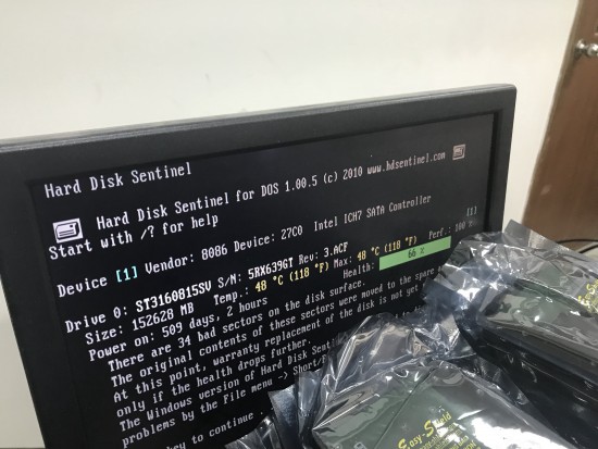

 Post subject: MHDD slow erase
PostPosted: March 14th, 2018, 7:07
Joined: February 26th, 2013, 6:58
Posts: 211
Hi everybody,
I tried a different motherboard in my PC and and I get extremely slow write speed in MHDD.
Also checked Data Lifeguard Diagnostics' full erase and from the remaining time shown I gather that the speed is normal, so the problem is encountered in MHDD only. Read scan (verify using F4) runs at normal speed. Erasing in Windows goes without speed issues either.
The motheboard has Intel G31 + ICH7 chipset. What do you think the problem is?
mhdd slow erase.jpg
mhdd slow erase.jpg [ 83.28 KiB | Viewed 17410 times ]
Those who know don’t talk. Those who talk don’t know.
 Post subject: Re: MHDD slow erase
PostPosted: March 14th, 2018, 8:31
Posts: 2857
I think coz its Green
those are really SLOW
If you are wiping, i suggest to use another tool and compare
 Post subject: Re: MHDD slow erase
PostPosted: March 14th, 2018, 11:04
Joined: February 26th, 2013, 6:58
Posts: 211
Thanks for your reply, but the solution was different.
It is really funny, but after I loaded optimized defaults, the issue got fixed. But which settings were incorrect is still a mystery.
Unfortunately MHDD, not being developed further, is getting more and more outdated. Lately I experimented with 2 new mobos, MHDD couldn't see the controller the hdd was attached to.
MHDD :rip:
Those who know don’t talk. Those who talk don’t know.
 Post subject: Re: MHDD slow erase
PostPosted: March 14th, 2018, 16:47
Joined: February 26th, 2013, 6:58
Posts: 211
Spildit wrote:
helpless wrote:
(...)Lately I experimented with 2 new mobos, MHDD couldn't see the controller the hdd was attached to.
MHDD :rip:
Try IDE/Compatible mode ...
Or buy PC-3000 !....
:down:
Spildit, you keep posting things, that don't help me at all. If it wouldn't be too much of a bother (I bet it would), could you stay away from my topics?
spildit banned.png
spildit banned.png [ 16.55 KiB | Viewed 17348 times ]
Those who know don’t talk. Those who talk don’t know.
 Post subject: Re: MHDD slow erase
PostPosted: March 29th, 2018, 12:53
Joined: March 15th, 2018, 3:56
Posts: 10
Location: Singapore
Hi
Can MHDD remove bad sector?
 Post subject: Re: MHDD slow erase
PostPosted: March 29th, 2018, 15:13
Joined: March 15th, 2018, 3:56
Posts: 10
Location: Singapore
Spildit wrote:
MKONJKAV wrote:
Hi
Can MHDD remove bad sector?
Remap yes, Remove no.
you mean PC3000 doing the remaping not repairing since that is software as well?
 Post subject: Re: MHDD slow erase
PostPosted: March 29th, 2018, 16:01
Joined: March 15th, 2018, 3:56
Posts: 10
Location: Singapore
Spildit wrote:
MKONJKAV wrote:
Spildit wrote:
MKONJKAV wrote:
Hi
Can MHDD remove bad sector?
Remap yes, Remove no.
you mean PC3000 doing the remaping not repairing since that is software as well?
Translator, Defect Lists and Bad Sectors :
If the drive have just a few bad sectors you can re-map them (swap by spares) by adding those sectors to G-List.
If the drive have huge amount of bad sectors ..... nothing to do. Well, you can still self-scan the drive, run ARCO, run BURN, etc .... depending on the drive but .... it will get some extra life out of the dying drive and it will die anyway so trash it and buy new drive.
Thanks for details,
I have 20,000pcs and will use in game consul (not in pc) but still must be pass Sentinel software,
I used Blanco to remap the sector and it show all pass and good,but when i test with Seitial software show low health and bad sector.
File comment: After the test with BlNCCO.
160GB-BAD SECTOR.jpg
160GB-BAD SECTOR.jpg [ 1.79 MiB | Viewed 16945 times ]
160GB-Blancco.jpg [ 300.97 KiB | Viewed 16945 times ]
Users browsing this forum: Google [Bot] and 18 guests
