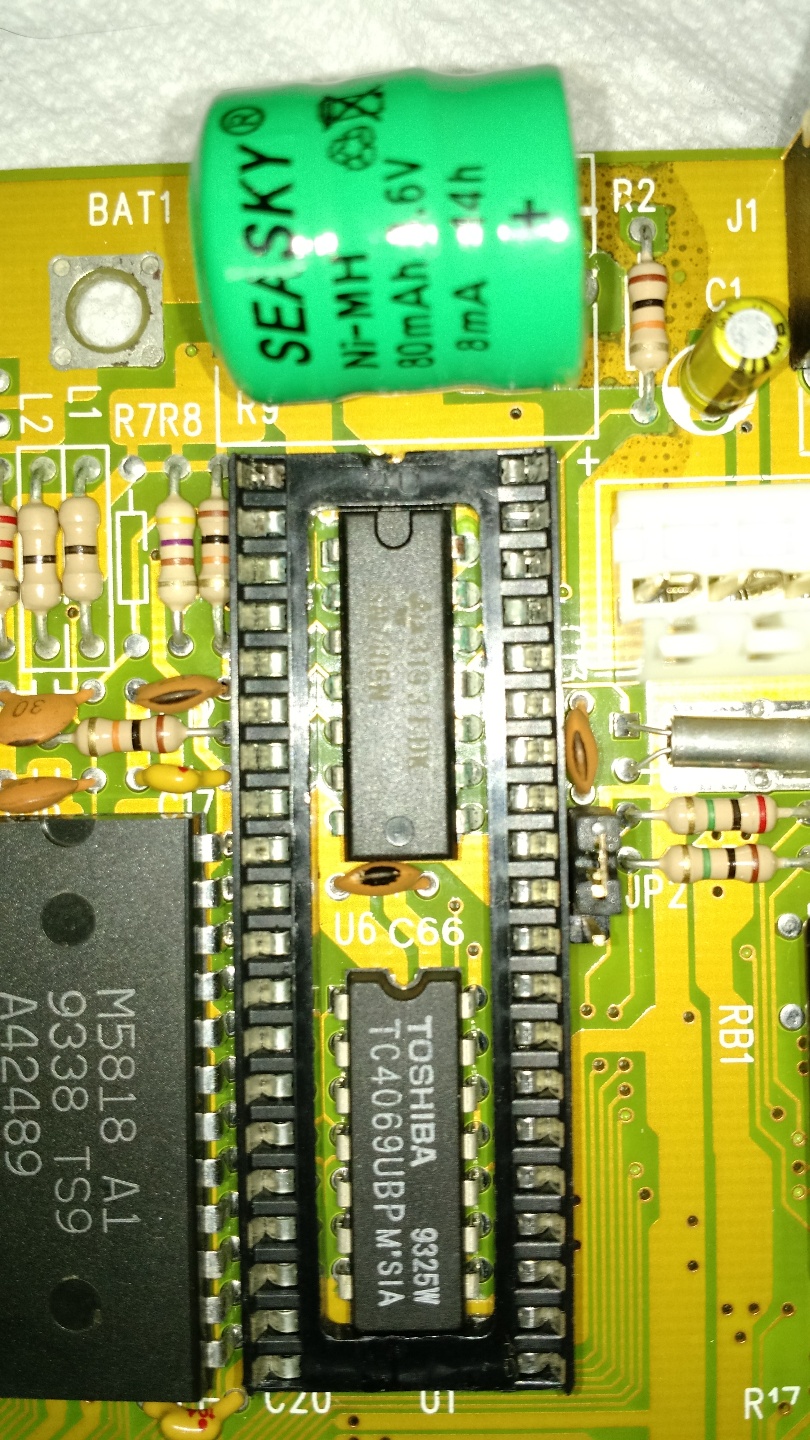

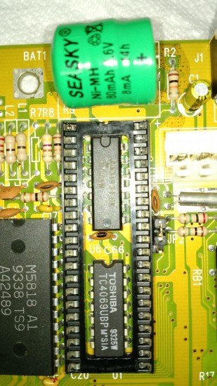

In my attempt to reseat the 6042 IC, I ended up getting it totally loose, and here is a picture of the socket under.
I am not sure about this, but I have an idea that it is pin 39 we are talking about. The socket is a 40 pin socket, and on the right side, not the top one in the picture, number two down from the top. The spring tab on the outside is there, but on the inside it is pushed down all the way to the bottom of the socket.
Bill

Pin 39 is "TEST 1":
http://pdf.datasheetcatalog.com/datasheet_pdf/intel/8041AH_to_8742AH.pdf
Test 0 and TEST 1 are wired to Keyboard Data and Keyboard Clock (in the original IBM PC-AT).
http://www.users.on.net/~fzabkar/PC-AT/at-17of22.JPG
If the keyboard works, then I don't think it matters.

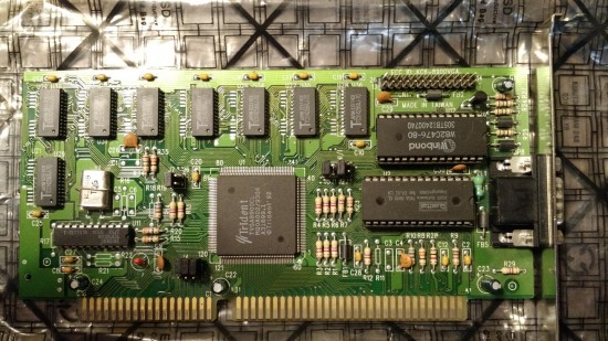

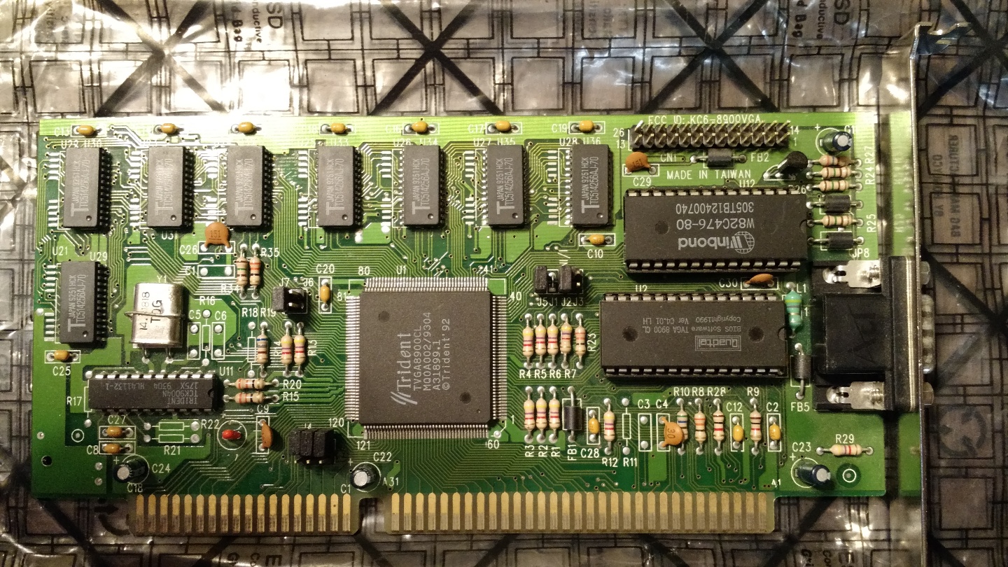

Hello again, sorry this took so long time. I have bought a new (old) motherboard, a new (old) Video card, and brand new multi IO card. Today I put it together. Beep Beep Beep from the speaker, and nothing on the monitor. The monitor say no signal. So, I took my old Video card, and used that. And oh dear, you are not going to believe this, but the computer does not write 1 on bit 14, just like the old one. Everything identical.
I don't know if I shall laugh, or cry, or if there are some other emotional reactions I have never heard about I can use.
It must be the old video card that cause bit 14 to go low. But, there are no shortening between bit 14 and ground on neither the motherboard, nor the multi io card, nor the video card. So, it must be something that happens when it is powered up, and therefor impossible to find with a ohm meter.
The sad thing is that I have no idea how the new video card I bought is set up. It has some jumpers, but I am not able to find any info about this card online.

Good old Trident ....
Anything written in the back of the card ? There used to be manuals for this stuff, but I believe I let go of those a long time ago.
Without the SuperIO card, only with the new vga card, does any of your boards boot ?
( preferrably both )

I have a "VGA 8900C" user manual, but its jumper layout differs greatly (Asia Data, DSC-010C).
The jumpers at J4 could be selecting one of the "16-bit" IRQ pins (D3, D4, D5). A continuity check with a multimeter should confirm this. If correct, then ISTM that no IRQ is currently selected. I would also check where IRQ2 (pin B4, redirected to IRQ9) goes. My manual provides a jumper for disabling/enabling IRQ9 (= IRQ2).
It doesn't help, but here is the FCC filing for your card:
https://fccid.io/KC6-8900VGA

With the new Video card, I hear Beep beep beep, the monitor is totally black, no video signal, so I can not tell how far it goes. So, the first I did was to remove the io card, to just see if something came up. I wondered if there was a conflict between the video and io card. But, still black monitor.
Then I used the old video card, alone, so only the motherboard and the video card, and it came up and I could access bios, and change the date and clock, and that was pretty much it.
I have found some information about a similar video card, and there is something about interleave, and a frequency, and some of them seems to have some setting for 8 bit or 16 bit motherboards, but since I can not find any information about this particular card, I am not sure of anything. It is written with a marker pen on the back of the card.... Good Well, it looks good, but looks and works is two different things.
On the back side it says, GC318 -PT4855 S/N:A1809-032, and on the warranty label it says: SN: 82313432 A
Jumper 4 is open on all 3 switches. What does ISTM mean ?
