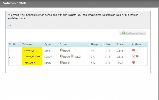

 Post subject: Seagate Business Storage 4-Bay
PostPosted: July 24th, 2019, 8:37
Joined: March 25th, 2019, 16:17
Posts: 40
Location: Hollywoo
Hi gurus, I have Seagate Nas server with 4X 4TB, looking for deleted files, I got the image of the disks. Even Nas server can be reconfigured after deleting files, nobody knows. What are the default settings for these models?
I want to look at using r-strudio or UFS, but I'm a little confused about raid parameters. Is the following method "Span of storages JBOD with spanning"sufficient with UFS? any advice would work.
Respects
04.jpg [ 62.4 KiB | Viewed 4514 times ]
 Post subject: Re: Seagate Business Storage 4-Bay
PostPosted: July 25th, 2019, 3:53
Posts: 1091
Location: Angel Data Recovery
Storage_C and Storage_D volumes located on alone drives, Main_storage volume located on mirrored HDD4 and HDD2.
And if it was NAS, each drive contain mirrored Linux FileSystem at teh beginning. Actual volumes with data, located also on linux partition but with offset.
And there is a big chance, it was LVM created array.
Angel Data Recovery
 Post subject: Re: Seagate Business Storage 4-Bay
PostPosted: July 30th, 2019, 9:51
Joined: March 25th, 2019, 16:17
Posts: 40
Location: Hollywoo
DR-Kiev, very descriptive and helpful. Thanks for reply.
Users browsing this forum: Google [Bot] and 308 guests
