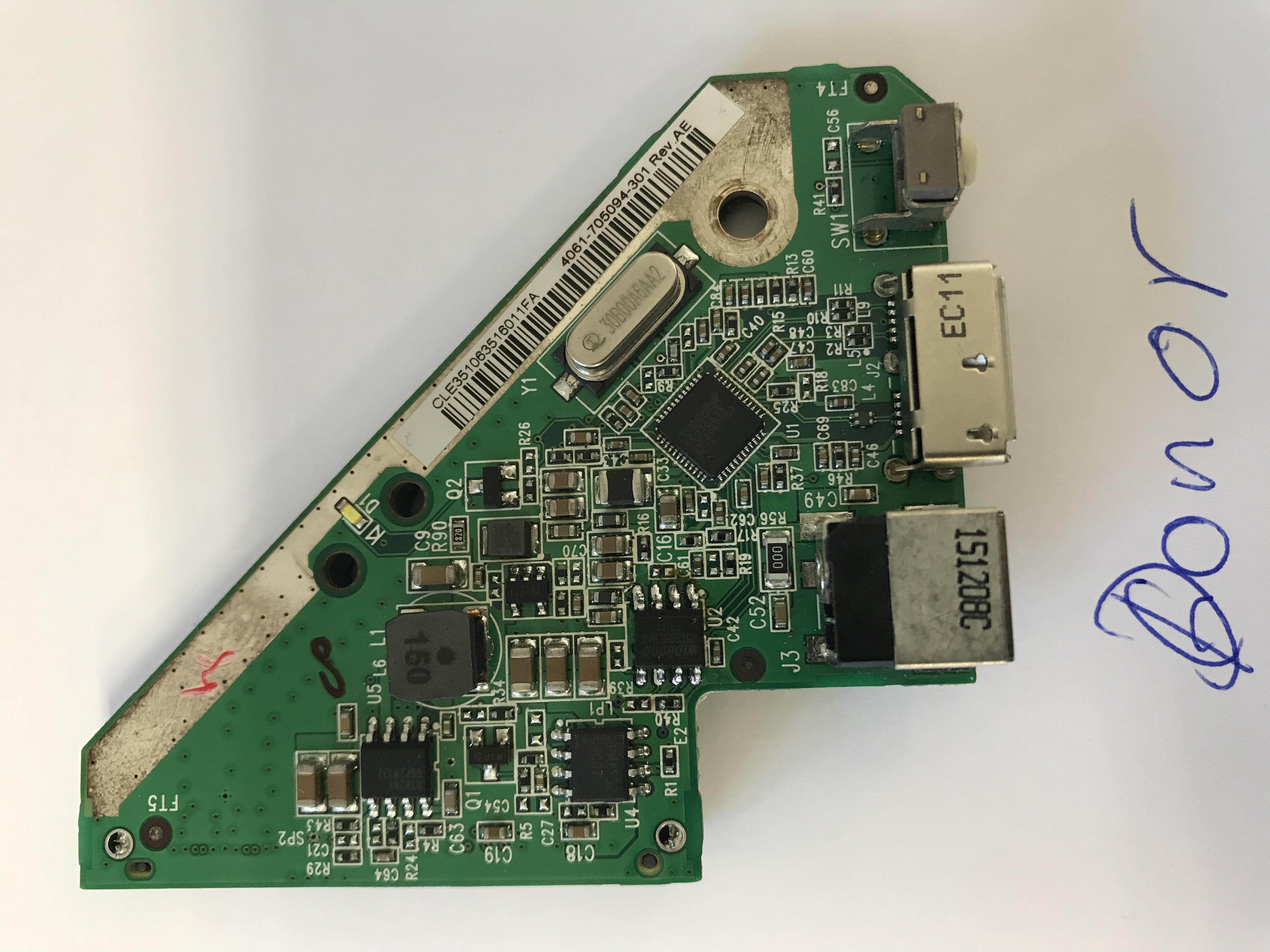

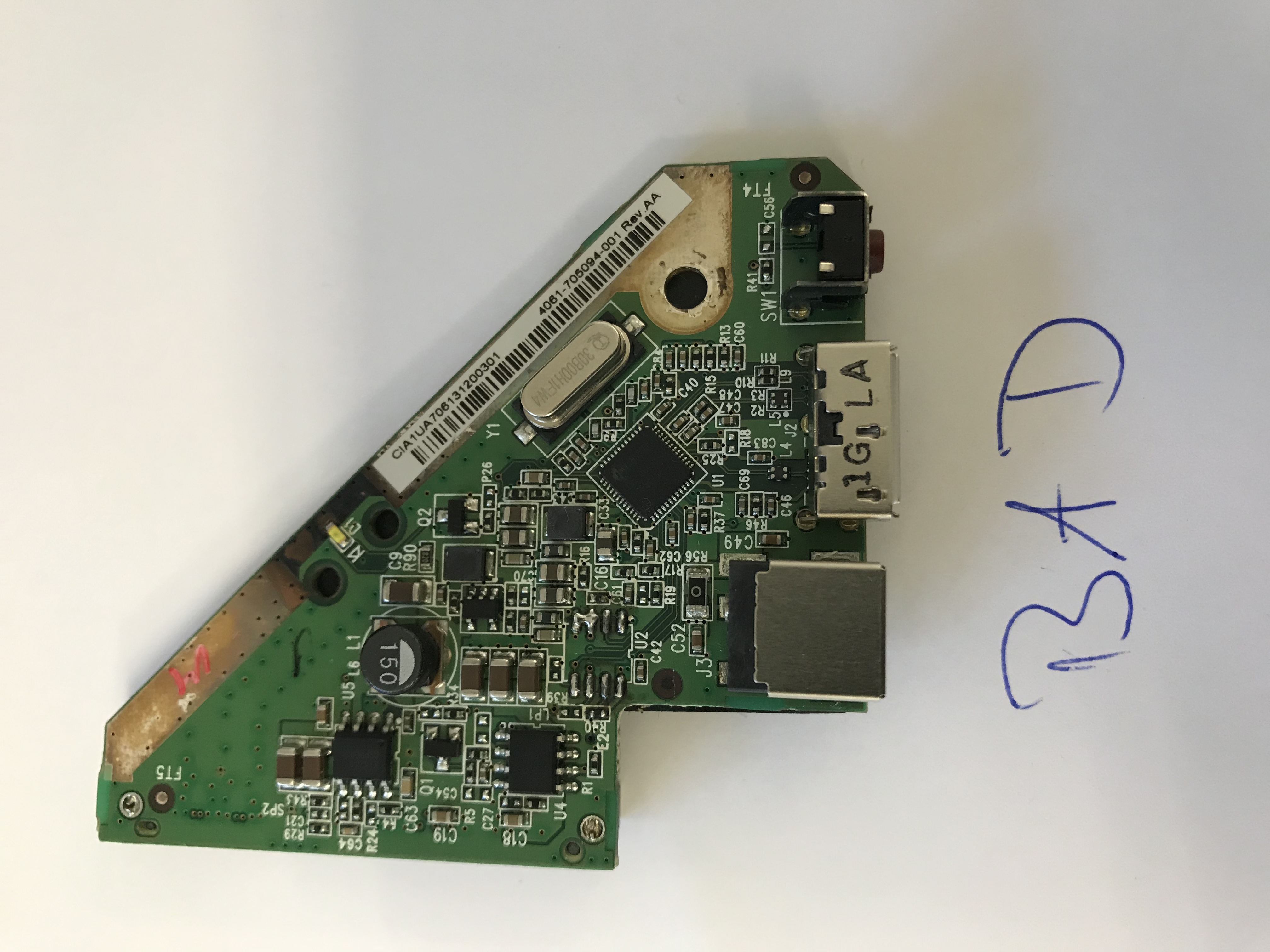

i cant see if the Board is an oxford Bridgeboard.
Here are the Pics of both.
 Post subject: Re: How to recover WD Mybook Harddisk
PostPosted: August 31st, 2019, 17:09
Posts: 17328
It looks like an Asmedia ASM1051W. ISTR that this chip decodes in the same way as a JMicron JMS538S. :?

DR-Kiev wrote:
Asmedia doesnt do encryption,
AFAICT, the Asmedia ASM1051W bridge is pin compatible with the JMS538S. So the JMicron bridge does encryption, but the Asmedia does not?
Yes, exactly. And if you take more careful look to those poor quality pictures, you will find that donor PCB is JMicron based (top left logo) and patient PCB is Asmedia based (which doesn't do encryption/decryption) , that is why topic-starter was unable to decrypt the data with different bridge controller :))

@Dr-Kiev
Was this storage used under MAC ?
No
Why are there 2 different types of chips. -> Ive seen it now. One it Jmicron (bad PCB) and the other one is asmedia (good pcb)
I thought, that the number 4060-705094-001 is the right. its the same on the downside of the boards.
best regards
Fabian
PostPosted: September 2nd, 2019, 9:39
Posts: 1748
So, your drive is encrypted with Jmicron.
IMO, you have two options, one if you have a proper tool like (PC3K, MRT...etc) you will be able to decrypt the drive. Option two is to seek for a fully matched (bridgeboard) with matched Jmicron based.
Good luck

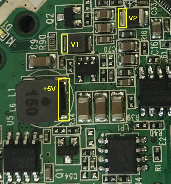

Western Digital My Book Essential bridge PCB, 4061-705094:
PostPosted: September 9th, 2019, 5:38
Posts: 17328
I would start by measuring V1, V2 and +5V.
PostPosted: September 10th, 2019, 10:12
Joined: April 3rd, 2015, 4:26
Posts: 60
Location: Germany
+5v = 4,98 V
V1 = 11,95 V
V2 = 11,30 V
PostPosted: September 10th, 2019, 16:24
Posts: 17328
If you really are measuring 11V and 12V, then there is something seriously wrong with the PCB or your measurement technique. I would have expected to see 3.3V and 1.2V.
PostPosted: September 13th, 2019, 4:16
Posts: 60
Location: Germany
I used a new one now
+5v = 4,98 V
V1 = 0,781 V
V2 = 0,06 V
The PCB is getting very hot. ?!
