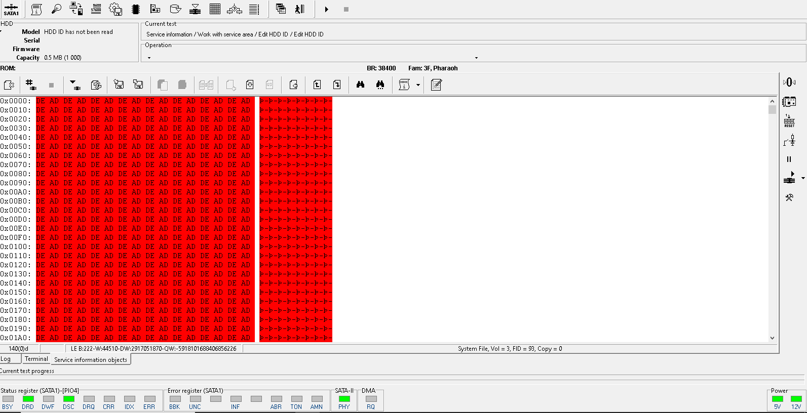

I am trying to access Seagate 7200.12 disk which is staying busy and giving LED error.
MDL - ST3320418AS
FW:- HP11
I have cleared SMP flags and tried to edit sysfile 93. Despite all efforts LED message is not going.
I have given up now and returning disk as non recoverable.
I am sure someone seagate expert from forum might shade light on something which I am missing compltely.
If required I can give remote access as well.

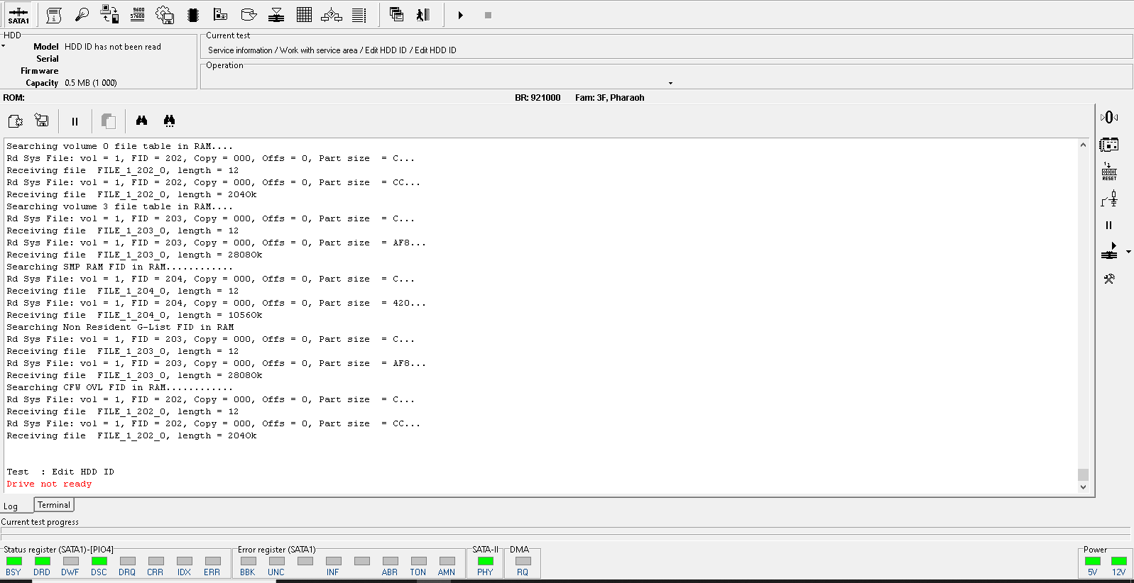

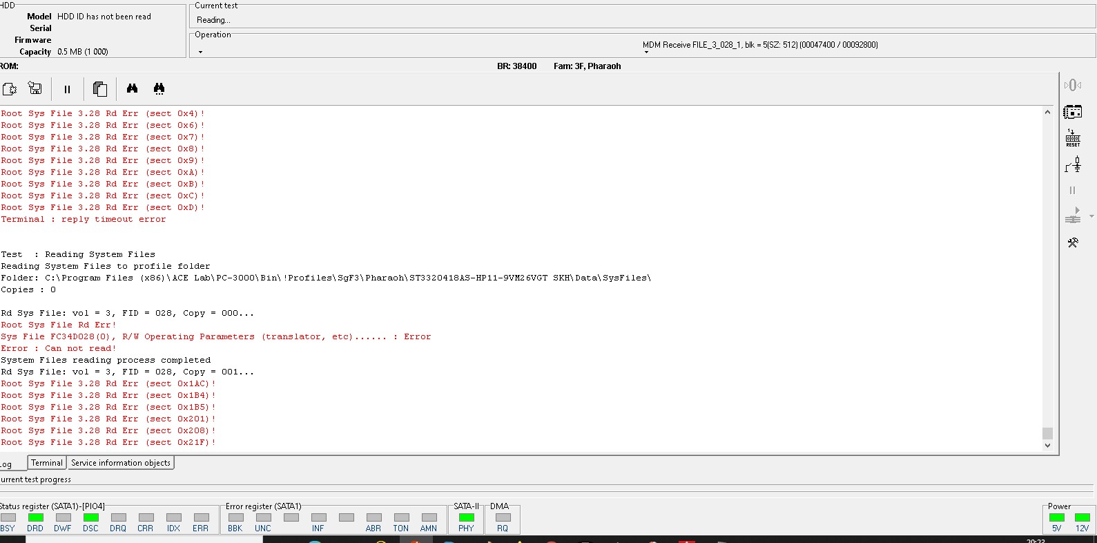

thanks all of you.
Now LED error has gone. Some of the observations are --
1) After 1~2 minutes drive gives DRD DSC
2) While system file 93 can be read , system file 28 using head 0 cant get read a all using head 1 it can be read partially but is not loaded.
3) There is ROM checksum error --
SEA-3 Yeti Boot ROM 2.0 (12/06/2007)
Copyright Seagate 2007
Serial FLASH boot code checksum failure!
Boot Cmds:
DS
AP <addr>
WT <data>
RD
GO
TE
BR <divisor>
BT
WW
RET
Rst 0x10MBogus ISR
CPSR = 0xA00000D7
R14 = 0x00100A80
I think this could be ROM + SA issue.

Selected family......................... : 3F, Pharaoh
Model by ID............................. : <HDD ID NOT READ>
Loading default settings!
Use the options dialog to review and save utility settings.
Then press OK!
Family default settings loading!
Tech Key...
HDD Redynes timeout (10000)
Detecting SA Phys Sct Size...
Result.................................. : 512
Rd Sys File: vol = A, FID = 32A, Copy = 000...
Receiving file FILE_A_32A_0, length = 524288
Parsing container segment....... Flash ROM image
Segment: CFW
Parsing segment....... CFW
End parsing segment... CFW
Segment: CAP
Parsing segment....... CAP
End parsing segment... CAP
Segment: RAP
Parsing segment....... RAP
End parsing segment... RAP
Segment: SFW
Parsing segment....... SFW
End parsing segment... SFW
Segment: SHELL
Parsing segment....... SHELL
End parsing segment... SHELL
Segment: SAP
Parsing segment....... SAP
End parsing segment... SAP
Segment: IAP
Parsing segment....... IAP
End parsing segment... IAP
End parsing container segment... Flash ROM image
Buff Root FAT searching in RAM......... Ok
Searching module table in RAM... ....... Ok
Searching DT table(RAM, WR) in RAM...... Ok
Searching DT table(RAM, RD) in RAM...... Ok
Searching volume 0 file table in RAM....
Rd Sys File: vol = 1, FID = 202, Copy = 000, Offs = 0, Part size = C...
Receiving file FILE_1_202_0, length = 12
Rd Sys File: vol = 1, FID = 202, Copy = 000, Offs = 0, Part size = CC...
Receiving file FILE_1_202_0, length = 204Ok
Searching volume 3 file table in RAM....
Rd Sys File: vol = 1, FID = 203, Copy = 000, Offs = 0, Part size = C...
Receiving file FILE_1_203_0, length = 12
Rd Sys File: vol = 1, FID = 203, Copy = 000, Offs = 0, Part size = AF8...
Receiving file FILE_1_203_0, length = 2808Ok
Searching SMP RAM FID in RAM............
Rd Sys File: vol = 1, FID = 204, Copy = 000, Offs = 0, Part size = C...
Receiving file FILE_1_204_0, length = 12
Rd Sys File: vol = 1, FID = 204, Copy = 000, Offs = 0, Part size = 420...
Receiving file FILE_1_204_0, length = 1056Ok
Searching Non Resident G-List FID in RAM
Searching CFW OVL FID in RAM............
________________________________________________________________________________________________________________
Test : Tech Mode unlocking preparation, (patch)
Switching HDD power supply OFF
Switching HDD power supply ON
ROM Type: 0x00(STM)
ROM Size: 0x80000
Saving ROM to profile folder
File : C:\Program Files (x86)\ACE Lab\PC-3000\Bin\!Profiles\SgF3\Pharaoh\\Data\ROM\ROM_9VM26VGT_3C150682.bin
Warning! Segment header check sum is not zero: 0E46D686
Segment: CFW
Warning! Segment whole-space check sum is not zero: 00000C1A
Warning! Segment used space check sum is not zero: 00000793
Segment: CAP
Segment: RAP
Warning! Segment whole-space check sum is not zero: 0000034E
Warning! Segment used space check sum is not zero: 00004E9F
Segment: SFW
Warning! Segment whole-space check sum is not zero: 000090CB
Warning! Segment used space check sum is not zero: 000003DC
Segment: SHELL
Segment: SAP
Warning! Segment whole-space check sum is not zero: 00001D09
Warning! Segment used space check sum is not zero: 0000AFD1
Segment: IAP
No editing objects are found!

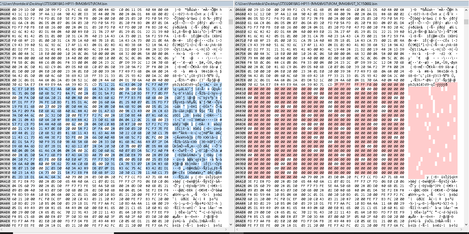

Read the ROM a few more times and perhaps off board are the readings consistent.
 Post subject: Re: 7200.12 LED error
PostPosted: June 24th, 2021, 6:37
Joined: June 5th, 2006, 1:09
Posts: 93
Location: INDIA
Yes Lardam you are right , even If I copy ROM using same pc3000 twice both readings are different.
Here are both ROM copies and other system files.
