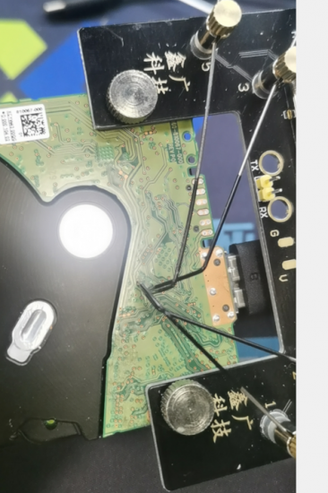

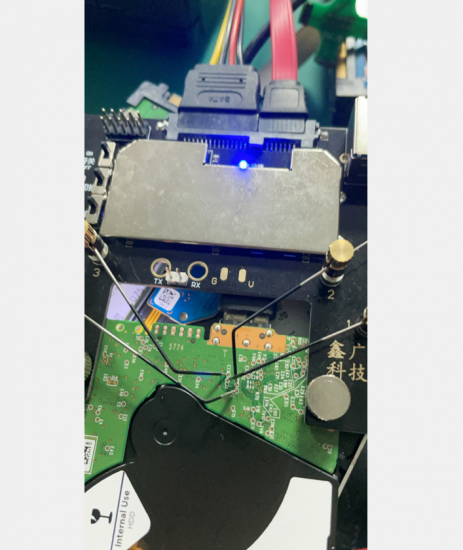

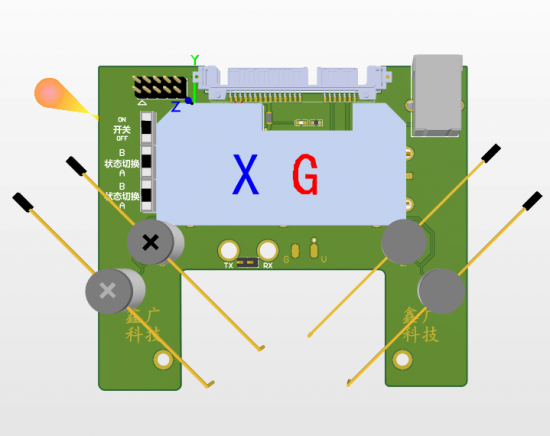

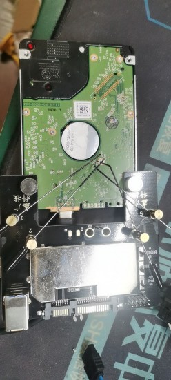

 Post subject: USB hard disk retrofitting SATA device
PostPosted: September 18th, 2022, 7:37
Joined: August 29th, 2021, 5:46
Posts: 47
Location: China
I 'm sorry! The last post can't be edited. I don't know much about freight and taxes. There are also some test usage conditions that were not explained clearly in the last post, so I reopened this post
USB hard disk retrofitting SATA device
1.png [ 65.09 KiB | Viewed 12062 times ]
2.png [ 99.61 KiB | Viewed 12062 times ]
86.jpg [ 257.9 KiB | Viewed 12062 times ]
673.png [ 587.76 KiB | Viewed 12062 times ]
810033.png [ 598.01 KiB | Viewed 12062 times ]
810067.png [ 484.62 KiB | Viewed 12062 times ]
Advantages of this board
1.No soldering, no PCB damage(Many of the actual tests do not need to remove the isolation capacitor.)
2.At least only 4 needles need to be placed (SATA signal) The USB hard disk is powered by a direct USB cable
3.The board has its own locking screw
4.ntegrated functions of pc3000 USB mirror
5.It is not limited to WD USB HDD, but also supports all future SATA protocols such as Toshiba, Samsung, etc
I have tested Toshiba, Samsung, Western Digital and other USB drives, and have also demonstrated their use!
Personally, I mainly use the PC3000 of ACE, so the test is basically based on PROTABLE3
You can visit the website to view 了 https://space.bilibili.com/2132638644
Now it only needs 90 USD, the promotion discount period is less than half of the normal price,The price will be increased from the 21st! If you need, please do not miss the discount period.
I don't know much about transportation and taxes, and I'm studying. However, for those who are willing to purchase, I will keep the consulting price unchanged, which is subject to the consulting email and my reply.
My mai:2169571@qq.com
3.png [ 445.35 KiB | Viewed 12062 times ]
My Website: https://xgfix.com
SKYPE: soo558
