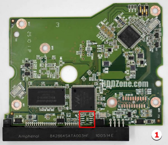

to the very inexperienced with data recovery ear, this ticking sounded like a head problem and that's what youtube suggested a year ago with a minimal search.
Hard drive got stored aside, couple of months later i looked up the donor hard drive and then i studied on how to do a head change operation.
More months went by for me to build the confidence to do it and read as much as i can about it.
Some sources said it was possible if some clean room was achieved and that's what i did and it is now done but the harddrive would not allow the PC to POST so i started worrying about the board.
I had concluded it was the head because i remember hitting the drive with my chair as i had it lying on the floor at some point but anyway it turns out that this was the one drive of my 15 year experience with SATA that i had inserted (earlier) the SATA power cable backwards and broke the tab.

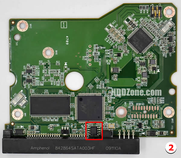

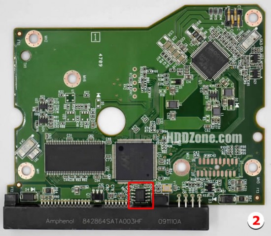

This led me to consider the possibility of having it being plugged backwards by accident at some point later (without realizing it) because now with the tab broken, this is possible to do and being a bit busy with dealing with fires and data transfers, maybe i did.
Swapped board with the identical donor, the hard drive is perfectly recognized by BIOS as the drive that it is but as you professionals know already, now the data/info of the previous drive need to be transferred to the new board.

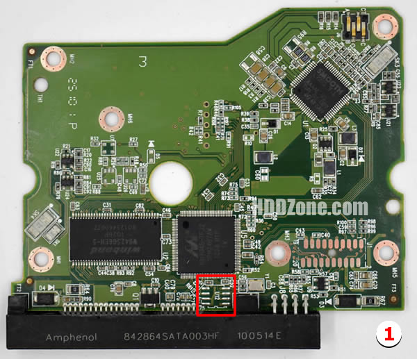

Here's where the problem gets challenging... the hard drive has no BIOS (8 pin) chip i can retract data from.
So my options are a)to transfer the IC chip as it is and i have seen that working on some cases (internet/youtube) or b)diagnose the board and replace problematic parts from the donor board which is, i believe, trickier than soldering tiny contacts, because the new component might blow again if the problem is elsewhere, leaving me with two useless boards.
So, thinking of (a) :
My soldering skills are not for that level but i think i can pull it off with the right equipment but i decided to call some pro around where i live (Greece) who can remove a chip and add it to another board more confidently than i can and he started telling me that because it's for a hard drive they usually charge thousands for data recovery etc. and i explained to him that i don't bring data to him but only a chip and he didn't call back so here comes my ego again, saying i don't need him, but i need a stable base, a k-tip to my solder iron (solder station: YH-836 with air already exists) and a magnifier for those OH GOD HOW TINY THEY ARE contacts!
Are the chances of succeeding in this too minimal to try?
Is there a way to transfer the cylinder/sector data from the chip even through (logically priced) paid software instead?
Even if i manage to pull this off, will i encounter encryption problems or things like that that i read around the forum?
The harddrive is a WD Gold internal 3.5" (WD2002FYPS-01U1B0)
Not inserting a link or image of the board because of reading about some delays in posting if links exist,
but you can look it up to see the missing BIOS chip but the contacts there from its predecessor design (i guess)
They are up top under the connectors.

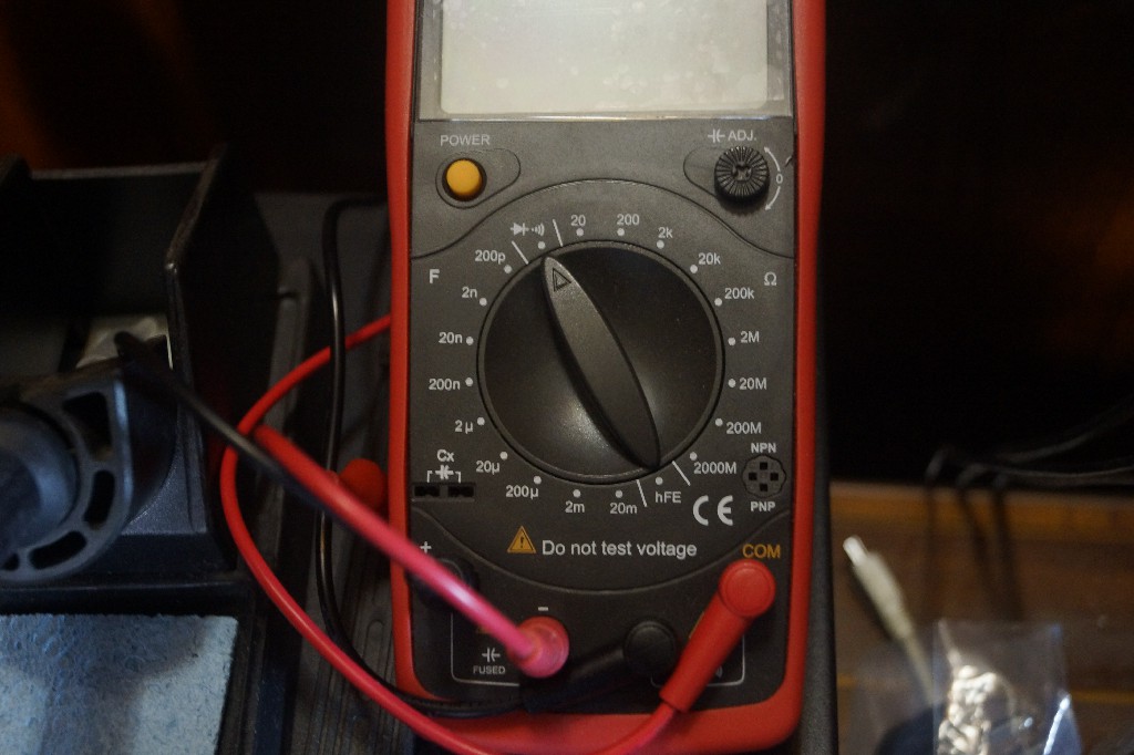

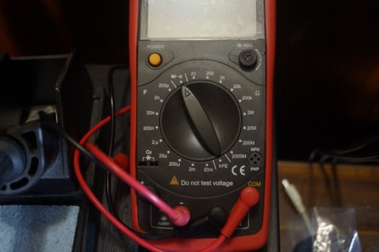

Concerning the board, i checked it's two main diodes and their voltages seem alright, so i guess it wasn't a backwards power that did this because those would have blown out first (i suspect).
In case you are suggesting road (b), you should know that my board diagnosis skills are at such a level that i decide to solder tiny contacts instead! :|

it needs a man to read all this :P
i see a couple of contradictions:
- you talk about a 18TB drive while later mention WD2002FYPS-01U1B0, which is 2TB, can be shown as 1.8, so isn't a decimal dot missing somewhere?
- WD gold 18TB is He filled, i highly doubt you would ever be able to achieve a successful head transplant on such thing, not to mention the need to interact with frimware.
771642 board does not have external rom, it is internal to the MCU, but can be read and written with appropriate tools.
You can't damage the board by plugging power connector in reverse due to the missing alignment tab, because the connector has no contacts on the other side. The only way you could damage it is to plug it misaligned, but that's also very hard, if not impossible due to the housing of the connector.
The thing is bleeding from several wounds now, I don't think there would be many enthusiasts willing to hold your hand through this process, it is simply because it takes shitload of time to assist remotely in such situation, i would probably recover this drive several times before we get anywhere remotely. Yes, this costs some bucks but...
There are a lot of posts of fzabkar about how to do basic diag on PCBs, you may find them useful, but i am not even sure the problem is in the PCB, might be h.
You mentioned nowhere if the drive spins up at all, does it?
Now that's something i could look into, if it doesn't require those WD proprietary tools to do it. Even if it does, it's a valid option to try that first before desoldering.

if it is spinning, very low chance the problem has anything to do with the board.
more probably firmware or heads.

Just a guess, but there is a rather large empty header which is probably used for JTAG. Somewhere on this board someone reverse engineered the pinout but I don't know if it is the same for each vendor/board. Maybe you can dump relevant data through the header and flash it to the new chip. It maybe wouldn't even require soldering to connect to the right JTAG pins.
Thank you!
looking into your tip and the first options i see include raspberries which is great to see!
update: Someone capable of chip transferring has appeared (minimizing the risk of failure if i were to do it)
but i am definitely shooting for the JTAG options first if it's possible because those pins are there indeed.

Still, this is route (2) (diagnosing the old board) which is much harder to me and i am afraid it is risky to replace a component because if it fails again then i will lose the donor board too (missing component)
Two board types with this serial # , option 1 is ours, the one lacking the BIOS chip (bottom pic) (lucky me!)
File comment: Type 2 board includes the BIOS but it is not the one we have!
File comment: Type 1: No BIOS chip
(this is the one we're talking about)

portable multimeter i have here has no voltage measuring capabilities
:shock: :shock: :shock: :shock:
never seen such thing, apart from an LCR meter i too have :)
I know right? There's a first for everything!
I can tell you one thing for sure, this aspect wasn't advertised much (or at all) at the website i got it from
