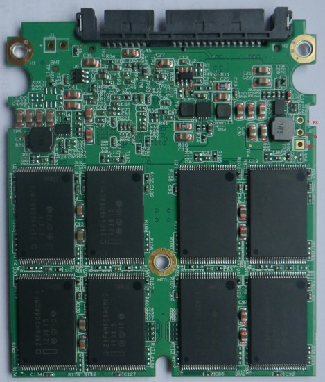

 Post subject: ADATA S510 120 GB - No Life Signal
PostPosted: October 21st, 2023, 10:30
Joined: September 13th, 2023, 5:53
Posts: 90
Hi all
i have a ADATA S510 120 GB
Windows and Linux systems do not detect this disk, nor the BIOS
I made preliminary measurements, they are as follows
P1090220-pomiary.jpg [ 1.64 MiB | Viewed 6553 times ]
Can i try comunicate with this SSD via serial (3.3v) ? for example, putty program ?
what will be the correct bitrate 11520 ?
I want to recover my data
 Post subject: Re: ADATA S510 120 GB - No Life Signal
PostPosted: October 22nd, 2023, 5:05
Joined: September 13th, 2023, 5:53
Posts: 90
on USB-UART FTDI FT232RL Waveshare 6170 and 5v
putty 11520
i see this
Zrzut ekranu 2023-10-22 105803.png
Zrzut ekranu 2023-10-22 105803.png [ 37.22 KiB | Viewed 6453 times ]
wrong voltage or bitrate ?
 Post subject: Re: ADATA S510 120 GB - No Life Signal
PostPosted: October 23rd, 2023, 4:48
Joined: September 13th, 2023, 5:53
Posts: 90
ok so im read more about this
I learned on this forum that Sandforce SF-2281 is hard to read data
now i think is my output form pytty is normal
can i comunicate with this SSD via putty ? for diagnosis?
what about the to THT hole on top left ? can i change dsik running method?
what about decryption keys in case of firmware updates?
 Post subject: Re: ADATA S510 120 GB - No Life Signal
PostPosted: October 26th, 2023, 11:24
Joined: September 13th, 2023, 5:53
Posts: 90
ok, I shorted the two THT hole on top of PCB
can i diagnose this SSD in this state ?
Zrzut ekranu 2023-10-26 171955.png
Zrzut ekranu 2023-10-26 171955.png [ 44.79 KiB | Viewed 6066 times ]
Users browsing this forum: No registered users and 134 guests
