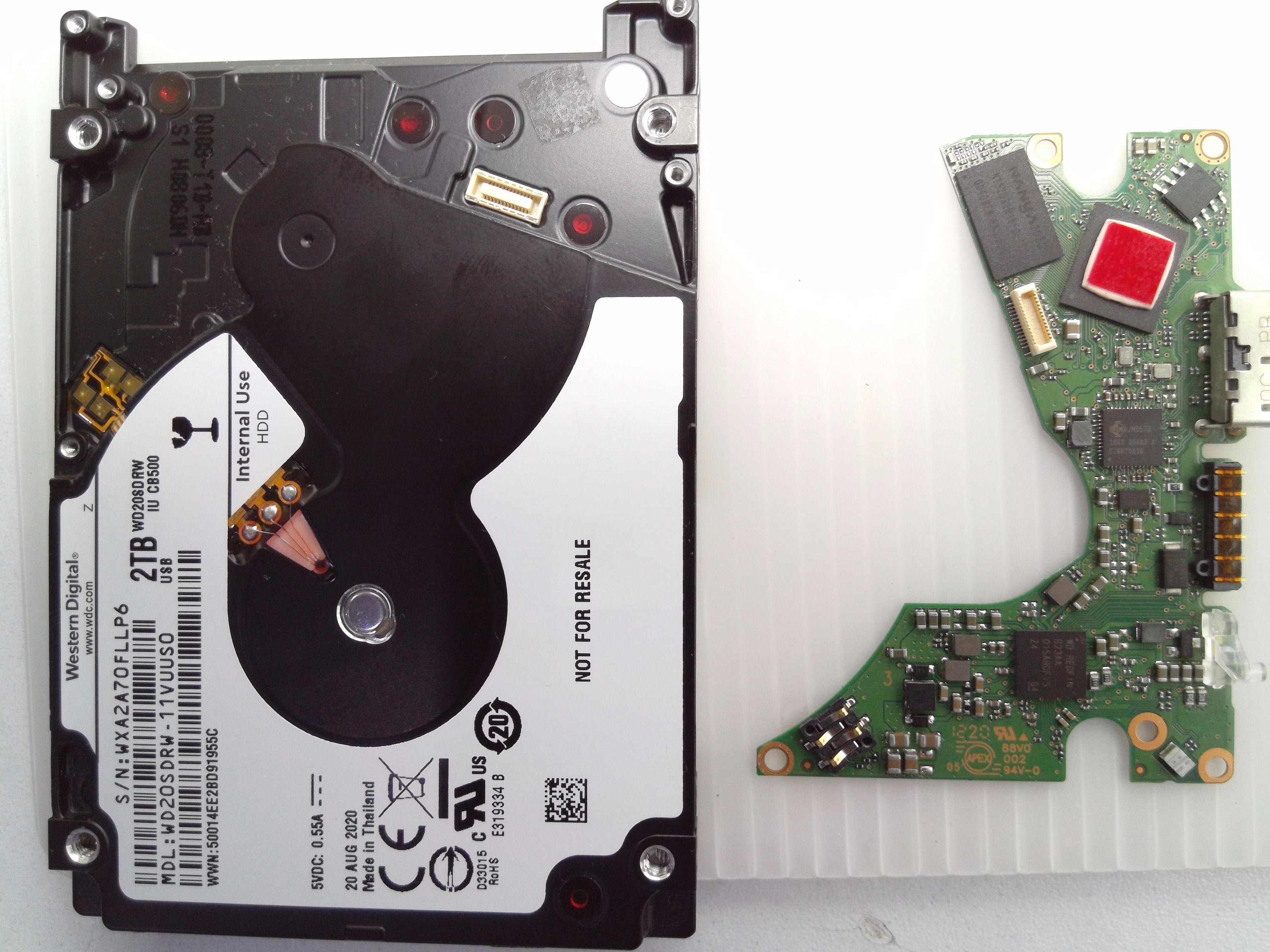

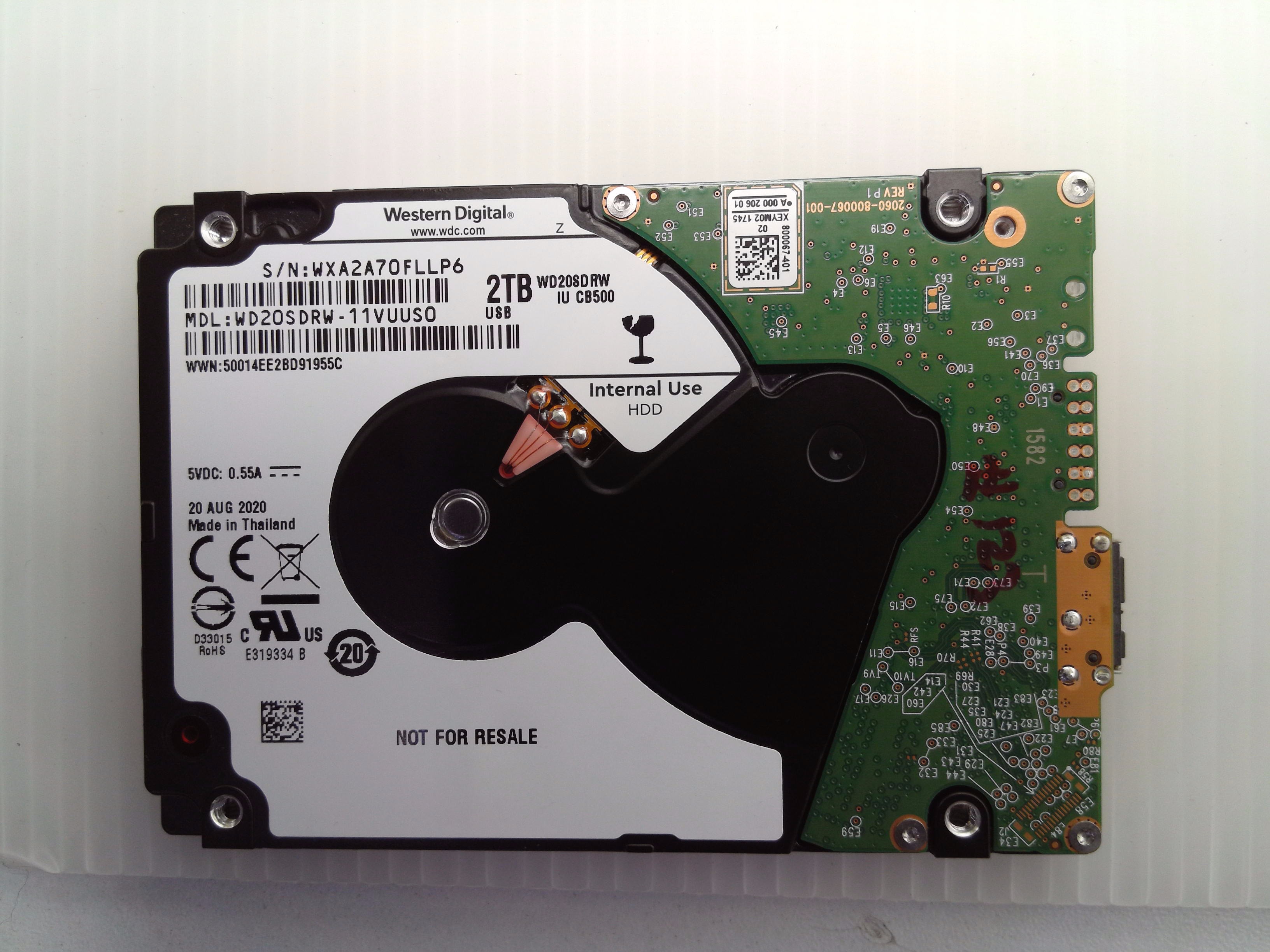

Forum rules
Post new topic Reply to topic  [ 125 posts ]  Go to page Previous  1, 2, 3, 4, 5 ... 7  Next
 Post subject: Re: WD MCU - No more...
PostPosted: August 27th, 2026, 5:44
Posts: 2854
pepe wrote:
once you know how to do it, it should be simple like 1,2,3, write a little tool to extract and write back, this takes time but after that it is a few clicks... making such tool is a lot simpler than do this soldering every time... Moving the MCU is even more simple :roll:
Trust me am aware of this, but again not as easy as it looks. process requires preparation and manually extract it.
In addition I prefer the commercial ver. to make some $$$ out of this, the tool as you mentioned is not a good idea for commercial purpose but personal usage i Agree :wink:
 Post subject: Re: WD MCU - No more...
PostPosted: August 27th, 2026, 8:27
Posts: 17295
einstein9 wrote:
"MCU locked means if you write native ROM to donor usb pcb data would be encrypted such as new charger/SpyG2 for example" ---->>@fzabkar
The point of what i did is simply using Native MCU in donor PCB without moving it
Yes, I understand that. I just don't understand why you need to wire your patient to your donor.
You say you will be offering a commercial product. What will that entail?
 Post subject: Re: WD MCU - No more...
PostPosted: August 27th, 2026, 10:35
Posts: 3598
Location: Chicago
1. Sometimes PCB does not work, and moving MCU seems like an easier task than soldering tens of wires. This is maybe 5% of all recoveries.
2. Out of those cases when PCB is broken and after MCU is moved about 10% don't work, because the MCU itself has problems (the drive either clicks or does not come ready or similar). In these cases maybe this solution would work
3. What nobody mentioned here is that IF the keys can be extracted from the MCU, there is no need to write them to another MCU, data can be decrypted with software. So extracting keys seems like a move to the right direction.
 Post subject: Re: WD MCU - No more...
PostPosted: August 27th, 2026, 10:50
Posts: 4840
knowing the key is just the start, one needs to know other params of the encryption, like salt value, how these are used, which might be tricky in the case of a hw based encryption.
DEK is usually wrapped using some method using the KEK, which is usually some hash of user pwd. Pwd padding, hash count, hash algo, all these methods need perfect discovery. Of course ideally this is the way, but until all these are reversed, writing the MCU key to another mcu might be just as fine.
I was also into it in some extent, but yeah, lack of time...
 Post subject: Re: WD MCU - No more...
PostPosted: August 27th, 2026, 11:27
Posts: 3598
Location: Chicago
pepe wrote:
knowing the key is just the start, one needs to know other params of the encryption, like salt value, how these are used, which might be tricky in the case of a hw based encryption.
DEK is usually wrapped using some method using the KEK, which is usually some hash of user pwd. Pwd padding, hash count, hash algo, all these methods need perfect discovery. Of course ideally this is the way, but until all these are reversed, writing the MCU key to another mcu might be just as fine.
I was also into it in some extent, but yeah, lack of time...
I can do all that for Chargers, just need to know the MCU keys :)
 Post subject: Re: WD MCU - No more...
PostPosted: August 27th, 2026, 11:32
Posts: 4840
nice then :)
 Post subject: Re: WD MCU - No more...
PostPosted: August 27th, 2026, 12:15
Posts: 17295
What does this mean, and why does the commercial product need a "bridge"? Or is your interpretation of "bridge" something other than the USB-SATA bridge? Once you release the product, everyone will see how it is constructed, so I can't see the point of obfuscation.
einstein9 wrote:
3- My Research which is based on the Chinese PCBs which converts USB to SATA. we have to remove few caps and jump wire few pins from patient to donor pcb
process takes few min. and you are set & ready to go. (probably will be released next year as a commercial bridge pcb by our Team)"
 Post subject: Re: WD MCU - No more...
PostPosted: August 29th, 2026, 2:28
Posts: 2854
Doomer wrote:
1. Sometimes PCB does not work, and moving MCU seems like an easier task than soldering tens of wires. This is maybe 5% of all recoveries.
2. Out of those cases when PCB is broken and after MCU is moved about 10% don't work, because the MCU itself has problems (the drive either clicks or does not come ready or similar). In these cases maybe this solution would work
3. What nobody mentioned here is that IF the keys can be extracted from the MCU, there is no need to write them to another MCU, data can be decrypted with software. So extracting keys seems like a move to the right direction.
I have to disagree with you here Doomer:
1- Removing the MCU Key will result in encrypted data
2- Moving Key to another MCU PCB works (tested)
 Post subject: Re: WD MCU - No more...
PostPosted: August 29th, 2026, 2:31
Posts: 2854
What does this mean, and why does the commercial product need a "bridge"? Or is your interpretation of "bridge" something other than the USB-SATA bridge? Once you release the product, everyone will see how it is constructed, so I can't see the point of obfuscation.
einstein9 wrote:
3- My Research which is based on the Chinese PCBs which converts USB to SATA. we have to remove few caps and jump wire few pins from patient to donor pcb
process takes few min. and you are set & ready to go. (probably will be released next year as a commercial bridge pcb by our Team)"
I mean the new commercial product will be based on that, instead of wiring we use the jumper pins (similar to this image)
wd-.png [ 99.11 KiB | Viewed 9303 times ]
 Post subject: Re: WD MCU - No more...
PostPosted: August 29th, 2026, 9:18
Posts: 17295
I understand you are using pogo pins, but I don't understand your reference to a bridge. The donor and patient PCBs have their own USB-SATA bridges, so are you saying that the donor PCB needs to use the patient's bridge? Otherwise you are mangling the terminology.
 Post subject: Re: WD MCU - No more...
PostPosted: August 30th, 2026, 3:14
Posts: 2854
@ fzabkar
As i said before, the point of the bridge is as a Ref. idea probably you didn`t get my point yet.
 Post subject: Re: WD MCU - No more...
PostPosted: August 30th, 2026, 5:11
Posts: 17295
What is a "Ref. idea"? And no, I don't get why you are still referring to a bridge if there is none. Most of all, I don't understand your contribution to the project, other than pogo pins.
 Post subject: Re: WD MCU - No more...
PostPosted: August 31st, 2026, 11:17
Posts: 1729
Nobody noticed, what if the MCU is physically damaged or the entire native PCB is missing.
Is there a solution ?
 Post subject: Re: WD MCU - No more...
PostPosted: August 31st, 2026, 11:47
Posts: 1768
Location: Verona, Italy
unknown wrote:
Nobody noticed, what if the MCU is physically damaged or the entire native PCB is missing.
Is there a solution ?
https://forum.hddguru.com/viewtopic.php ... 33#p317233
michael chiklis wrote:
Very good news. :cool:
I just got a Charger WD drive that has bad patient pcb, with sata donor i was able to access to SA but user area resulted encrypted.
But fortunately this time i was able to repair patient usb pcb, so all data was recovered. :D
Is good to know that now there is someone here that is able to extract the key from MCU from this encrypted pcb, may be useful in future.
What can you say about cases where the MCU is damaged/lost?
It will be possible to hack encryption algorithm to generate the decryption key for each case if mcu is lost??
i asked this question but i didn't get any answer about it!
At this point i believe that this is just a pogo connection between PCBs, useful when patient pcb is unrepairable but MCU is still working (in this case is much simple to just swap mcu).
With lost/damaged patient mcu this "solution" is not applicable, i believe
My firmware database:
 Post subject: Re: WD MCU - No more...
PostPosted: August 31st, 2026, 12:39
Posts: 1729
michael chiklis wrote:
i asked this question but i didn't get any answer about it!
Sorry friend didn't see your reply.
michael chiklis wrote:
With lost/damaged patient mcu this "solution" is not applicable, i believe
Exactly.
 Post subject: Re: WD MCU - No more...
PostPosted: September 1st, 2026, 2:21
Posts: 2854
@michael chiklis sorry i did not pay attention to that particular note,
I did not face any completely dead MCU and i believe its difficult to have one. (can try if i get one)
in case of pcb damaged and beyond repair i believe its possible to extract the key and write it back to donor pcb.
 Post subject: Re: WD MCU - No more...
PostPosted: September 1st, 2026, 3:09
Posts: 2854
Quick for you guys:
Suppose someone replaced the "native usb3 pcb" with another and he wrote native rom to it
Anyone knows how to tell if this pcb is for that drive? (in case if both pcbs have the same native ROM)
 Post subject: Re: WD MCU - No more...
PostPosted: September 1st, 2026, 4:30
Posts: 17295
einstein9 wrote:
Quick for you guys:
Suppose someone replaced the "native usb3 pcb" with another and he wrote native rom to it
Anyone knows how to tell if this pcb is for that drive? (in case if both pcbs have the same native ROM)
Check the date codes on the ICs and compare with label. That's just one way.
 Post subject: Re: WD MCU - No more...
PostPosted: September 1st, 2026, 4:39
Posts: 17295
einstein9 wrote:
in case of pcb damaged and beyond repair i believe its possible to extract the key and write it back to donor pcb.
What if the MCU cannot be powered up, such as when the motor controller is burnt?
 Post subject: Re: WD MCU - No more...
PostPosted: September 1st, 2026, 4:44
Posts: 2854
einstein9 wrote:
Quick for you guys:
Suppose someone replaced the "native usb3 pcb" with another and he wrote native rom to it
Anyone knows how to tell if this pcb is for that drive? (in case if both pcbs have the same native ROM)
Check the date codes on the ICs and compare with label. That's just one way.
Attached is sample drive with pcb, which date codes you are Ref. to?
2026-09-01_00451.jpg [ 1.28 MiB | Viewed 7425 times ]
2026-09-01_00450.jpg [ 1.27 MiB | Viewed 7425 times ]
Post new topic Reply to topic  [ 125 posts ]  Go to page Previous  1, 2, 3, 4, 5 ... 7  Next
