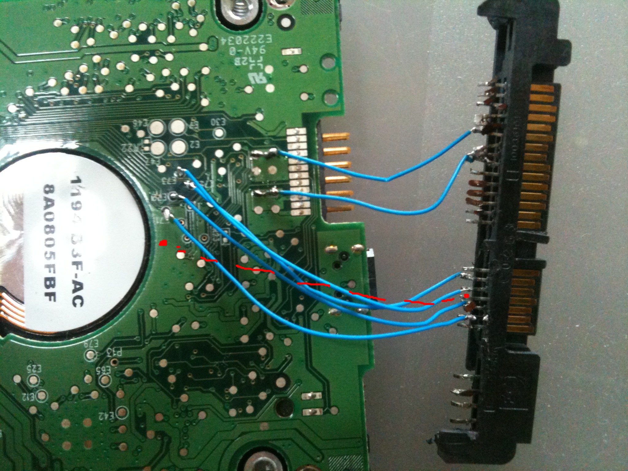

My English is not very good. So upload a photo. A picture is worth a thousand words. I hope it helps. I still do not test. I've seen on a Russian forum, I think.
Greetings.

Has anyone tried to change the crystal oscillator? I have repaired many USB devices that were not recognized. And the problem was the crystal oscillator. It's just a question

Yes, my drive spin up but is not recognized. I tried to do this
and now it recognizes it but nothing happens.
In another post you had said it was necessary to remove the capacitors do not know if this applies to this hard drive.I do not know if I'm writing well. My english is not good.
 Post subject: Re: WD5000BMVV connector
PostPosted: November 11th, 2011, 22:47
Posts: 17328
Yes, you need to remove the capacitors. Doing so will prevent the USB-SATA bridge IC from interfering with communications.
That said, you will then have a problem with encryption, assuming the drive is OK.

Hello, I have removed the capacitors and voilaaa! I can access the data.
Thank you very much to all members of this great forum :D

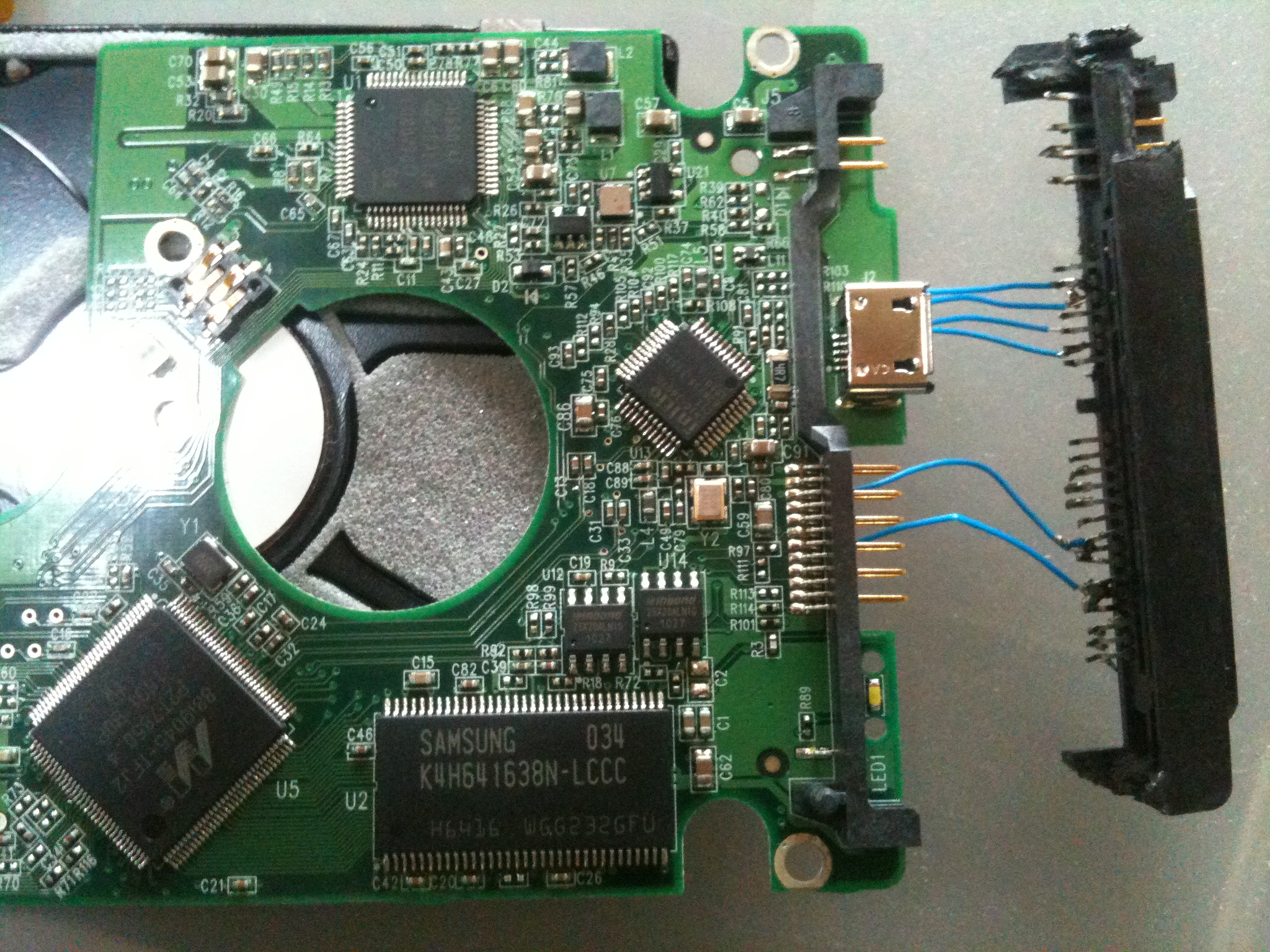

Hi everyone !
I'm new, I apologise before for my english (I'm French).
I have the same problem, my drive spin up but it is not reconize, the light is working.
I tried to do as xose_maria, as you can see on the picture below but I miss a point (in red on my picture to connect the middle pin on the connector)
My second point is about the capacitors that we need to remove... which ones are they ?
Thank you for your help you are my last hope for those data ...
File comment: I miss the point in red, xose_maria has weld a wire to the middle pin of the connector but I don't have anything...
