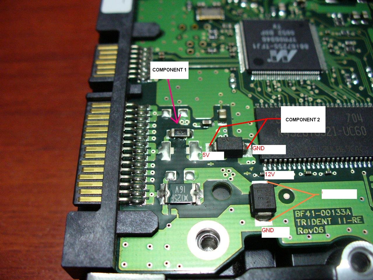

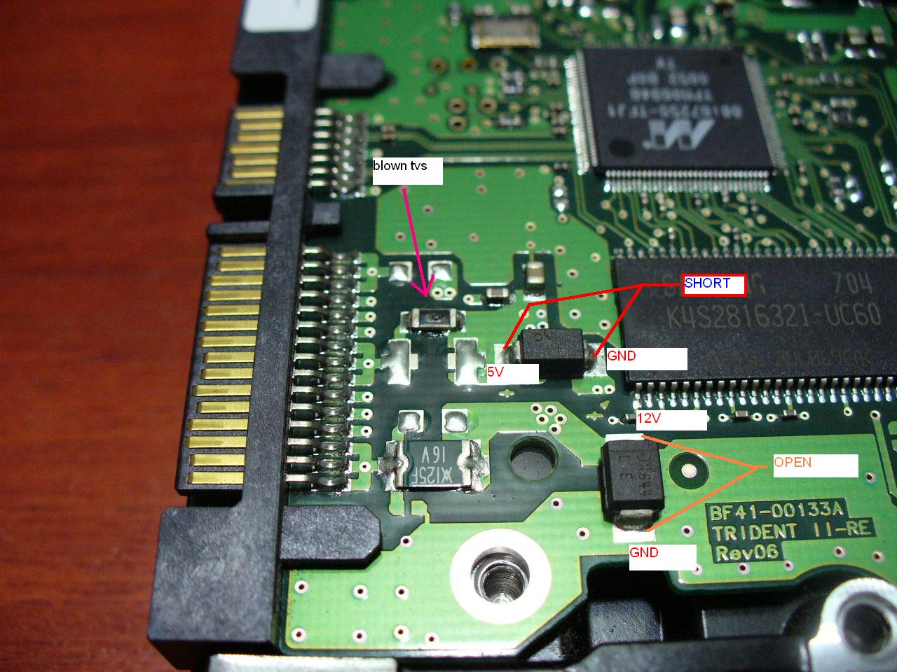

I think I have something:
Please correct me if I am wrong. The piece that follows next to the TVS is a diode.
The 12V line has one. The 5V line has another one. These two diodes are touching GND on one side and Voltage lines in the other. The 12V line is open (edit: with a number greater than 1 in the multimeter wich do not understand clearly) (1 is no conductivity, 0 is full shorted).
The 5V line is full shorted (edit: and reads 0 in the multimeter).
Maybe there is the short-circuit?
I have attached an image.

I must have misunderstood. I thought you said you checked for shorts. When the TVS fails, it often shorts, which is actually a good thing (Hopefully it protected everything else). With a shorted TVS, you will be blowing fuses. Replace or remove the TVS, then try starting up with a fuse.
Sorry, rchadwick, I do not have much expertise into this. I did check, but I somehow skipped that. That piece is marked "648 HE". Any word on that? I have googled it and it says it is a diode.
Just for being clear, ¿should I put the fuse where the jumper is, and replace the "648" diode with other one similar?
Thanks so much!!! I am starting to see a light!!!

You have to remove/replace damaged diode, then your HDD should start (hopefully). The diode shorts when voltage is increasing, PSU detects the short and switches off (good PSU should). The diode is permanently damaged right now and your PSU won't start. You can try to start the HDD without the diode (just unsolder it, don't replace if you don't have matching one), but then you don't have any protection (if the same problem with your PSU will occur again something more than a TVS will be burnt).
It happens often that not only TVS is damaged - PCB elements can be damaged even when TVS worked...
PS: TVS is that black thing with visible crack on it (labeled "SHORT"). You marked a fuse (or 0 ohm resistor) with TVS label - just to be sure you unsolder right element ;)

YESSSSSSSSSSSSSSSSS UJUUUUUUU I am soooo happy.
I went downtown and found someone that had seen this issue lots of times before. He extracted a 000 jumper from somewhere and the diode from an Asus board near to a USB connector. Now it works!!! Perfectly.
I am going to give you further info on the diode as soon as I finish backing up my work!
Thank you so much. The knowledge I have from this forum is awesome and helped the technician do his work easily as I guided him into the troublesome spot inmediately. Also I had to correct him once because of the positioning of the diode.

Yes, I definitely had a confusion with the jumper and the TVS. It is the device next to the jumper, wich was shorted and that caused the jumper to burn, so the fuses that I use would always toast.
The TVS was replaced with a PJ44 SK24 one, extracted from another board.

Hello barbaroja. I've been following your case for a couple of days since I share your bad experience with the exact same model of 500GB Sata hard disk, which I found to be inside my external hard disk drive made (or assembled) by LaCie. The casing of the external disk and its power supply messed up both components you specify on the JPEG file you attached previously.
My loss of information was considerable, almost 400GB of stuff I'd like to recover (and if possible the drive, too).
Is there any chance you or the rest of you guys can help me discover the specifications for both such components? I'm looking for someone at work who can help with the soldering but, obviously, I have to buy the replacement components.
I'll be forever grateful for your help.
