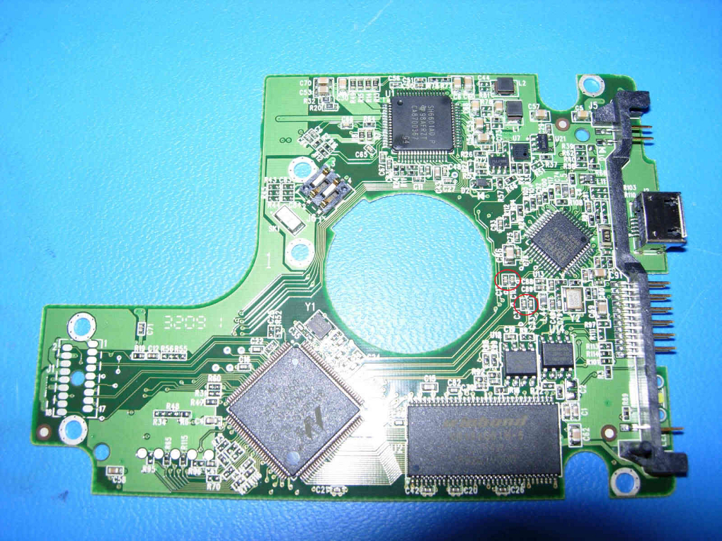

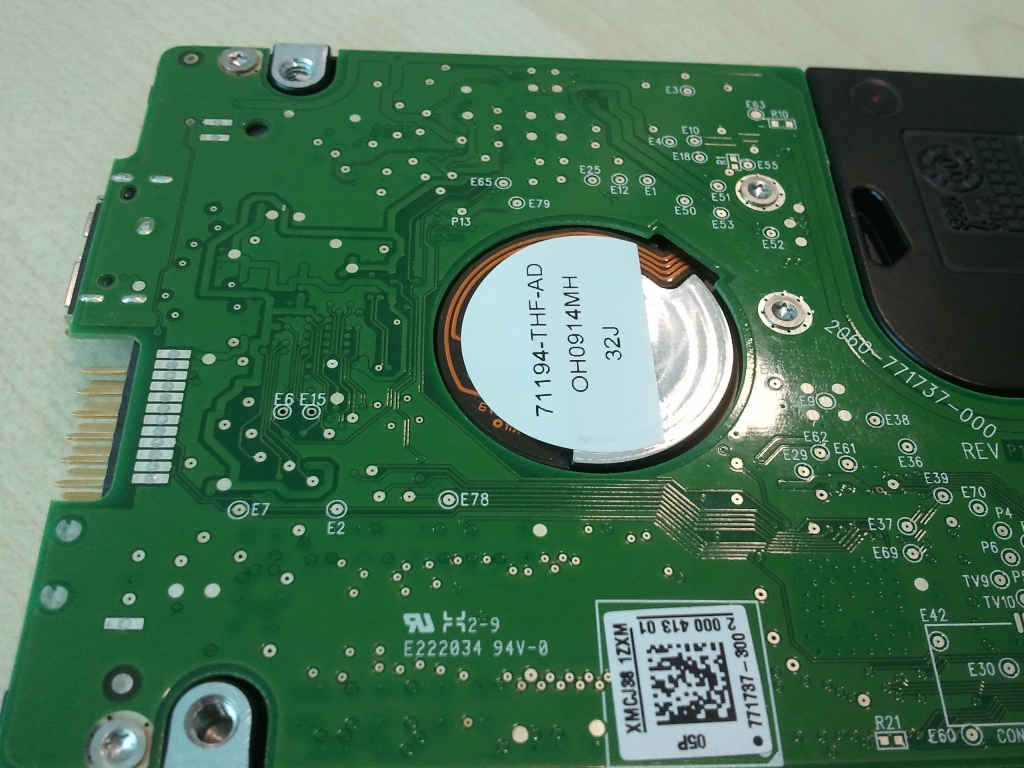

@hiace90, it appears that C13, C18, C31 and C33 are the SATA coupling capacitors. You should be able to confirm that by checking for continuity with the SATA Tx/Rx pins using a multimeter.

Ok Great thank you !
Do you have an ideao about the point in red on my picture ? I have nothing but xose_maria seems to have something ?!
Thank you, I will try with removing the capacitors

Your red line is the signal ground. You may be able to get away without using it, but strictly speaking you should connect it to minimise noise.

Ok but I don't know if you can see on the picture but I don't have any point under the point 71. I'm ok to connect it but to what ? I just weld the wire to the green surface (this seems strange) ?!

I removed the capacitors, it is still spinning up, the light is working but new I plug the drive on a computer (directly on the motherboard) nothing happen...
I'm afraid that I lose everything !

Assuming you've done evrything correctly, then the problem must be internal to the drive. All you have done is to bypass the bridge IC in the slim hope that it was faulty.

I had the same problems, but removing the capacitors could access the disk contents. Before removing the capacitors, LED blinking all the time.

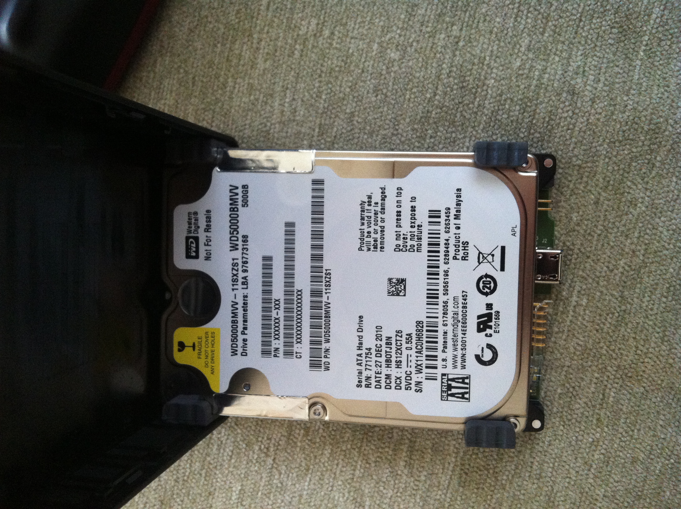

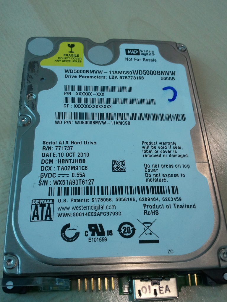

Hello.
I have the same problem. I have a WD 500GB Elements, the same model than you, i think. I plug in the usb port, the LED stay turn on, not blink. After one or two minutes, start blink, in Linux sometimes finish mount it and i can access the data but very, very slowly. I can recover some files and then it disconnect.
Can you confirm that is the same model than yours?
Thanks.

I have tried to solder it to a SATA connector with the removal of the capacitors. At first, the computer did detect a storage device, but failed to initialize it. (i only have a laptop, so i used a SATA-USB adapter). During the connecting sessions, LED did blink, but the hdd had some clicking sounds during the first 5 seconds, then it stops.
But now it is back to when i started, no recognition, hdd spins fine, and having steady LED light.
I am managing to get another HDD with same model, hoping the new board can at least detect a storage device. I guess I will decide whether proceed or not if it does detect successfully.

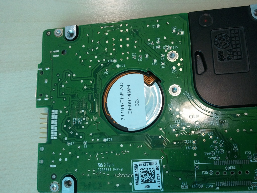

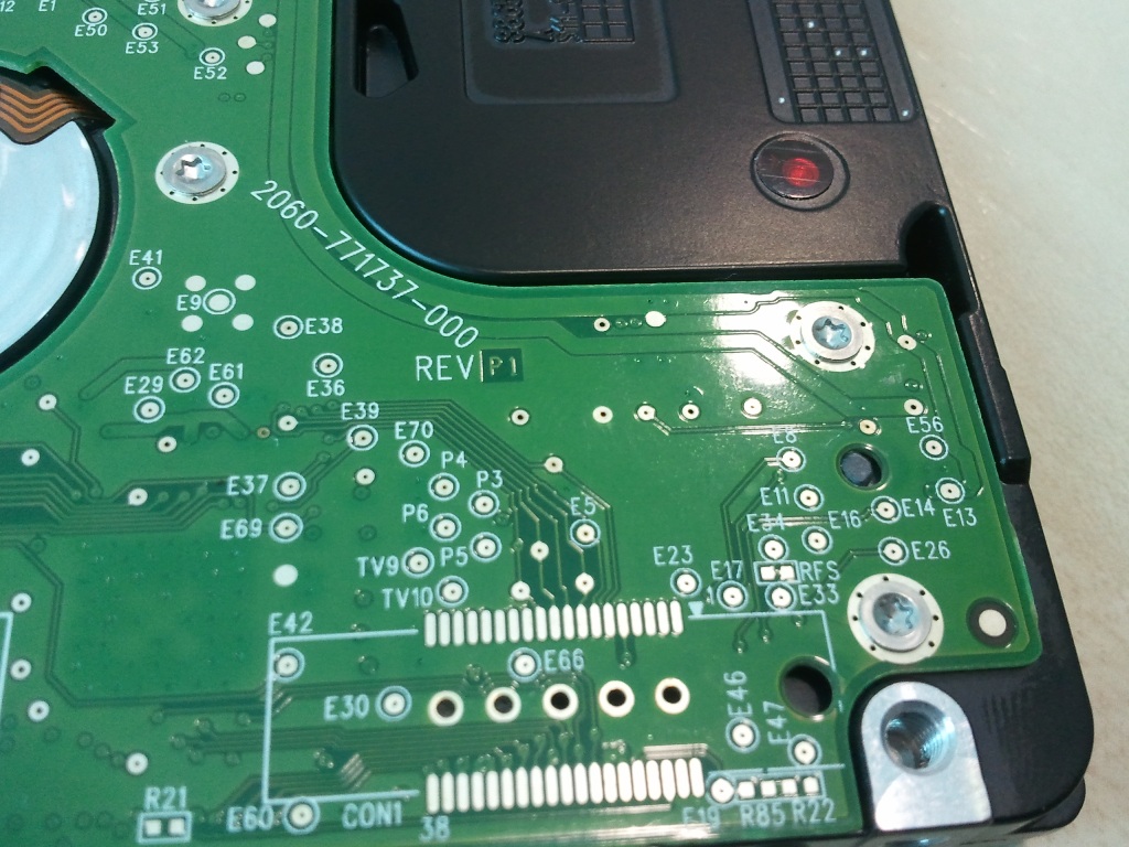

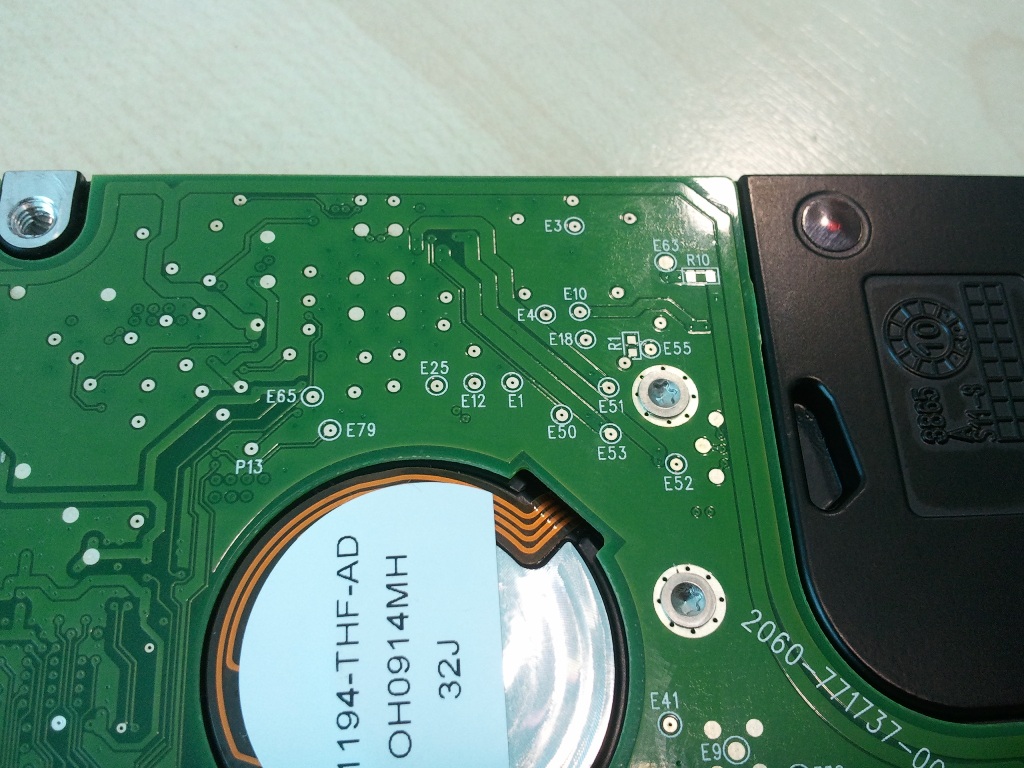

Hello everyone,
I am having the same problem.... hdd is recognized but with 0 bytes :((( I saw pinouts for SATA but my PCB is slightly different. Does anyone have pinouts for this one?

There are no SATA pins at the 12-pin header. Most of the pins are used to drive LED indicators or to receive input from pushbutton switches, at least on the more expensive models.
However, AIUI there are three pins (GND, Tx, Rx) at the end of the header that are used for serial (TTL RS232) communications. This serial port provides access to the System Area on the platters. A common fault on WD drives is firmware corruption. This is consistent with the "0 bytes" symptom, but there are other possible causes.
If it is indeed just a firmware problem, then the total DIY cost, including data recovery software, should be around US$150, for someone who has the requisite experience. I have yet to try this myself, but I'm convinced that it wouldn't be too difficult.
