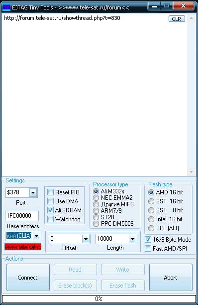

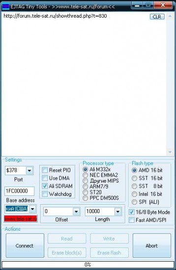

http://icegsm.narod.ru/Programms.htm
EJTAG_TT
The program is a JTAG programming of flash. Originally conceived for flashing receivers, but can be used not only for them.
Currently supported processors are the following (in absolute value):
1. Ali M3327, 29
At the moment the only program that allows receivers to flash with the processor and the SPI-flush. Applied a special algorithm for fast programming of flash data to the processors based on MIPS-optimized commands.
Forum thread
2. NEC EMMA2L (L) (uPD6111h)
The basis was taken EJFlasher, redesigned and much improved as a result of the speed of these processors. Supports the new processor NEC EMMA2SL (uPD61217), reaching a new receivers Interstar XPEED.
Forum thread
3. ARM7 / 9
This module was developed in the program for flashing receivers processor-based Conexant CX24138-43. You can use for other ARM processors (tested on ARM7TDMI AD6522 - LG-5200).
Twig Forum Conexant
4. It supports multiple MIPS-processor, such as Broadcom, BRECIS etc
5. Processors ST20 (module is enabled only for beta testers).
Currently it supports the processor STI 5518. The module will be activated in a future release (after testing STI 5119).
 Post subject: Re: Marvell 88i6745n JTAG
PostPosted: September 2nd, 2011, 10:04
Joined: October 13th, 2005, 8:35
Posts: 6
Location: АР Крым
please, Replace picture on the post.

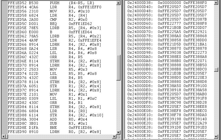

Ok. I found rutine for writing internal FLASH.
On right side is Main Command table so you can find other commands.
On left side is rutine that writes 0x40 bytes to internal flash.
Base port for FLASH is 0x1c00aa00
[0x1c00aa08] and 0xff00 or 7
[0x1c00aa08] or 300h
[0x1c00aa04] <= 32 bit addres to write in FLASH
[0x1c00aa08] or 1000h
[0x1c00aa10] <= [32 bit data]++ * 0x10 ;writing 0x10 32it data to flash
[0x1c00aa08] and not 1000h
etc,etc.......
NOW YOU HAVE EVERYTHING TO MAKE PROGRAM TO REPAIR FLASH USING SERIAL COMUNICATION!
B.R.
Dejan

Well, I allready told you that I repaired FLASH using JTAG debugger. I did not analyze much
how rutines for writing works but it is not complicated. You have to trace program using JTAG.
