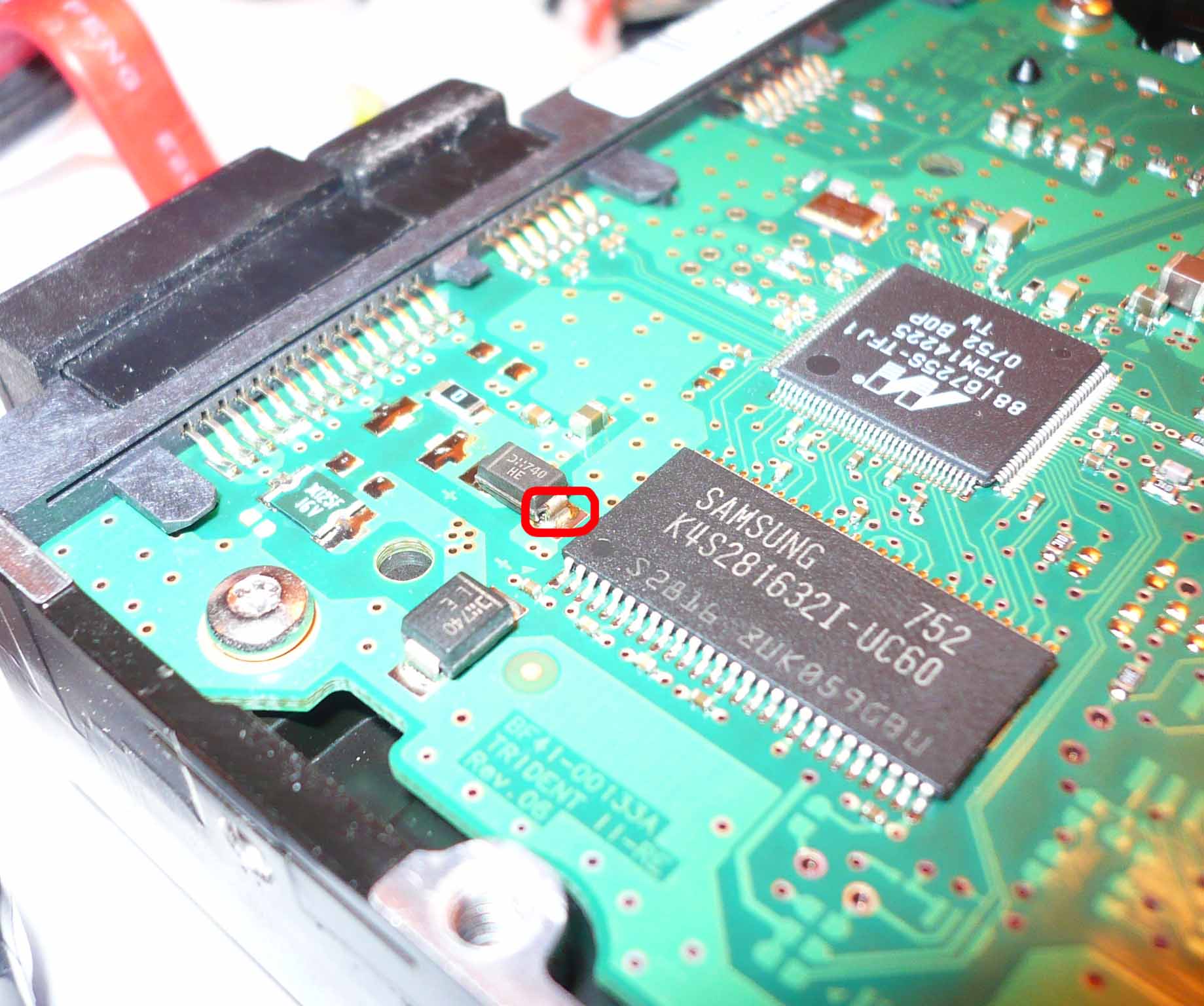

Hi everyone,
it sems that I have totally same problem nad totally sam disk.
(if my english will be bad then tell me about it and I will give better explanation what I mean)
Cause of damage
Cause of damage is ME. I'm so stupid.
Power supply of my external enclosure burned so I tried to connect similar power supply that I have. It was same manufacturer and quite similar type of external box. But there were different connectors. So I connected power supply connector and enclosure by simple cables. It worked fine but then I wanted to change disk and I wasn't careful and forget for reflection of connectors and swap 5V and 12V connector. Disk blowed.
Now, if I try to start disk then it smells and fumes in part on picture:
I checked that solder melts in part in red ring on picture.
What solution?
First, I want to buy another disk and try to swap PCB and safe data
Then I would like to try to repair damaged disk.
But I read that swapping would be probably problem:
http://datacent.com/datarecovery/hdd/samsung/HD501LJ
If this is the case you can try to swap PCB from another hard drive of the same model but the chances of success, especially on newer hard drives, are close to zero. The problem is that logic board on modern hard drive is adapted to the head disk assembly it was manufactured with. In our lab we use specialized software and hardware to rebuild these adaptive parameters in ROM to make donor PCB fully compatible with damaged drive.
Is this information true?
I don't mean money safe like reason because I want another external disk to backup first disk anyway. So new boughten disk will be in use.
I have already HD501LJ in order to buy it. Should I cancel that order, skip swapping of PCB and start to solve problem like in this thread?
Thank you for answers

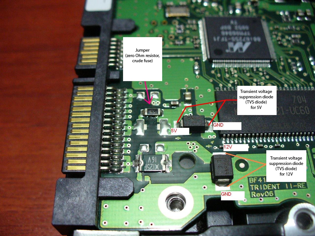

Please, delete my previous Post and add information about replacement of terms "fuse" and "TVS diode" of barbaroja to first post of thread!
Now I finish studying of this threat from beginning carefully and now I think that I understand to all the things.
First, I attached final true description of Samsung HD501LJ parts.
Zero-ohm link (Zero-ohm resistor) made like SMT resistor
and
Transient voltage suppression diode (TVS diode).
File comment: Final true description of Samsung HD501LJ parts

It sems that I have totally same problem nad totally same disk.
Cause of damage
Cause of damage is me. I'm so stupid.
Now, if I try to start disk then it smells and fumes near TVS diode for 5V (on picture):
I checked that solder melts too.
TVS diode for 5V is printed with something like:
]¦¦740 HE
TVS diode for 12V is printed with:
]¦¦740 LE
Zero-ohm resistor (part printed with "0") looks OK (thanks to weak power suply for external enclosure).
So now I need to know alternative to TVS diode for 5V - is this enough information that it's for 5V in shop?
P.S.: Before reading this thread I thought about buying same HDD and swap all the PCB but I read that swapping wouldn't be useful:
File comment: My dead Samsung HD501LJ

YES! HDD works again after removing TVS!
All thanks to this forum!
Now what is TVS with strange number ]¦¦740 HE?

If you want to use the good hdd (without tvs), i suggest to try to find another (almost any model) dead samsung hdd from ebay, and move the good TVS from the bad hdd to your.
The TVS have only 2 type, the 5V and the 12V type.
If you match the voltage side, you only need to match the polarity as well, and you are done. ;)
The drive is safe again.
Janos

Thanks to all of you for your comments and help. I have the exact same problem as detailled throughout the post.
I would like to test shorts on the PCB, but I'm not sure how to use the multimeter. Could you give me precisions ?
Should I realize the test with PSU connected ?
The multimeter should be in which mode ? ohmmeter ? voltmeter ?
Thks again!

No, without power supply!!!!!
You will use Ohm-meter. When resistivity is 0 then TVS is bad, when infinity than TVS is OK.
How To Use A Multimeter

Hello people,
I tested my PCU for shorts around the 2 TVS and the jumper.
I read the following values (calibre 2000kohms)
jumper : 1365
TVS 5V : I read 1
TVS 12V : 43
What do you think of those values ?
Thank you so much again for your answers,
 Post subject: Re: Samsung HD501LJ dead, a year of work in risk!!!
PostPosted: September 15th, 2009, 16:53
Joined: March 11th, 2009, 16:45
Posts: 25
Location: Czech Republic
5V TVS should be good - 1 on the left side of display means infinity.
Please decrease range of resistance. If 12V TVS will be infinity then it's OK too.
Jumper is a conductor and it should have low unmeasurable resistance.
