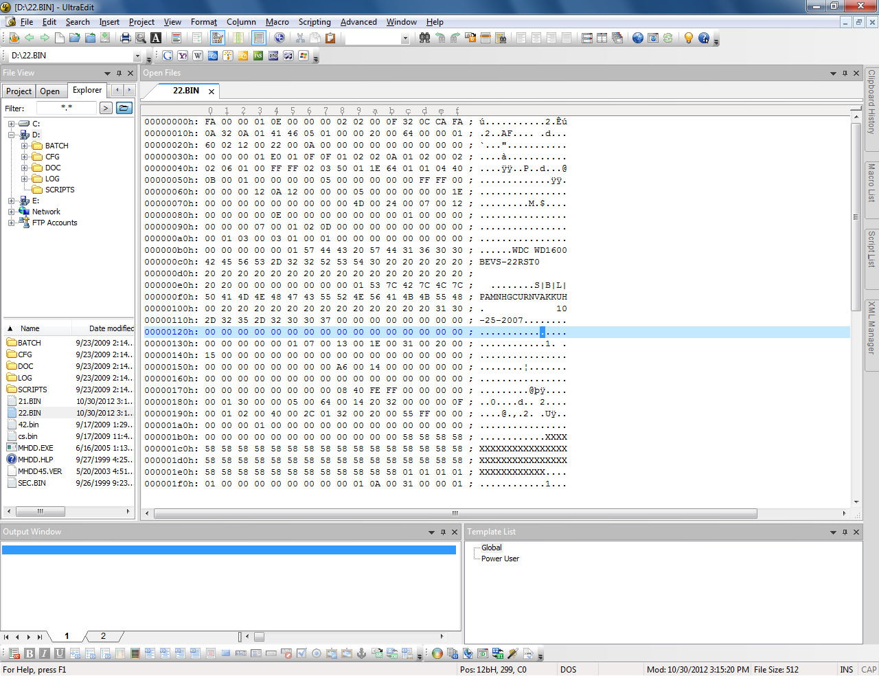

Hello all, this has been quite the thread to read.
I have a WD WD1600BEVS-22RST0.
My BIOS password has always been randy. My Acer 5610z has also been very flaky for quite some time, a tech told me a while ago that I may have had a bad graphics board or a bad solder connection because when I touched the corner of my laptop, it would sometimes instantly turn the machine off.
The other day, my laptop turned off, and would not turn back on. I tried the HDD in a different machine, and it told me it had security on it. I took this message to be different than the BIOS password, but from what I'm reading, a BIOS password and the User Password may be 1 in the same? I had thought maybe in my mobo's last dying breath, it put an additional lock on my HDD.
I used MHDD and followed the instructions here, and my 22.bin showed what I decoded as randy as well. The master password appears to just be 'lt'.
Neither of these passwords are unlocking the HDD using MHDD 4.5 or 4.6. I've tried many variations for both randy and lt, including the spaces in between chars, padding out to 32, etc.
A PC Tech is suggesting we try a similar or the exact same MOBO, but after reading this, that may not work either?
"Yes, it depends on the BIOS. Some (particularly laptops) will do some hash function from your passsword and system ID's, so it won't be visible in plain ASCII form. If your motherboard is dead, you can't see your data on other one. It is one of the reason it is generally a bad idea to protect your data by system password. And false sence of security too."
It also sounds like even with the correct pwd, MHDD might not perform the unlock, and I may need to try some of the others mentioned?
Lastly, I saw where someone tried AFF and at first it didn't work, complaining about firmware, then later it did. Did he apply more recent firmware, if so, can I do that from a different laptop? I ran AFF Diagnostics to make sure purchasing the license would work, ie, my drive wasn't dead/hopeless corrupted, and it finished saying: "The hard drive is locked. If you need to remove the password, you can proceed with unlocking. The data stored on the drive will remain intact."
Thanks everyone for taking the time to view my post.
File comment: 22_bin
PostPosted: October 31st, 2012, 0:36
Posts: 17323
@Samantha_14, try entering the full 32-byte string using the hexadecimal data in MOD 02 rather than the equivalent ASCII strings.

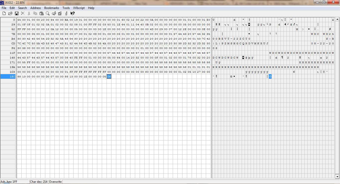

Hello
Could someone please tell me the password for my Western Digital Drive. I attached a screenshot of the bin file.

johanlast, I'm having a hard time following your editor, could you try a different one and repost, like Ultra Edit or Hex Editor 6.1?

johanlast wrote:
Hello
Your WD master password is shown ie the WDC bit :wink:
If you look at the previous page you'll see the walkthrough I posted
Repost:
Are you accepting the risks involved with DIY?
Your dump has the master password in plain text you just need to know what to do with it:
1) Download "MHDD v4.5" http://hddguru.com/download/software/mh ... 4.5iso.zip
2) Burn boot cd from the ISO image
3) Boot to the MHDD CD
4) You will see a list of harddisk, select a harddisk you want to unlock
5) Type "unlock" and reply "1" for master password

Loki, Thank you. I need to express how absolutly clear and how step by step this was laid out. The order by which I was attempting to put in the pass word was my bane in my entire process to get those blasted WD drives finally unlocked. The Default Master Password was the one. I was lucky.
Even better, Samantha_14 was fantastically instrumental in pointing out key issues with my initial starting process. It seems I was doing the right things, again, out of order and I did it all from the bootable floppy disk. Without Samantha_14 's help I never would have got started. Thank you both.
I'll like to write out some steps that make help a lot.

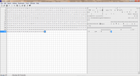

Hi all,
After spending a few hours to read this topic from page 1, I succesfuly unlocked a WD320BEVT drive.
I did run .dump script on MHDD 4.5, then I got my 22.bin. There were 32 bytes (without 00 pads) followed the header 01 07 00 - it was the USER password.
No need to convert to ASCII or decimal (and it didn't work for me, either), just use HDAT2 v4.7 or above, and you can input your HEX bytes to the password field.
Unlock, disable password with HDAT2, and it's done: drive unlocked.
Thank you for everyone, keep up the good work.

A very relieved update:
The Dell I was using didn't like the locked HDD in Sata 02, so b4 I abandoned using a Dell at all, I tried putting the locked HDD in Sata 00 (master), and at that point, HDAT2 4.5.3 was able to see it, before all it saw was the other sata 00 but not my locked drive in sata 02, although it still did not see the slave I put in Sata 02.
First, turns out 0 is not hex 00 in keyboard scan codes or the ascii equivalent. Whereas R was hex 13 in scancode world, in non-scancode world, R is hex 52 while r is hex 72. I found this out using Hdat2 4.5.3. Although it would show me the Hex equivalent, I couldn't actually input in hex in that version, from what I read, I needed 4.7 or higher. I was going to need a higher version since some of the hex I needed were not going to be available using the keyboard as far as I could tell, especially 00 and DC3, etc.
I dl'ed HDAT2 4.9.x and burned the iso to a CD, and booted from that. HDAT2 4.9.x was diff right away in that it saw both my locked drive in Sata 00 but also the other drive in Sata 02. There I found the Hex mode, it was a little kludgy as far as inputting them went, you couldn't just input them all at once, you had to input 1, have it accept, go back into hex mode, remove the previous value using backspace, right arrow, backspace, then re-enter another, have it accept, etc. If you wanted to update the Hex string, you had to hit enter. Once you verified your string was building correctly, when you went back into the password, it would throw you to the end of the string, so you had to space back over, etc.
At any rate, I got my string inputed exactly as the 22.bin file showed, hit enter, and rather anti-climatically, it told me that the command was successful! Since I did Unlock vs Unlock Device, I also had to Disable Password, and that was just a Y/N challenge response. It worked.
Next thing was to change the HDD's back to their original order so I could boot using my unlocked laptop HDD as a slave for easy copying purposes, and then to change the bios boot options sequence to SATA 1st as opposed to CD/DVD first.
Once booted, I went into Disk management, and my drive was being read and my drive letters were assigned. I went out to one of the drive letters of the unlocked HDD and opened a file. What a relief!
I've since hooked up my External USB HDD, and I'm copying my data to it as a backup.
I'm so thrilled to have my data of over 5 years back and being backed up. I'm definitely going to be purchasing some form of NAS with Raid 2 and begin backing up my home drives periodically.
Thanks to everyone!
