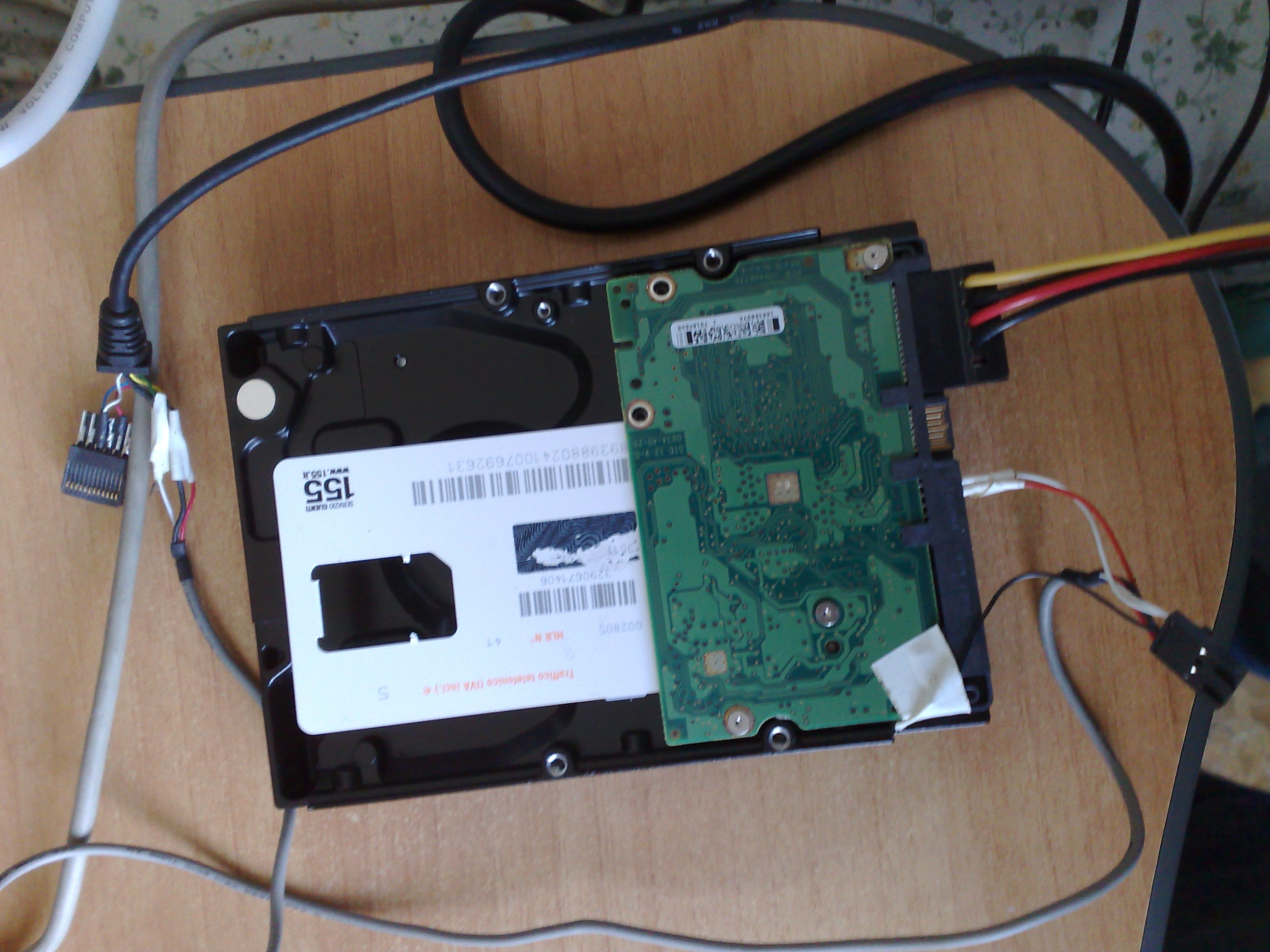

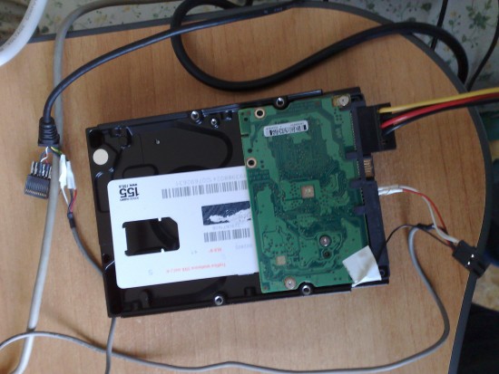

I have read your solution.
I have got a siemens RS232 data cable of my old S45!
I have taken connector number 5 to TX and connector number 6 to RX; connector number 1 to GND.
I have assembled the all, but it doesn't work!
I couldn't see anythiong from hyperterminal!
Where is the mistake?
Thanks for all

I think I had to hit a blank <return> to get the first T> prompt (or whatever it was), does you disk spin up? Did you set the port correctly in hyperterminal?

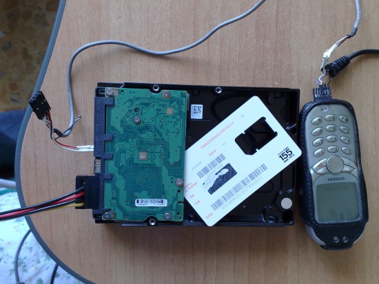

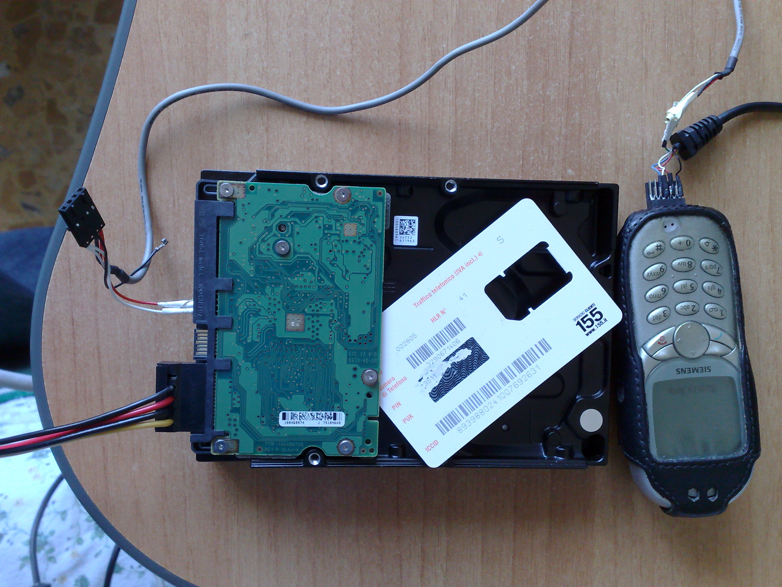

I think that I must put the GND in common with all, is it correct?

Are you really connecting the phone, the harddisk and the computer at the same time, on the same cable? :shock:
I'm using my S45 cell like a battery for MAX232!
The TX and RX connector is out from the S45 connector! There are in the hard disk!
I think that the problem is that data cable is original siemens!

An easy way to test the cable is to short tx and rx (without connecting the hd!) and see if you have an echo when typing on hyperterminal if you do the cable will probably work, if there's no echo, make sure you disabled hardware flowcontrol...
My siemens cable has a pl2303 plus discrete components that prevent using the cable for such applications :)
