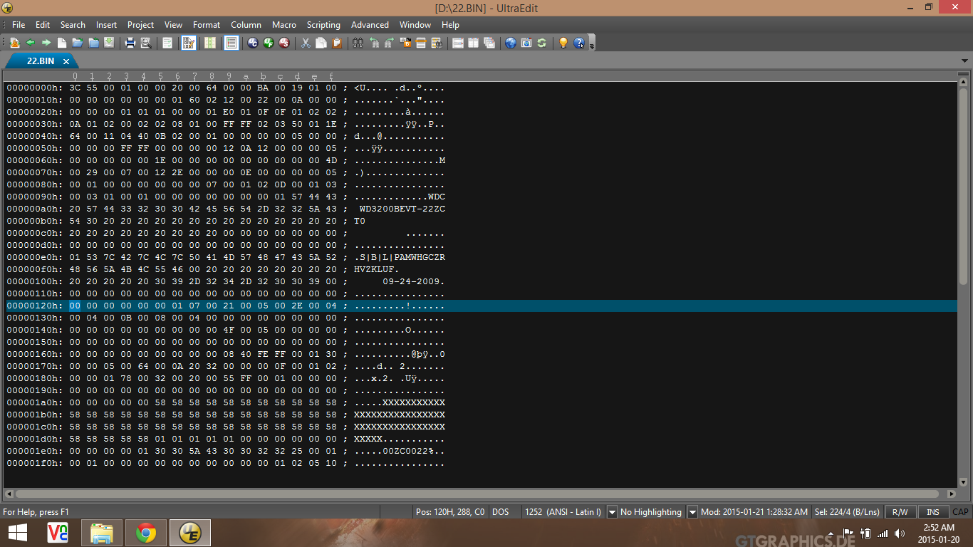

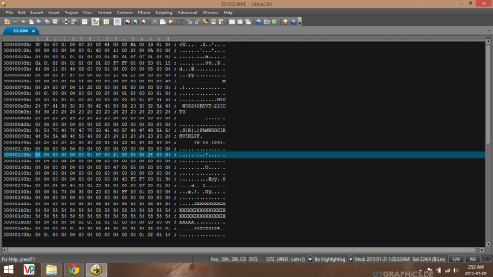

Wondering if someone could please help me with this I have already run mhdd and for the 22.bin file and have tried to use it in victoria to unlock my drive but its not happening. Here are the results from the 22.bin file,
I am close to pulling my hair out. any help would be greatly appreciated
 Post subject: Re: ATA password bypassing
PostPosted: January 20th, 2015, 16:32
Joined: January 20th, 2015, 3:43
Hey thank you for that guide but my problem is with identifying the password in the hex string I started at 00000030 9th position in and selected 32 bytes in the string, I saved it in a hex editor and went through the unlocking process in victoria from a password file. when I click on unlock (yes in user mode and high security) I keep getting the error "error after DISPWD"

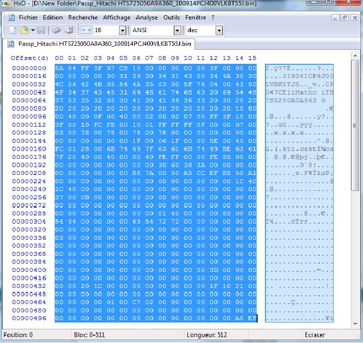

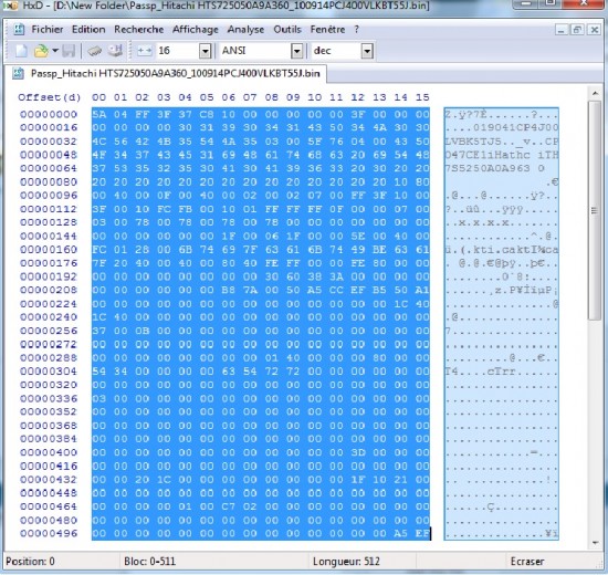

Hello everybody,
To begin, i'm sorry for my English
thanks to Spildit for his guide.
But i've got a problem with this guide.
My hard drive Hitachi is Locked : Sécurity On High Locked *Expired (on Victoria)
I have extract the file .bin with Victoria but i can't find my password is this file.
can you help me for find my password ?
thank you
PostPosted: January 19th, 2016, 12:53
Posts: 16960
@Yanoudak, that appears to be the output of the ATA Identify Device command (Russians refer to this as "passport" for some quaint reason). The password is not stored here.
