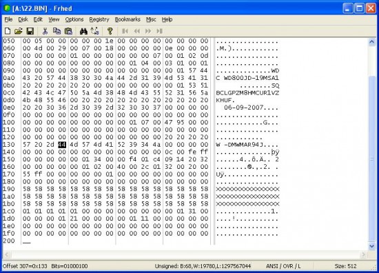

Hi there,
I have locked WD2500BEVS-22USTO and I need help with 22.bin-file, because I can't find the password. I have tried to find the answer from other threads how to read the 22.bin-file (made with "M0RBI0US" MHDD insructions), but I don't understand where password starts and ends. If someone would tell me password start and end offset from my 22.bin-file I would be pleased. Thanks.

You'll need to follow these instructions for entering the password into mhdd:
is0-mick wrote:
I actually just figured out a way to do it with MHDD.
If you convert the hex into decimal
You can then hold down the ALT-GR key, then on the numeric keypad type the decimal code (3 digits pad with 00s), and it will give you the asc character for that number :)
so the master password was:
14 24 16 17 2D 31 05 02 (hex)
which decimal is
20 36 22 23 45 49 5 2
so I held alt-gr and typed 020 036 022 023 045 049 005 002 (you need to release the alt-gr key after each 3 digits typed)
drive unlocked!
Mick
Replacing of course your password. You can use any online hex to dec converter. Just make sure you convert each double digit hex value on its own. If you try to type in the whole string of numbers at once, you'll get the wrong result.
Your password in hex may be:
32 00 20 00 55 ff 00 01
In decimal:
050 000 032 000 085 255 000 001

"Your password in hex may be:
In decimal:
050 000 032 000 085 255 000 001"
Not right one, I tried to unlock as user and master but doesn't work....

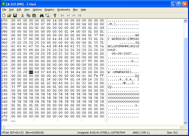

I followed the instructions and dump out 21 and 22 but what I got don't see to be the same.....

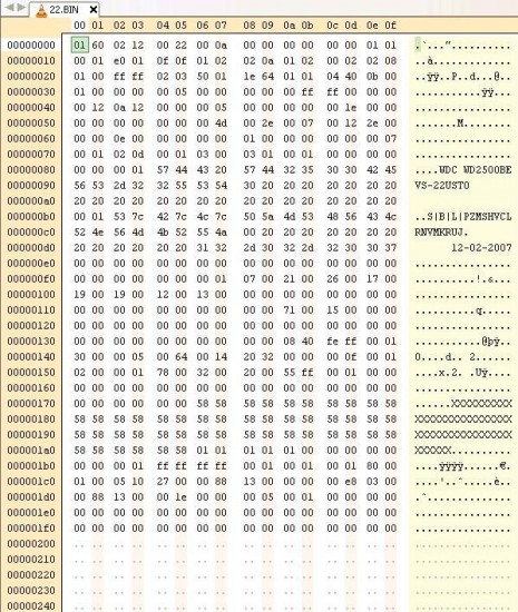

either i dont have enough privileges cus i dont see the edit button, anyway i manage to create a 22.bin file but since in running out of a cd im not able to save the file, so i wrothe the numbers with a hex editor, on one line i get 01-53-7c-42-4c-4e-50-4d-4d-32-48-38-43-4b-52-4c-56-42-4b-45-55-7c and in another line i get 00-01-07-00-3e-a8-00-42-dc-3e-24-f5-c5-6a-45-69-01-e6-0d-78-08-c9-86-f2 wich look liwe weird characters, can anyone help me to figure the password, thanks for any help.

Heres a pic of the screen, can anyone help me guess what py password is?
PostPosted: February 8th, 2010, 22:04
Joined: February 7th, 2010, 20:03
Posts: 15
Location: el paso tx

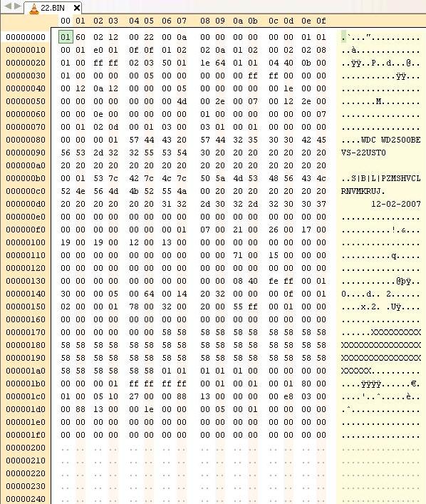

SUCKY picture , here are better ones, i know somewhere betewn lines 130 to 160 its the password, just seem to get it to work, please just help me find it, thanks for any help.
PostPosted: February 8th, 2010, 22:24
Posts: 15

Hi, i obtain this 22.bin but i don't know where is the password, and if it is master o user password. Can any one help me? Thanks!!
File comment: 22.bin
22.BIN.txt [512 Bytes]
Downloaded 3298 times

I haven't read the whole thread, but if you are ready to give up, why not buy a second HD of the same model and same firmware version. Then run the MHDD script against it, and save the BINs. Next create your own passwords, eg MASTERPWD and USERPWD. Run the MHDD script again and compare the BINs. That should tell you where the passwords are located and how they are encoded, if applicable.
In Windows you could use the File Compare command in a DOS window:
fc /b old.bin new.bin
If the passwords are plain text, then all is well. If not, then experiment by comparing passwords such as AAAA against BBBB, and so on.
