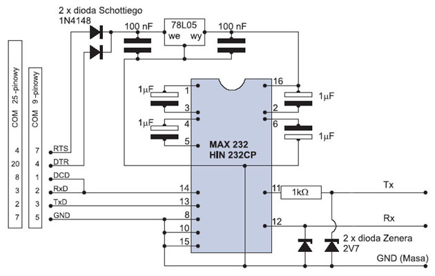

First you must have to build serial rs232 converter to TX,RX GND, you can use any data cabel from your cell phone,like i do, from siemens 35 series custom build data cable buid on this picture with max232. Be shure that you put zener diode 2V7 at the picture..Because you could burn your Tx,Rx, on HDD-s PCB.
So, when you build,get your adapter, connect it to this pins on Seagete drive.
[ '''''''''''''''| |''''''''' ] [ .. ..] ----> Rx .. Tx
You do not need to connect SERIAL-ATA CABEL
open hyper terminal or another type of terminal select Serial port example "COM1"
