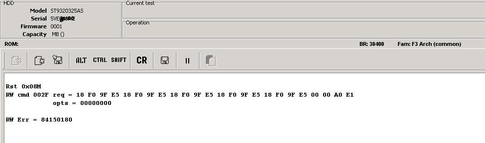

Hi to all,
Have this error in terminal,
Rst 0x08M
RW cmd 002F req = 18 F0 9F E5 18 F0 9F E5 18 F0 9F E5 18 F0 9F E5 18 F0 9F E5 00 00 A0 E1
            opts = 00000000
RW Err = 84150180
Open the disk, and notice that the platte spin, the heads go to the SA, them it came back to the park zone them the platte stop spin.
Anyone have this error ?

This error it looks again the size 0MB but this time for notebooks hard disk.
Anyone knows how to correct this issue?

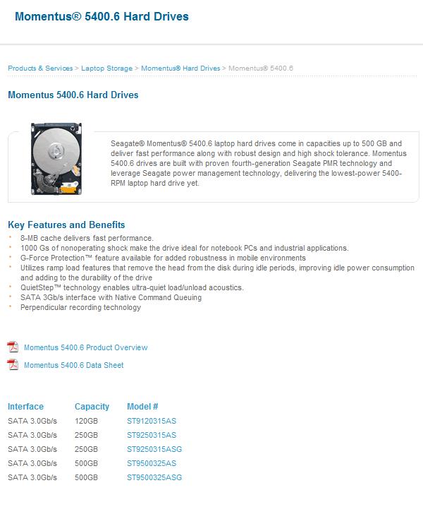

I am looking for this disk in seagate web site but i can not find it.
The disk was in a Iomega BOX.
Anyone have this problem yet !!
Any help :|

672 681 11339 2F 000000 000000 2 84150180 SPN_UP NORMAL
12005 11333 99999999 2F 000000 000000 FD FFEFF7FF SPN_UP NORMAL
12011 6 3291 30 000000 000000 1 00000080 SPN_DN NORMAL
66942 54931 1 27 000000 000000 1 00000080 SND_SRV 0501 0000 0000
0000 0000 0000 0000 0000 0001 0130 00D0
0130 0000 0000 0000 00
00 0000 0000 0000 0000 0000 0000 0000 0000 0000 0000 0000
66943 1 0 27 000000 000000 1 00000080 SND_SRV 0106 0000 0000
66944 1 0 27 000000 000000 1 00000080 SND_SRV 0501 008F 0000
0000 0000 0000 0000 0000 0001 AD6F 00D0
AD6F 0000 0000 0000 00
66944 0 0 30 000000 000000 1 00000080 SPN_DN NORMAL
212744 145800 12471 2F 000000 000000 2 84150180 SPN_UP NORMAL
225215 12471 1 27 000000 000000 1 00000080 SND_SRV 0901 0000 0000
0000 0000 0000 0000 0000 0001 0001 00D0
F802 C873 8100 E22C E5
57 E22C E5DD 0001 407F C873 8100 E22C E557 E22C E5DD 0001
225216 1 0 27 000000 000000 1 00000080 SND_SRV 0901 0000 0000
0000 0000 0000 0000 0000 0001 E22C 00D0
407F C873 8000 8106 C8
81 8000 8100 E22C E557 E22C E5DD 0001 407F C873 8100 E22C
225217 1 0 27 000000 000000 1 00000080 SND_SRV 0901 0000 0000
7F C873 8100 E22C E557 E22C E5DD 0001 407F C873 8100 E22C
225217 0 1 27 000000 000000 1 00000080 SND_SRV 0901 0000 0000
225218 1 0 27 000000 000000 1 00000080 SND_SRV 0901 0000 0000
225218 0 1 27 000000 000000 1 00000080 SND_SRV 0901 0000 0000
225219 1 0 27 000000 000000 1 00000080 SND_SRV 0901 0000 0000
0000 0000 0000 0000 0000 0001 0000 00D0
7F C873 8100 E22C E557 E22C E5DD 0001 407F C873 0000 0000
/T
F3 T>V4
LED:000000CC FAddr:0026A53F
Have any news how solve this problem?
