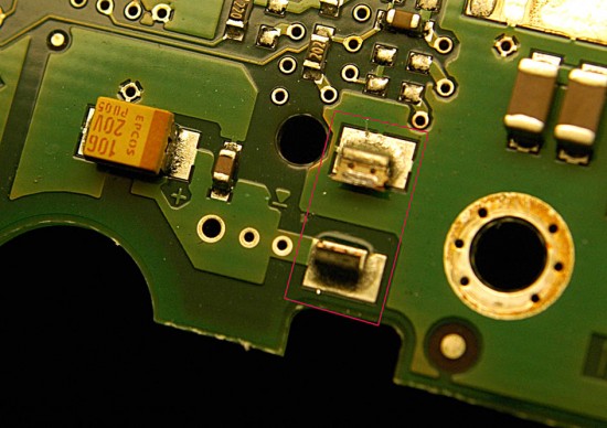

my computer stopped working and did not start until I unplugged the HDD. On 5V there is a short circuit. The resistance in one direction is 60 ohms, in the other it is OK. After some reading I suspected the particular TVS and I removed it (see the picture, purple rectangle). It did not help. I separated the PCB and there is still the short circuit. Any suggestions? There are two more parts on the same segment. So which one should I remove first :) .
The HDD is an old Seagate, I do not have the specification here, i can add it later.
Thanks.

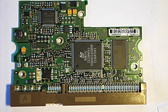

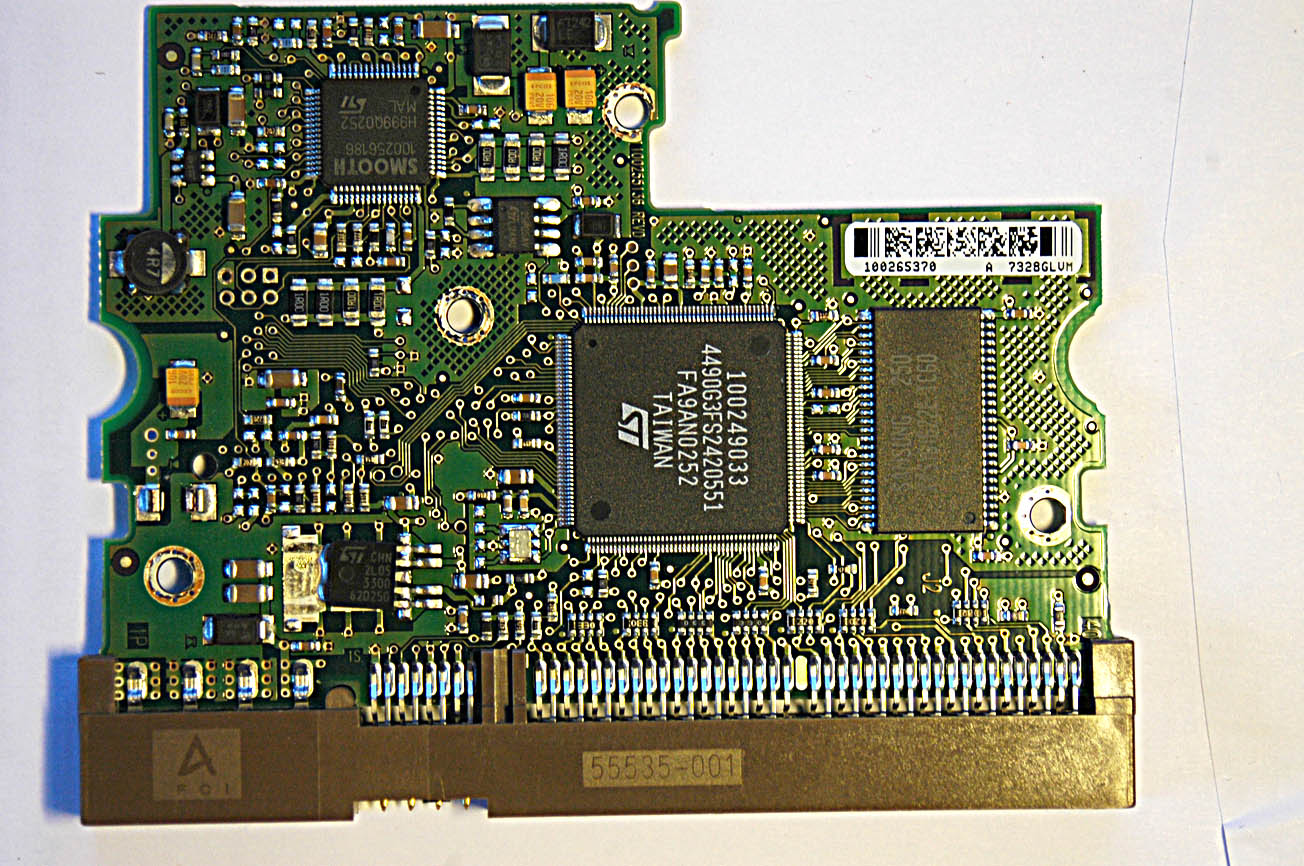

Post a pic of the whole PCB
 Post subject: Re: SEAGATE HDD short circuit
PostPosted: April 25th, 2009, 1:22
Joined: April 24th, 2009, 19:40
Posts: 5
Location: Czech Republic
no visible damage
PostPosted: April 25th, 2009, 1:40
Posts: 3235
Location: USA
Well, you didn't remove the TVS from the 5V line...
PostPosted: April 25th, 2009, 10:15
Posts: 5

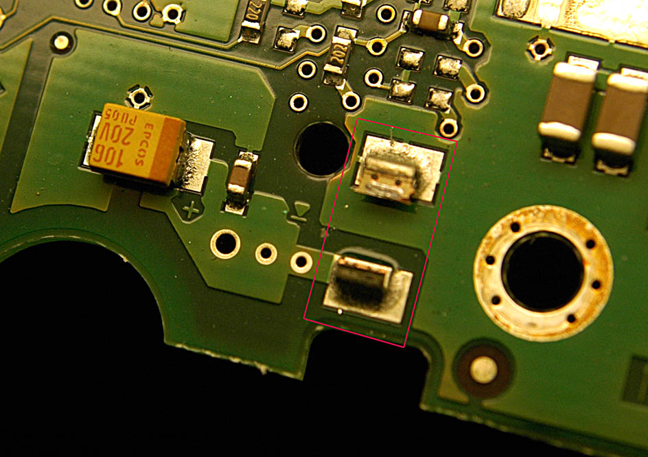

So what did I remove and where is the TVS?
PostPosted: April 25th, 2009, 10:36
Posts: 5
There is a diode sign next to the removed part.
The drive is 40 gb model ST340015A
PostPosted: April 25th, 2009, 11:06
Posts: 3235
Location: USA
That looks like the 12V TVS to me.

Thank you. Iam sorry, indeed the short was on 12V.
To summarize, there is a short on the 12V line even after removing the 12V TVS. The short is on the PCB as it is separated from the HD. What else could be wrong? The search on the forum did not help.
PostPosted: April 27th, 2009, 4:31
Posts: 1852
Location: Belgium
Probably the Smooth controller and perhaps some other components also.
Try finding another pcb; will be much easier 8)
