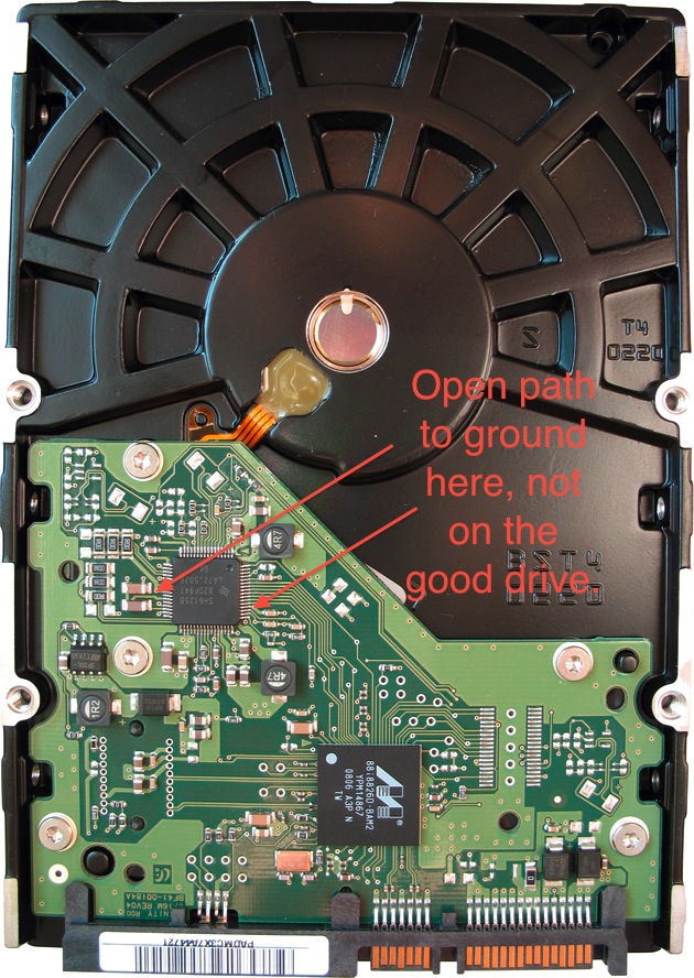

I shut my system down to plug in internal DVD drive. When powering up, I got a chirp from the PSU and nothing happened. Did that a few more times and figured something was up so I disconnected all of my HDDs.
When powering back up, this HDD was not recognized, determined that it was not spinning up (mind you, the drive was working before I shut the system down). So the platters are probably perfect. The CPU on the drive was warm, but it did not spin up.
I have another identical HD103UJ purchased at the same time, so I backed up my data on that one and started comparing PCBs. There are no burn spots on the drive, so I got out my multimeter. The diodes next to the power connector appeared to be fine (no open path going in the wrong direction).
I started comparing the two PCBs with multimeter. Found an open circuit that shouldn't be there (see attachment), as near as I can tell its inside inside the MCC, a Ti SH6125B. Would this explain the HDD not spinning up at all? How can I be sure the MCC is the culprit?
Based on what I've read here, this drive has an internal ROM so PCB swap would not work. Is there a way to hook up a TTL console to dump the ROM (since the CPU seems to work, it is warm after all), replace the PCB, and flash it with the original ROM?
Otherwise, is an MCC swap the only reasonable alternative? This probably near impossible without precision tools.
File comment: Found this screenshot online and added notes. Not hd103uj but looks identical.

Maybe this datasheet for a representative spindle motor and VCM controller chip will help you:
http://wandrew.regruppa.ru/PCInfo/TechDoc/L7250(Smooth).pdf
The parallel connected 1R00 resistors are the current sense resistors for the spindle motor (3-phase?) and voice coil motor. I'd check for a shorted phase winding in the spindle motor before bothering to transplant a PCB.
I don't know if these motor circuits are fused, but you may want to check for that, too.

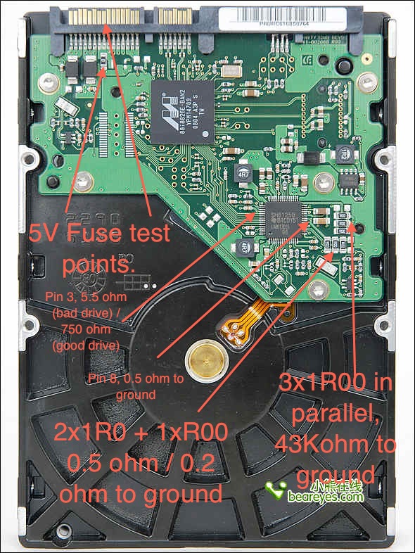

The 5V fuse (for sata 5V connector) appears to be intact as do the two diodes there (one is ground to 12v, other is 5V to ground).
See attached file with further annotations. Except for pin 3 on the MCC, everything matches the GOOD drive that I am using as a reference.
On pin 3, I get 5.5 ohm on the bad drive, 750 ohm on the good drive. Is that a 750 ohm resistor to the left of PIN 3? If so, I believe I may have confirmed that the MCC is burned out.

Sorry about my 5V/12V error.
It does look like an internal short. Perhaps one of the drivers for the three phases is shorted. Does pin 3 connect to the chip's supply rail?
I suppose you could prove that the chip is faulty beyond doubt by disconnecting the motor flex cable from the PCB. If the low resistance goes away, then that would suggest that at least one of the phases is involved.

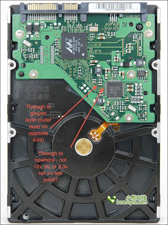

No offense, feel free to assume I'm a total idiot. Seriously.
The 12V TVS diode (furthest one to the left in the attached pic) read 150 K in one direction and 225 K in the other (it takes about 5 seconds to settle on 225 K, weird). This matches the donor drive.
The other TVS diode (for ground?) reads 2.5 K in each direction.
The suspect pin on the motor IC is the 4th one down from the top-left in this pic (I called this "pin 3" in my last post, it is actually the 4th one). I read 5 ohm on this (between pin 4 and ground) on the bad drive and 750 ohm on the good one.
The through-hole next to pin 4 doesn't seem to go anywhere, is not 12v, 5v, 3.3v or ground.
The through-hole on the left of the resistor on that trace is to ground.
