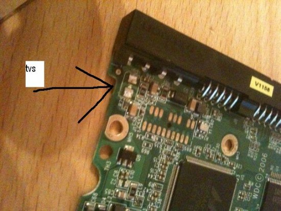

hi, i've recently fried two hard drives in exactly the same way my laptop and h/d power supply were mixed up and it seems the 19v was too much fro the fragile circuits on the externals. very stupid i know i know im not the only one to do this so i dontfeel quite as stupid as i did when i did it... ive checked out loads of different information on the net and i'm confident that i can tell the fault on the pcb. first of all my first h/d is as follows.

ive got a few old h/d's lying around from previous builds so i thought i'd dimantle them and check out for myself the internals just to get an overview of what makes them tick...(or click !).
so ive removed the pcb from the w/d drive and i can see that the tvs is split. i've checked the forum and i'm fairly confident i understand the nature of this component and so id like to try and repair/replace it. can anyone offer and advice on this. such as can i find a new reaplcement tvs..? or should i have to find an exact pcb match and swap tvs's ? ive seen that just removing the tvs could work however mine tvs is on the 12v side and a quick check on the back of the pcb shows that if i remove it, the circuit would be broken and so no power to the board.

TVS is normally open, and shorts when it activates (explodes to protect other things)

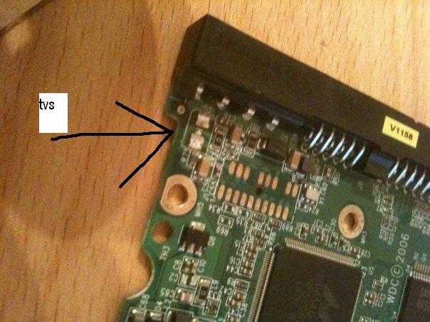

Just remove the TVS. Put power to it without the HDA connected (Saves you frying the HDA) if you see more smoke your PCB is duff. If you have no smoke you may be in luck, replace PCB onto HDA and voila.

hey guys just thought id post the pics from the pcb sugery..firstly it was a resounding success !!! dispite my limited knowledge, i made sure i had covered everything beofre i set to work but im pleased to say that it went without a hitch. i followed advice and eathed myself beofre removing the chip.and tryed the board on its own in the pc tower. the pc did not boot fully but id detected 'something ' on the slave side..so decided to connect the hd back to the pcb and booted again. it loaded fine and i could immediately found all my files...phew..! thanks everyone for your help. i now have a 1tb wd to trey and sort out but i cannot see a burned chip on the board so far but ill post anything on here. its likely that ill give it to a PRO THIS TIME.!!! HAHAH i think this one might be a bit harder !!!! just want a finall word to anyone else out thinking of doing this.. eeerrr probly best left to the experts.. i think i may have got lucky..????
File comment: this is where the tvs used to be..!!!!

well done... saved you a few bucks/quid/funt/dinaries ;o)
