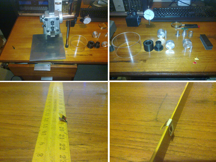

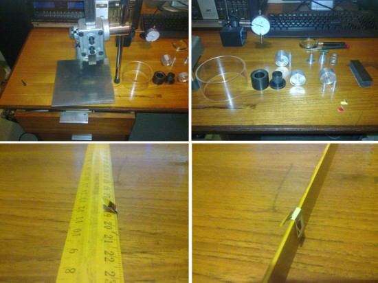

Ok, here's some pics of the tools I made + purchased mandrel press.
I cut the V cards from light card then bent them around a wood ruler which formed a square spine of just the right height to suit the thickness of the platters.
File comment: Mandrel press, machined tools and V cards

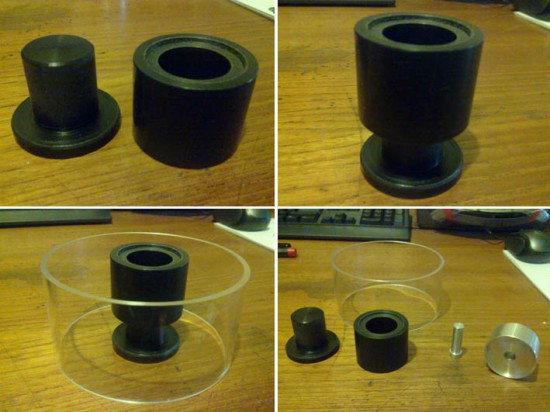

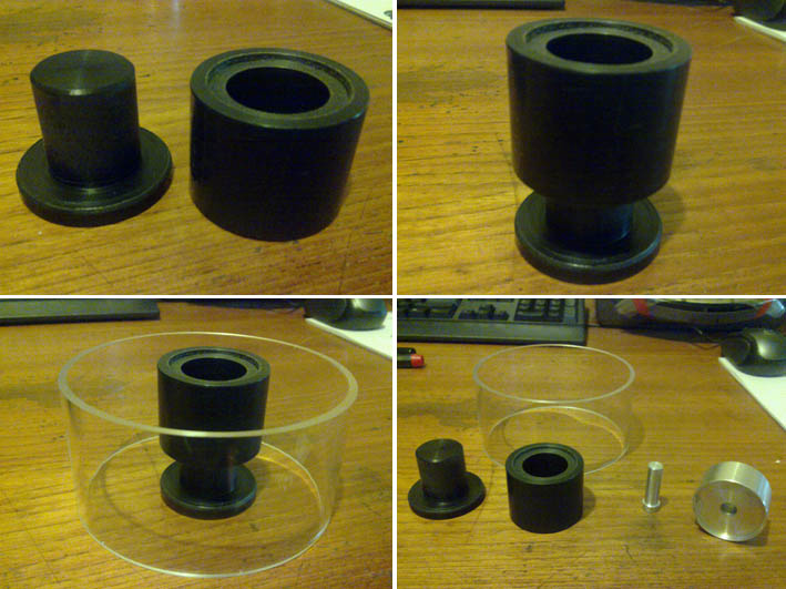

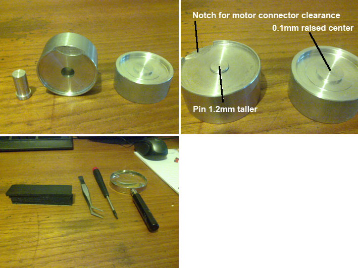

Here are some close-up's of the tools.
The clear round cylinder supports the drive base and provides a space for the rotor assembly to move into as the bearing is pressed out of the base.
The black plastic parts are a firm sliding fit on each other. The outer one slides down the inner one, supporting the rotor as it's pressed down.

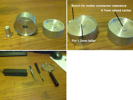

The small aluminium bearing press pin slides through a hole in the larger part, which acts to center and guide the pin as the bearing and rotor are pressed out of the base.
The larger part also has a notch in it's rim for clearance to the motor connector.[see pic further down]
File comment: Tools to press bearing and rotor from base

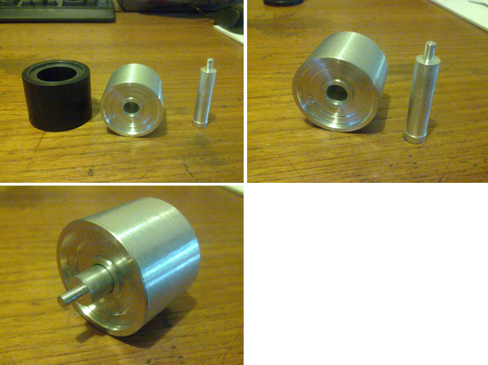

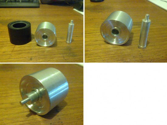

These tools are to press the bearing out of the rotor.
The outer black plastic part from the previous step is used again to support the rotor while another pin and guide is used to press the bearing out.
File comment: Tools to press bearing from rotor

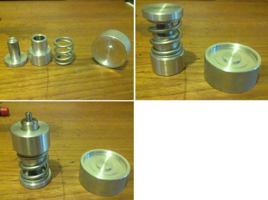

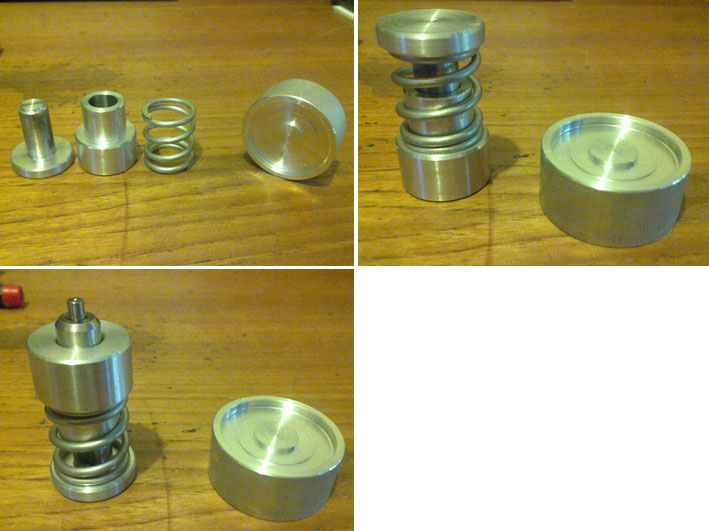

These tools are used to press the replacement bearing back into the rotor.
The bearing is first sat into the rotor by hand. Then the assembly sits in the larger support which has a 0.1mm raised center [see pic further down] to limit the bearing movement to the right height in the rotor.
The spring loaded press tool has a center hole which is a close fit around the bearing body. The center pressing pin has several mm clearance to the bearing, so initial movement will only compress the spring which holds the rotor and bearing in close vertical alignment.
Vertical run-out of the platters does not have to be perfect, but it must be very close to perfect.
File comment: Tools to press replacement bearing to rotor

For those wd1600 drives with a bearing that is shorter and recessed back in the base a bit, I used the guide with a pin sitting in it of just the right length, to limit the bearing to the right height in the base. For longer flush bearings, I used just the guide only. The hole in the guide is a bit smaller than the bearing body.
The pressing tool is the same one with the 0.1mm raised center from the previous step.
It sits on top of the rotor and presses the rotor with bearing into the base.
It's raised center also presses onto the bearing pin, ensuring the rotor does not move any further down the bearing pin.
File comment: Tools to press rotor and bearing assembly into the base.
Whilst the system worked, it is a bit "agricultural" and clumsy in some areas. There's a lot of refinement that could be done.
For any 'novices' reading this, bear in mind that while mechanical concepts are carried across most, if not all drive make/models, the exact requirements of individual drives will vary.
The WD1600JB's are probably one of the easiest drives to work on. If you try this yourself, be prepared to shed a lot of blood, sweat and tears, late nights and trashed test drives - and that will be just to get the head stack out and back in without screwing it up!!
My body count is 3 trashed drives and another 3 which whilst they still work, are virtually bin jobs due to their compromised performance + countless brain cells :lol:
There's more I'll write up on, but I need sleep right now.....
