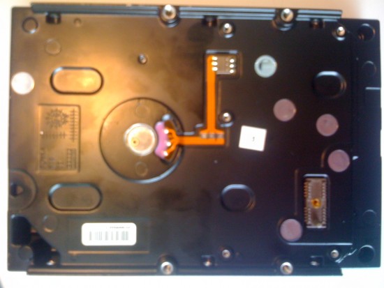

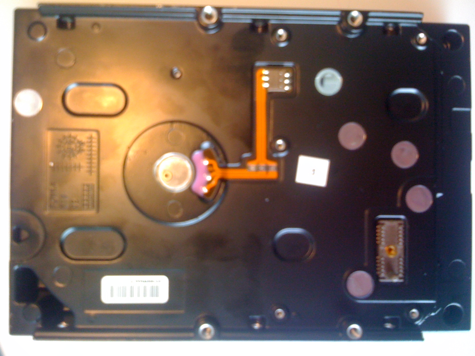

One more thing: The disk sounds like it doesn't release the heads from their parking position (no clicking noise whatsoever). Could any of you guys point me to the right access seal (which seal to remove? -> see attached photo)?
I could then try to release the heads manually under a laminar flow box (don't have a real clean room environment in my living room ;-) )? See any chances?
Cheers,
Chris
 Post subject: Re: Diagnosis? Barracuda 7200.8 ST3300831A not detected by BIOS
PostPosted: March 10th, 2010, 5:40
Posts: 2984
Its your hard disk, and your data, so its your call. But I strongly advise you read the sticky about DIY Data recovery first, and also evaluate the value of the data.
There really are so many factors to consider when opening a hard disk, and if data is invaluable to you then at this point you should make a decision as to whether you can live without it should anything go wrong...
