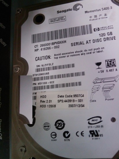

 Post subject: Momentus 5400.3 - Spindle or Stiction?
PostPosted: March 23rd, 2010, 10:19
Posts: 249
Sorry mods :roll: put this in the other forum by mistake.
What do you think, sticktion or spindle ( i guess latter). I have not worked on one of theses disks before and client wants an estimate BEFORE opening..
audio.zip [44.62 KiB]
Downloaded 583 times

would guess spindle, sounds like vcm moving heads without spin, and possibly head/surface damage from that.

What is a FW on that drive.
Is that 3.CAE by any chance?

shouldn't be, has an HP logo

How about terminal log?

yes with the LOG we can know more exatcly whats the problem.
post it.

good idea on terminal log, I didn't think it worth posting with this stuck noises. Will post later. Thanks

I wonder how the terminal log will give you more info about the actual cause of the problem...

I could not play the audio file, not familiar with the format. I am probably years behind :roll: on what audio formats are available. That's why I asked for Terminal. Almost sure it will show just Buzz, Buzz. But it does not hurt to confirm.

Seems to be an Ericsson cell phone format [Adaptive Multi Rate]
Media player classic will play it. There's some free converters on the net e.g. http://www.amrtomp3converter.com/
Sounds to me like f/w modulation of the motor drive current, trying to get the motor spinning, especially the short beeps.
Mark me if I'm wrong, but the heads should remain parked until the motor is at the right speed?
