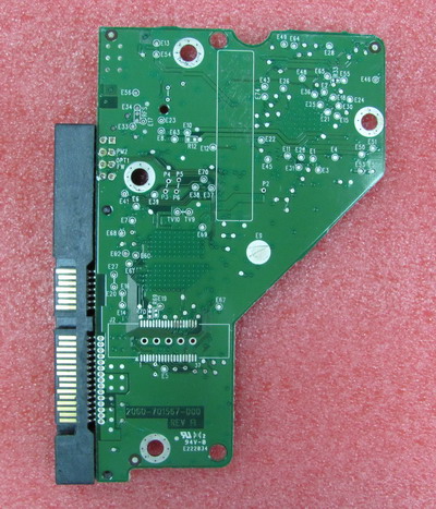

I have the following hard drive: Western Digital Caviar Black WD7501AALS 750GB 7200 RPM 32MB Cache SATA 3.0Gb/s 3.5" Hard Drive -Bare Drive
Link: http://www.newegg.com/Product/Product.a ... -_-Product
About 2 days, I was trying to connect this drive as an external hard drive (like I usually used it as), and something went wrong. 1st, I plugged in the SATA power connector for about 10-20 seconds while I left the room quickly to check onto something.
2nd, when I returned something smelled weird, and I noticed that the hard drive did not spin up.
Therefore, when I tried to find the source of the smell, I noticed that it was coming from my hdd circuit board, so I quickly unplugged the drive power connector and the data cable. I did not connect the SATA to USB connector yet.
However, later on after I did some googling, I found that the 12V TVS chip might be at fault, and that if I try to snap off the broken TVS caps, I might be able to fix the problem.
So this is what I did: I carefully took off the circuit board with a hex screw driver, and tried to snap off the R4 cap on the circuit board. Then I put the circuit board back carefully with screws. Connected the SATA power connector, and no go, the drive will not spin up. And the small part of the circuit board (where the SATA power connector connects) is still heating up.
Then I disconnected the SATA power connector, and unscrewed the circuit board again. This time, I snapped the R3 cap and put the circuit board back together. This time, the small part of the circuit board does not heat up like it did before, but the drive will still not spin up. Therefore, I cannot move all my important data off to a brand new backup drive.
I heard somewhere online that "you can replace the 12V TVS diode with an SMBJ12A from Farnell, Mouser, or Digikey".
Reference: http://community.wdc.com/t5/My-Book-for ... /m-p/12526
Therefore, I have not idea which version of the "SMBJ12A" 36 caps I exactly need to replace both of these caps that I snapped off.
These are the caps that I snapped off:

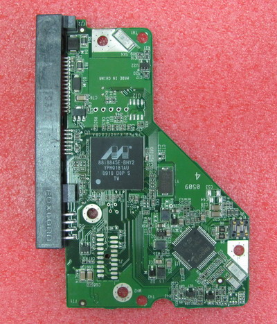

Here's a website that shows the exact picture of my hard drive's circuit board: http://www.drivestar.org/product/pcb_wd/701567.htm
Also, I was quoted $300 for the recovery (not including shipping + where they will store data).
And I cannot afford this, especially when I have to ship the hard drive, and not see the recovery in person.
And swapping the circuit board will not work for my model of the hard drive, because the main chip is the one that stores all the calibration data.
Please help me find the solution how to fix this problem with my circuit board for my hard drive, and also, if there may be any other problems with the circuit board that I will need to fix.

Your terminology is incorrect and confusing. "Caps" are capacitors, and "TVS diodes" are diodes, not caps. The circuit reference for the 12V diode is D4, not R4. Similarly, D3, not R3, is the reference for the 5V diode. R64 and R67 (?) are the zero-ohm resistors associated with diodes D4 and D3, respectively.
The fact that the 5V diode was shorted would suggest that there was an overvoltage on this supply. Did you perhaps switch the 5V and 12V inputs? If so, then removing the protection diodes would have made your board vulnerable to further overvoltages. In fact you do not say whether you checked your power supply, or its connections, so you may now have done additional damage to your board. :-(

Merely changing the diodes won't fix your problem.
I suggest you purchase a digital multimeter for US$10 and measure the resistances of the resistors, particularly R67. Do this in the absence of power.
Then, with the drive disconnected, measure the voltages at the SATA power plug at the end of your cable. Verify that they match the pinouts of the SATA power connector here:

Okay, I used my digital multimeter (with the diode symbol selected), and measured the resistance of the R64, and R67 capacitors.
They both show "002", then after about 1-2 seconds "001".
Also, I already broke off the original D4 and D3 capacitor, because I thought there would be a quick fix to the problem, because on some forums they said that you can just break off the capacitors and it would fix the problem, or atleast you can try.
I still have those capacitors left in a small plastic storage box.
But after I broke off the D3 capacitor, the part of the circuit board under the SATA power connector stopped dramatically heating. And since I first broke off the D4 capacitor, I guess I am out of luck on breaking the correct capacitor off and making the drive work without the over voltage protection...

D3 and D4 are diodes, not capacitors. If your resistors are reading 001 or 002 on the 200 ohms range, then they are OK.
The fact that your USB-SATA adapter works with your optical drive would suggest that the +12V and +5V supplies are correctly wired. However, it may be that the 5V rail is a little on the high side. You should be able to sneak your multimeter probes into the Molex plugs. Yellow is +12V, red is +5V, black is ground.
BTW, whenever I suggest removing a shorted diode, I always warn people that the affected supply rail will no longer have any overvoltage protection. This means that you must ensure that your power supply is good.

The new TVS diodes won't save you now. The damage was already done, either in the first instance, or later when you exposed your unprotected drive to the same overvoltage that killed your 5V diode.

I would not be so sure about that. The Western Digital Caviar Black hard drives are pretty good, so I am not willing to give up now.
Because today, I was able to repair my other laptop hard drive, after I tried to do a circuit board swap with the same model of the circuit board as my original laptop hard drive circuit board.
Once the replacement diode's will come by mail, then I will replace the original diode's with butane soldering iron, then purchase the 3.5" external hard drive case (not a cheap $10 USB to SATA converter adapter cable), and see if the drive will work.
If it will work, then I will backup all my data off that hard drive, and then after I will purchase the new 3.5" hard drive, I will move all my files there.
Then I will just sell this hard drive on eBay, because after such a problem, I do not think I want to trust this exact model of the hard drive anymore. I was originally off much better with the Western Digital Caviar Green 500GB SATA hard drive, which I never before had any single problems all all, then after about 10 months, I decided to upgrade to a larger drive, because it was on sale for $20 less than original price on Newegg.com, but now I think I rather stick with the 500GB hard drive model than this one, even though this hard drive includes a 5 year limited warranty on parts and labor. And if I will be able to get replacement screws, then after formatting, I might be able to send the original one back to Western Digital, and get a replacement, just in-case.
Thank you very much.
