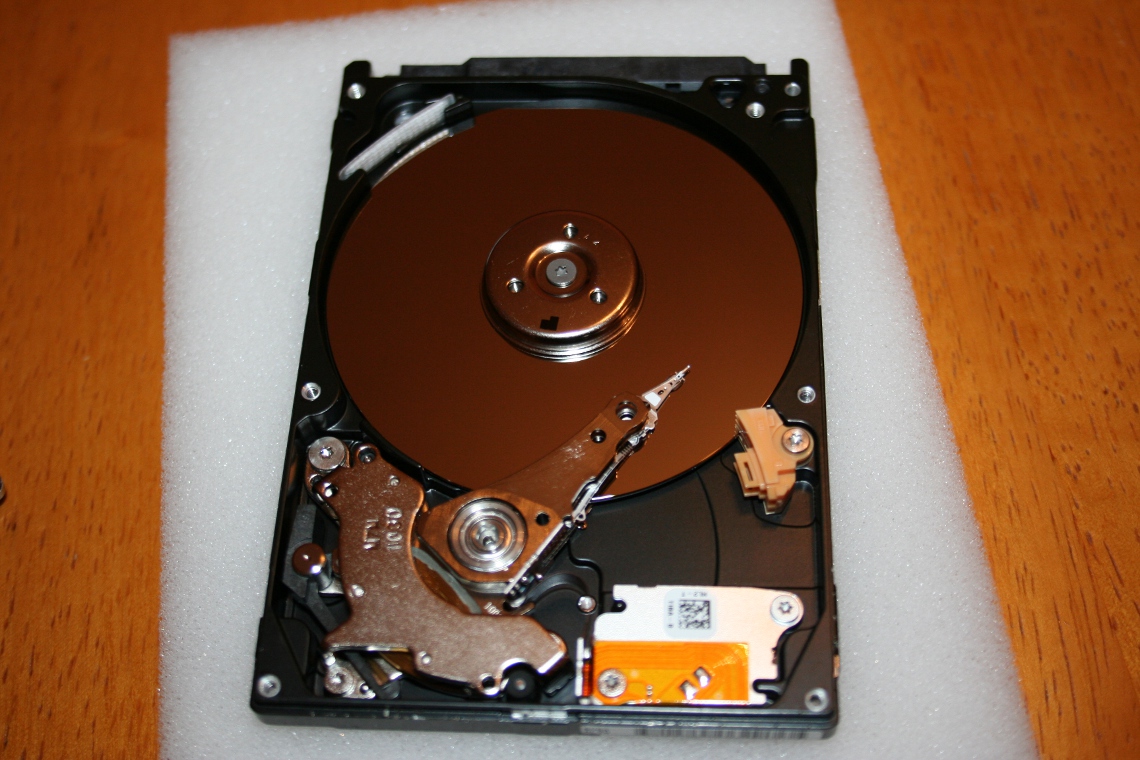

My laptop's 250GB Seagate drive stopped spinning up about a month ago and, although I've got a replacement drive (Toshiba this time), I want to see if I can get some of my data off the Seagate.
The drive doesn't spin up at all although I can hear a faint repetitive (about 1 a second for maybe a minute) beeping noise from the drive when it's powered up.
I've tested the diodes and they're ok.
Today I've just found a You Tube video which demonstrates exactly what I'm hearing so thought I'd ask everyone on here:
http://www.youtube.com/watch?v=ISTN_64MVnA
Any ideas what the problem might be? Head or spindle stuck?

Could be either, or both. In any case, it is likely that the recording heads are not correctly parked, and attempts to power the unit will create resistance between heads and media surface - almost certainly damaging both the heads and creating multiple surface errors.
Best case scenario - heads stuck on surface preventing normal operation
Worst Case scenario - spindle siezed
If data is important to you then the only real option you have is to get a accurate diagnostic from a repuable DR firm.

Few types of faults arise
1: Stiction
2: Spindle seized
3: Heads jammed between ramp and platter (load/unload ramp)
plus a few other reasons

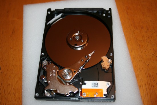

I did mean to report back what the actual cause was ... but I forgot :wink: Still, only a year late! :D
I opened it up and, as some of you suggested, I found the head had stuck on the platter (see attached pic). I managed to gently release it so the head was able to park and the platter could spin freely.
The drive would then spin up normally and was then visible to the laptop but it would not boot (actually, it did manage the 1st time to get to the Windows 7 dual boot screen (it took forever to get there so it wasn't very happy) but couldn't boot any further - subsequent attempts failed to get even to that point)
Anyway, my replacement drive has been working fine for nearly a year but I still haven't made a pretty clock out of my old one ... maybe in another year :lol:
