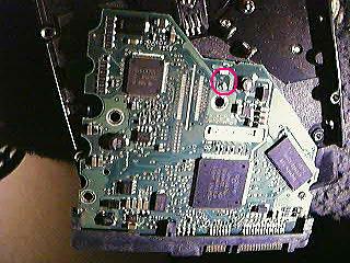

OK, no big deal, I hosed the flash chip through the use of fCCCC or vCCCC, whatever.
Now I see what others meant when they said "be prepared to destroy a lot of drives." The two drives that got hosed the same way were a ST920217AS and a ST3120827AS. Both had one flaky head, although in the case of the ST3120827AS I'm more inclined to believe that a scratch spanning the entire surface of one platter is to blame.
OK, I have ponyprog, and the schematic to build the simple two resistor I2C flash programmer. I have the ROM for the ST3120827AS but not the ST920217AS, and will build and flash. From more than 10 hours of research, I have come to the undeniable conclusion that only a physical hardware flash can fix a MASKROM being displayed... it would have been nice if someone had simply said so.
(For later readers, the TTL serial interface to the drive cannot be used with ponyprog: 3.3V vs. 5V. Use a regular 9 pin COM port for ponyprog. http://www.riccibitti.com/quickdesigns.htm)
I hosed the ST920217AS after trying to disable the last head (T>YE1, T>w, invalid cert code, then the ignorant issuance of fFFFF thinking it would reset the ROM from the reserve tracks).

OK, the ST3120827AS had one bad head or surface. Even if I fixed the ROM, it would still have the bad head or surface, so I gave up on it.
I cannibalized it for a part.
I had an ST3160023AS with a shorted part, right before the motor connector. Would short the computer's power supply right down. This was the same board, without the shorted component. Replaced with the good one from the ST3120827AS board, and it fired right up, working perfectly.
I am curious as to whether this part, (the removed part location is circled in red) is a diode (my guess) or a capacitor. Anyone know? Sorry for the lame image quality, this is the only camera I have that does closeups that isn't in use elsewhere.
