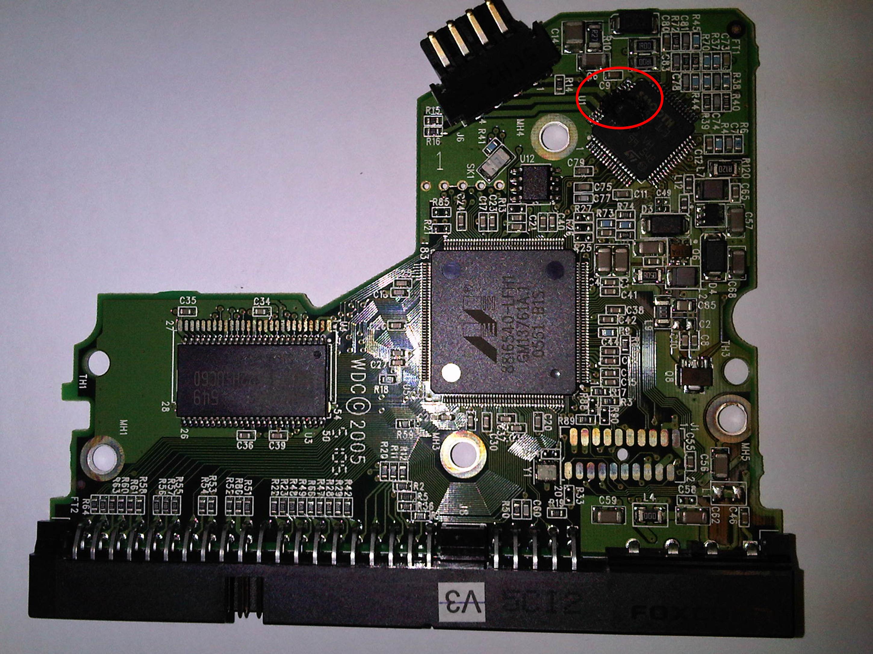

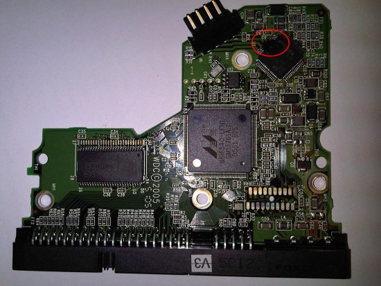

Im new to forum and hdd recovery so need any advice you can give me.
I have a WD3200BB - 55KEA0 (DCM:HSBACAJCA) which i used as an ext drive.
After working fine I have found that next day it now clicks repeatedly when powered.
The ext psu of the ext drive enclosure also flashes on/off repeatedly (LED).
I removed drv from enclosure to check TVS's as described on post :
seagate-320gb-st3320820a-pcb-swap-t12189-20.html

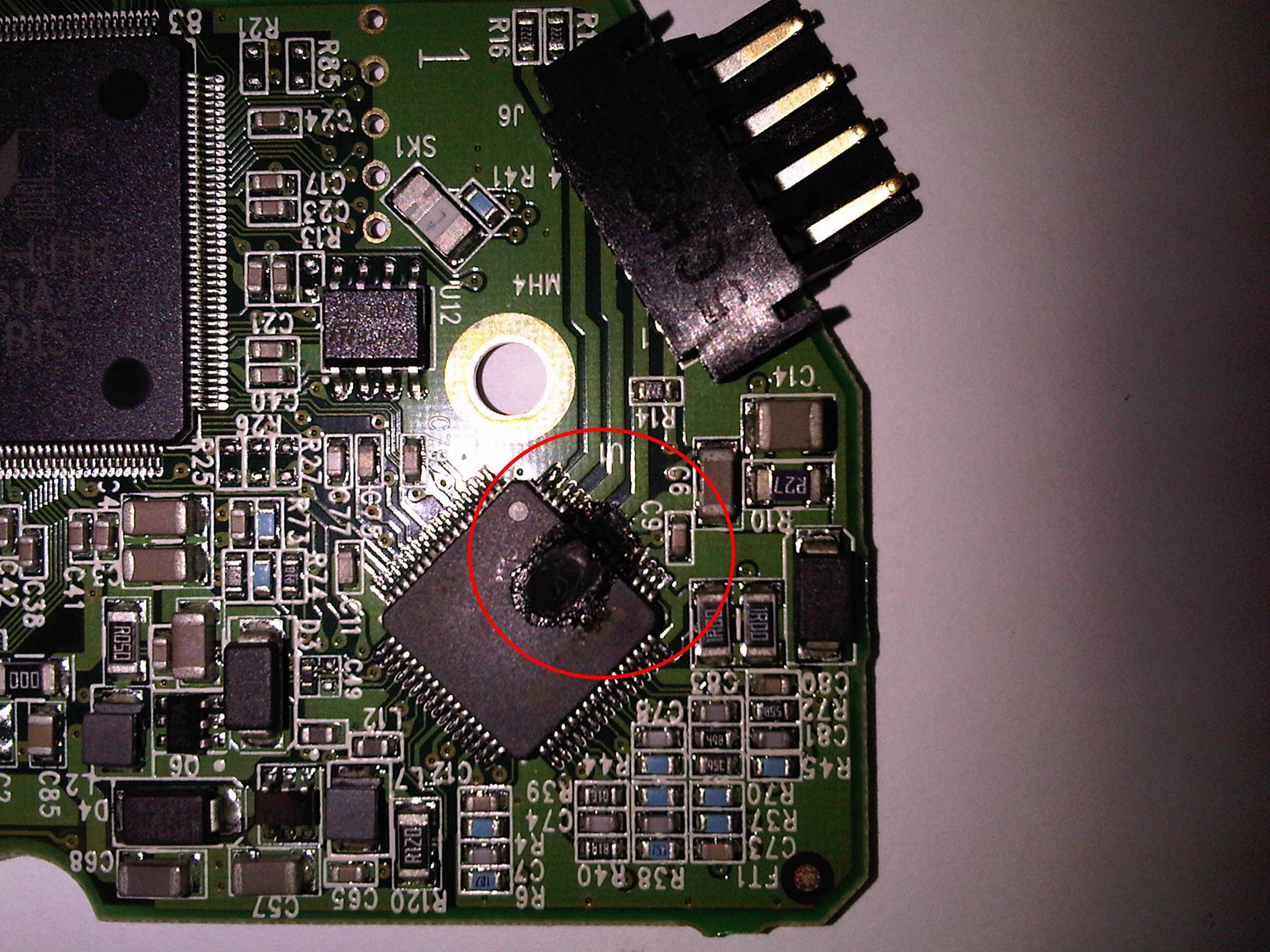

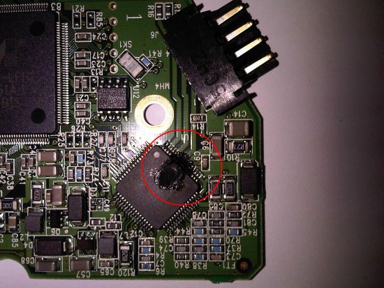

Then once I removed the pcb I found the 'smooth' chip has been fried.
PCB no.: 2061-701314-000 AF
Please advise what options are available to me?
Many thanks in advance!!

Get a donor PCB. Swap the eeprom located at position U12. Cross ur fingers ( u may have damage to preamp, in this event swap wont help and will kill the donor PCB ) and fire up the drive.
Also u can look at OnePcbSolutions ( google em ) for donor purchase and moving the eeprom.

Gl Nird. The problem in ur case is that TVS did not work. The spike went through , had its way with ur smooth , and power was still on, since u heard the clicks, not the regular dead silence. So imho chances that pream is bad are high =(
