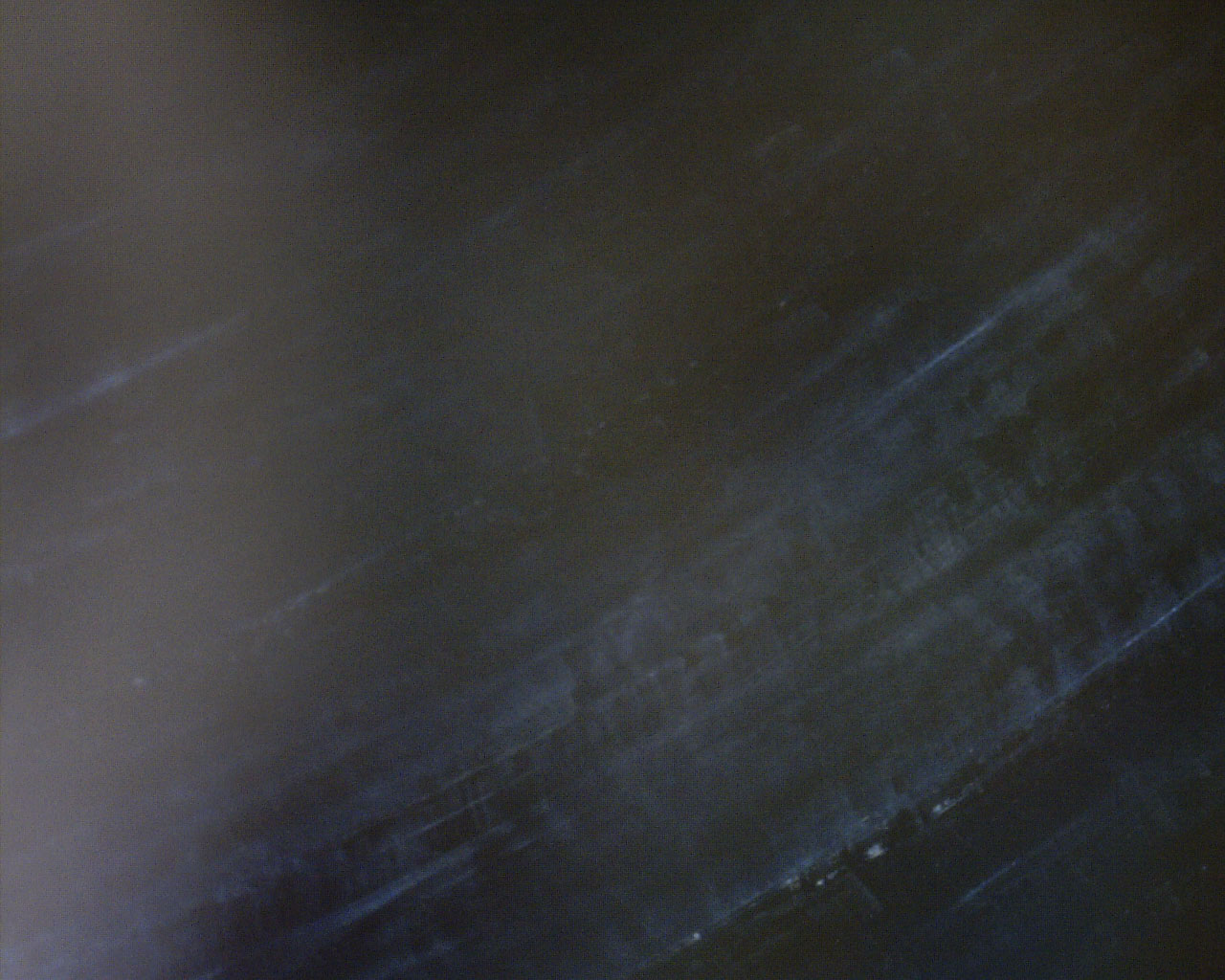

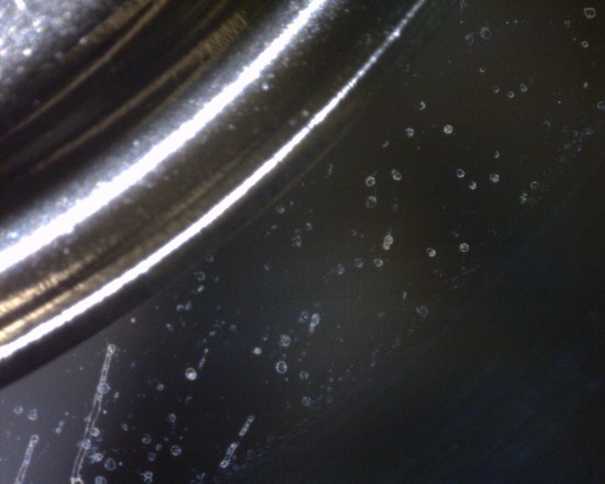

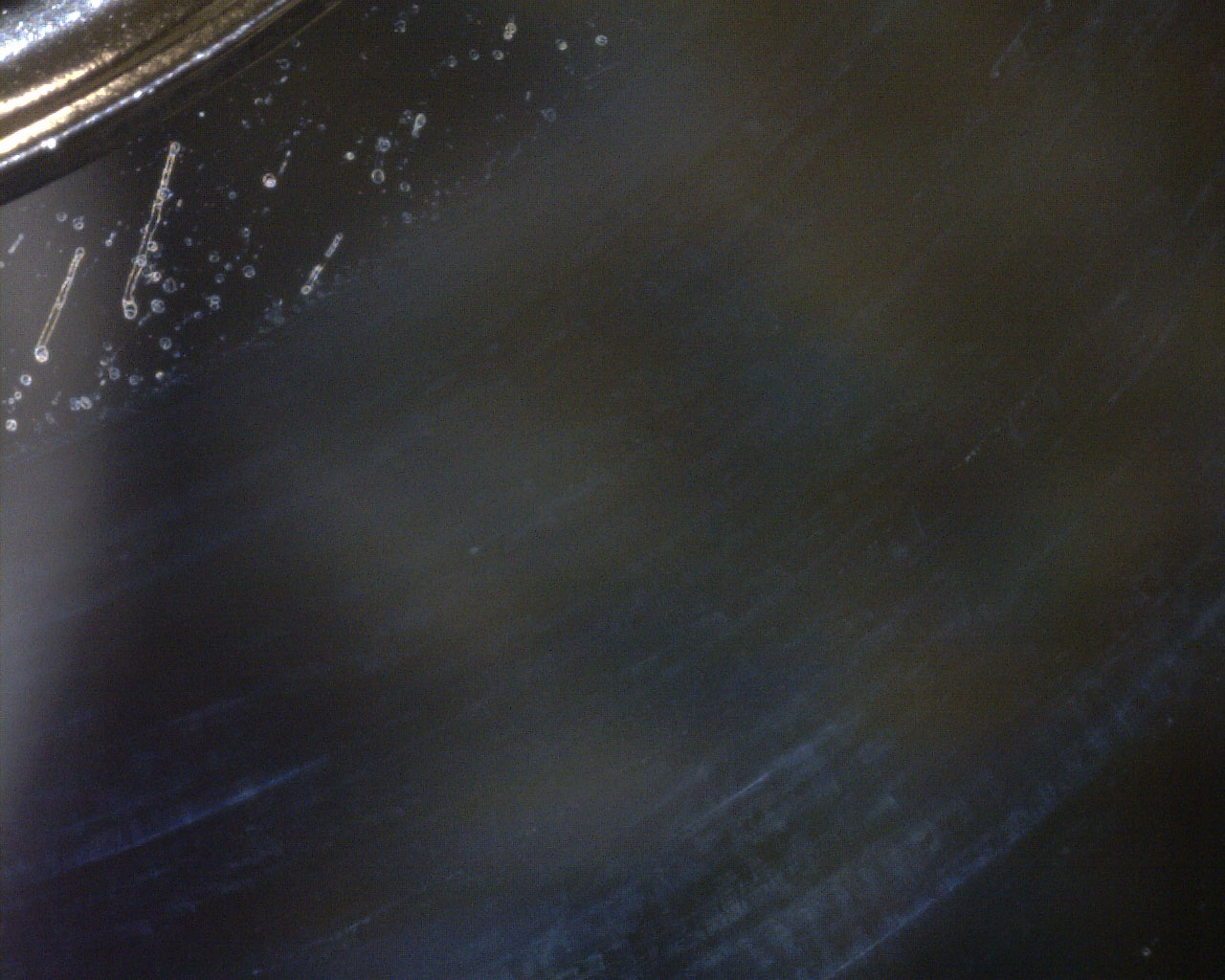

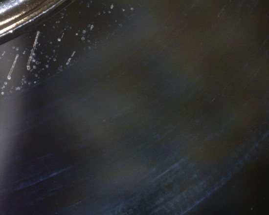

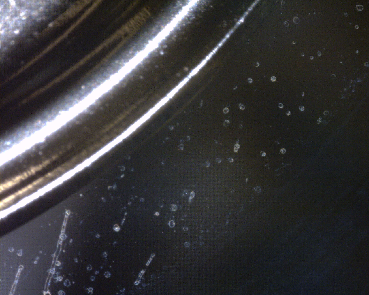

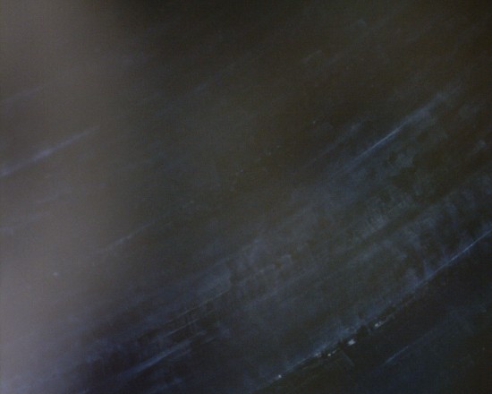

We've a hdd with very dirty platter. It seems that it's teflon deposit, not ?
What do you think about ultrasonic bath to clean platter ? Do you know some ultrasonic bath system ?
What do you think about 3M IPA product to clean platter ?
You find in attachment pictures of the platter.
What do you think about this ?

Looks like someone got some crud on the platters and subsequently turned on the drive.

I don't think that's depositing. It looks like scratches to me, caused by the heads traveling over the dried spots of whatever-that-is at high speeds. Have you verified that you can actually remove any of it?

Yes, we can clean on the first platter but we don't see the other side but we think this is dirty too.
So, this is the reason, we search some solutions to clean other invisibles sides by ultrasound for example or vibrations.

Thats just dirt imo. Smbd cleaned the platters with alcohol or smth NOT in a clean room environment. Cause of that the alcohol evaporated and left dirt that fell on it during the application. From the looks of some of those dirt streaks - the drive was powered on after.
