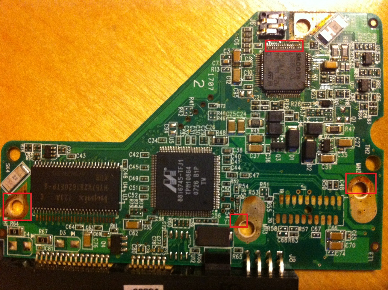

I have a WD5000AAKS that isn't recognized by my PC. I believe that I caused the short when I attached the graphics power to the HD (doh!). The PCB shows several burn marks around the screws that hold the PCB to the drive. These screw holes also appear to be part of the circuit - maybe ground points?
I am not certain if the drive, pcb, or chips on the pcb are damaged.
I am looking for a set of logical steps to follow to try and determine where the failure may be.

Can you show us a photo of the damaged area? Does it involve TVS diodes D4 or D3, and resistors R64 and R67?

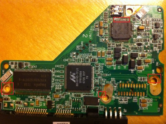

Attached is the requested picture of the PCB. I highlighted in red where I visably see discoloration.
The R64 & 67 look intact but I can't be sure I'd recognize what bad looks like. They both have a readable white box on them :)
To answer Vulcan - Isn't recognized I mean, I plug it in and nothing. No sounds, no action from the PC, just nothing.

The discolouration is just normal oxidisation. I can't recognise any burn marks.
Did you remove diodes D4 and D3, or were those locations already vacant?
Unfortunately the flash data are internal to the Marvell MCU, so a DIY board swap is not feasible. U12 is wired for an external serial flash memory, but this location is vacant. Your only real hope of recovering your data, without resorting to professional data recovery, is to attempt to repair the board. That may not be as difficult as it sounds, if you have a digital multimeter (~US$10).
Some board suppliers offer a firmware transfer service (US$10 - $20), but they will probably need to know whether the MCU is still alive.

Did you buy that drive in used condition?
It seems like motor IC was replaced before and both TVS chips are gone.....

Normally the board would be protected by a 12V TVS diode at D4 and a 5V TVS diode at D3. I believe harddrivespecialist is alluding to the discolouration of the SMOOTH chip's pins. However, its YWW (Year / Week) date code, 726, matches the date code, 0726, on the Marvell MCU, which suggests both may be original components.
The tests I would do would be to first to confirm that there are no shorts on any of the supplies, and then power up the board on its own and measure the actual voltages.
Set your multimeter to the 200 ohms range and measure the resistances of R64 and R67. They should be close to 0.
Then measure the resistance between ground and each of the +5V and +12V pins in the SATA power connector.
Measure the resistance between the corner pins, 1 (Vdd) and 54 (Vss), of the hynix SDRAM. Pin #1 is identified by a dot on the PCB and is at the top right corner of the chip. Also confirm the resistance between pins 4 (top left) and 8 (bottom right) of the vacant location at U12. Both devices appear to require a +3.3V supply.

Measure the resistance between the metal tab of the transistor at Q4 (below the SDRAM), and each of its end pins. Also measure the resistance between ground and each of the end pins. Q4 appears to be the pass transistor for a linear regulator.
Measure the resistance between ground and each of pins 2 and 4 at the 20-pin preamp connection points at J1. These are the +5V and -5V supplies for the preamp.
Below the SMOOTH chip you will find two inductors. These are the black components above Q3 and to the left of D1. Measure the resistance between each inductor and ground. Also measure the resistance of R45 (R050) to the left of the inductors, and R48 (0) at the top right corner of the MCU.
The next step depends on what you find after completing the above measurements.

Just to be sure, R45 is the black component immediately above "R45", not below it. It should have a resistance of 0.05 ohms. I expect that it is the current sense resistor for one of the DC-DC converters. If I'm right, and if it is open (OL), then the associated supply has a problem. It's load would probably be damaged, too.
I can't be sure from the photo, but I suspect that R45 is part of the Vcore supply for the MCU. Could you test the resistances of the 4 nearby capacitors (C24, C25, C37, Cxx)?
