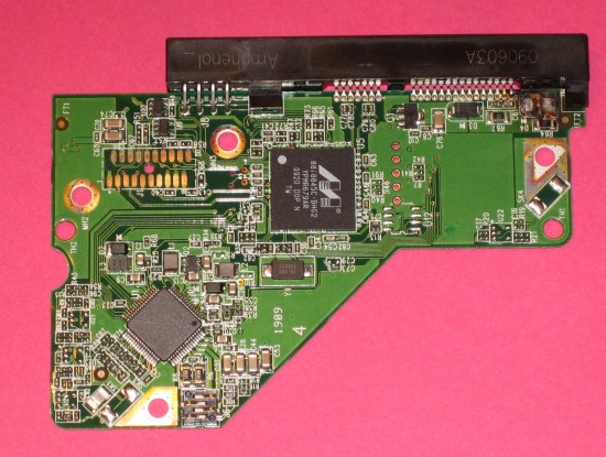

I wonder if anything can help me with the HDD problem that I have at the moment? :(
I have a 1tb Western Digital Elements hard drive which I bought under a year ago. I stupidly used a 16v adapter for my scanner by mistake on the the external hard drive which only needed 12 v. :oops: It seemed to work ok without any problems until Saturday night when it suddenly disconnected. I checked the drive and it was hot and there was a burning electronic smell coming from it. I tried reconnecting the adapter but it didn't work so I plugged it on the scanner and it didn't work either. I then tried to use the correct 12v adapter on the damaged hard drive but nothing but when connecting to another external HD it works.
The next step was to disassemble the HD from the caddy/enclosure which I done and I then purchased a IDE/SATA to USB kit to test the damaged drive. Unfortunately nothing worked but when I connected it to a spare 80gb IDE drive that powered up so I kind of thought the kit wouldnt be at fault. I had a feeling that the PCB on the HD has burnt out the TVS diodes as the electronic smell is coming from there as well.
My question to members is would it be worthwhile to
a) to purchase a similar drive from ebay and swap boards round? (Though I heard this is a extremely hard thing to get right?)
b) try to get a computer shop/electronics/tv repair shop to fix the TVS diodes if that is the problem?
c) snip or try and cut out the TVS diodes to get it running long enough to get the data off? Bearing in mind I have over 800gb of data how safe would that be? Also I read from forums even simply cutting the diodes and removing them may not make the PCB work as u may need to solder a wire in order for it to work?
My drive had a 1 year warranty which I have probably invalidated but I am not worried about that just want to recover the data from it. I have a lot of sentimental stuff on the drive. :(
If anyone has advice or could help me I would be grateful?

I have finally removed the last torq screw after searching 3 hardware stores.
And please find the photo of the PCB below.
I presume the one marked D4 on the top right hand corner is the 12v TVS diode and the one marked D3 is the 5v TVS diode?
Would the removing the burnt D4 diode make the drive work long enough for me to copy the data to another drive or will you need to solder a wire across it?
I am also concerned that the connectors top left corner may have been burnt as they looked discoloured?

The burnt out diode was getting loose so I removed it. And when I removed it I saw that heat had burnt a little bit of the circuit board behind it. I also wanted to check that the HD was okay before I sent the PCB to be fix by a electronics guy on the internet. The hard drive seems okay. :D
A bit premature as we can see below as I think I might just have done something to the board as when I reconnected it again it made a popping noise and smoke came out of the PCB again. I have enclosed another photo for you guys to look at and hopefully I haven't damaged the HD or the PCB.
Hopefully the HD is intact and the electronics guy can replace the diodes and make the PCB safe so I can access the data from it.

jan5ki wrote:
I have been quoted £399 plus VAT @20% to recover the data from a UK data recovery firm near me. I have contacted some electronics firms to see whether they
can replace the diode?
The whole job shouldn't have cost you more than US$50, including freight.
The D4 diode can be obtained from Farnell. It is an SMBJ12A. Your local TV/AV repair shop could have replaced it for you. You may also need to bridge R64 with a wire link or a blob of solder.

To everyone that has been reading my threads I received the e-mail from the repairer and it is as follows?
Yeah , you did have a very burnt area of PCB there,
There are several circuit (copper) layers within the thickness of the PCB and one was partially shorting(6-10 ohms ish) to ground (one of those layers is a ground!) along with the carbonisation it all spelt trouble .
Anyway after some very delicate surgery and a microscope I've already got rid of the partial short and just need to reinstate missing components (the diode for one)., and some cable bridging over the damage
The fix may not look pretty when it's done cos I've had to remove a lot of carbonised PCB, but it should work in the end.as I can now see a more normal load impedence on that supply
The parts are already on their way today (preordered yesterday in anticipation of this PCB arriving) haven't arrived as yet - but are guaranteed before end of today (UPS)
So yes it's looking okay so far, but obviously not finished as yet
Yeah the burning would be that 'early' short on the pcb, if there was damage further downstream then the burning would have been there instead, PSU sees the short immediately and the tracks/area starts to heat up as the PSU battles to overcome the short
With you saying it did work when you first checked it means the circuitry downstream should be fine. Only reconnection will tell, although when I first looked at it there was a severe short caused directly by this 'early' damage
