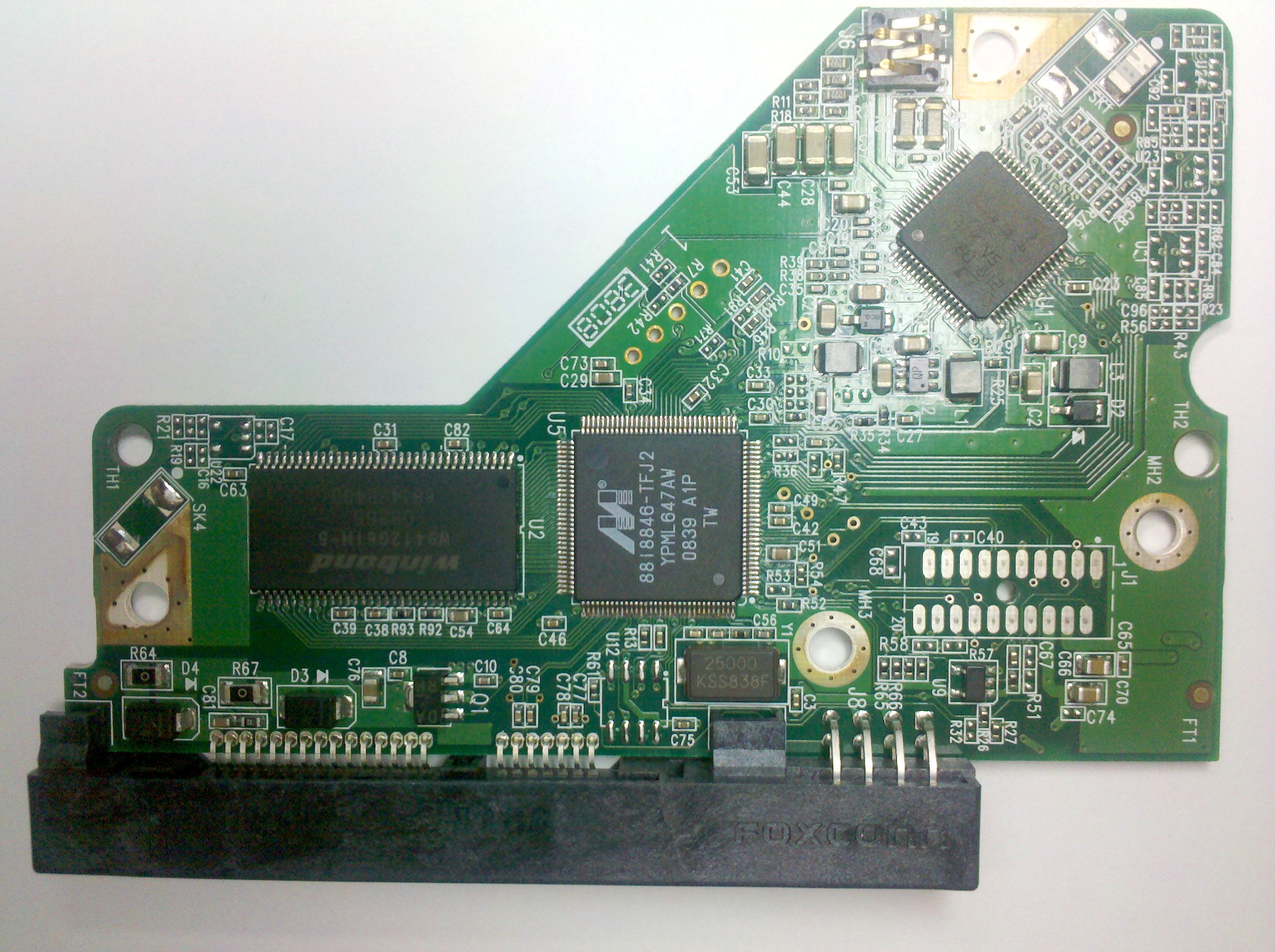

A little bit of history, the drive was my best friends. He never messes with components. He disconnected it when he was having problems with other hardware. Then not knowing what he did, he plugged one of the smaller molex connectors inside the SATA jumper slot. Needless to say it never started back up. So I found an exact pcb but when I installed it nothing happened, windows will recognize it but will not initialize it and the bios does not recognize it properly. Which I assumed is because the pcb I have isn't an exact match via the DCM# and such. But was wondering if anyone has a donor, or if anyone could assist me in what I should try next. Again any and all info is appreciated. The data on the disk is important for his business.

If your PCB does not have an 8-pin serial flash memory chip at location U12, then you will need to very lucky to find a compatible PCB. This is because each board has unique "adaptive" information that would need to be transferred to the donor. In your case the adaptives are internal to the Marvell MCU (big "M").
ISTM that your friend probably damaged the MCU by applying an excessive voltage to one or more of its I/O pins. BTW, when you say that "nothing happened", does the drive spin up? If not, then it must be identifying itself using a factory alias (?), in which case it may have more serious issues.

Looks like I do not have a bios chip at location U12. Would that mean the bios is integrated into the PCB's Main Chip IC? Is it even possible to exchange those?

Has he even checked the TVS?

The OP writes that his/her friend "plugged one of the smaller molex connectors inside the SATA jumper slot". This suggests that power was applied to the MCU's I/O pins. No TVS diode will protect the drive from such a mistake. However, it could be that the friend has not explained himself correctly, so it may be worth checking the diodes, just in case.

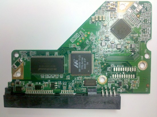

Alright, forgive my ignorance but I would test both the D3 & D4 TVS diodes? Then the r64 & r67 resistors. Now would using a multimeter at the diode testing setting be ok? And should I test with voltage running through the board? I just want to make sure the board that isn't running doesn't have a blown TVS diode. I know there is a slim chance in hell it might be them, but I've never tested them before, and what should I be looking for voltage wise? Like I said if I should move this to another section i will. Just trying everything before I send it to someone here. As always thank you for the help.

While setting my multimeter to its diode testing mode:
D3 = .405v (where the black is on the cathode / striped side and red is on the anode)
resistor R67 = 0
D4 = .519v
resistor R64 = 0
This is without power running to the board. Should I assume the TVS diodes are functioning correctly. Or should I apply power to the board and test again? I just don't want to further damage the board if I have to. Thank you for all the help everyone.
 Post subject: Re: Wanted: Western Digital Caviar Green WD10EACS-00D6B1
PostPosted: May 15th, 2011, 10:58
Posts: 17335
The resistors and diodes are OK.
BTW, resistance measurements should be performed with power off. This is because the meter injects its own small current into the component being measured.
One more thing you could do is to test the voltages at the jumper pins. Do this with power applied. Set your meter to the 20V range, connect the black probe to SATA power ground or to a screw hole, and use the red probe to test each of the jumper pins. The bottom pins appear to be grounded, but I expect that the upper pins should be tied up to the Vio supply. You can test the board on its own, ie there is no need to install it on the drive.
