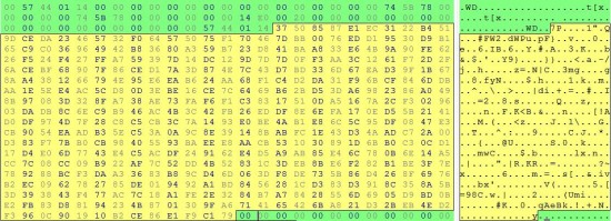

That did not work :(. I replaced that sector with another sector that I got after unlocking the drive, I got the drive unlocked but I cannot see my data. I would try again but with a sector with locking information for which I know the password. I noticed that that data are encrypted in 16 bytes blocks. any ideas?

Could we see the two sectors?
 Post subject: Re: Unlock WD My Book Essential
PostPosted: May 29th, 2011, 6:53
Joined: May 14th, 2011, 17:44
Posts: 22
Location: United

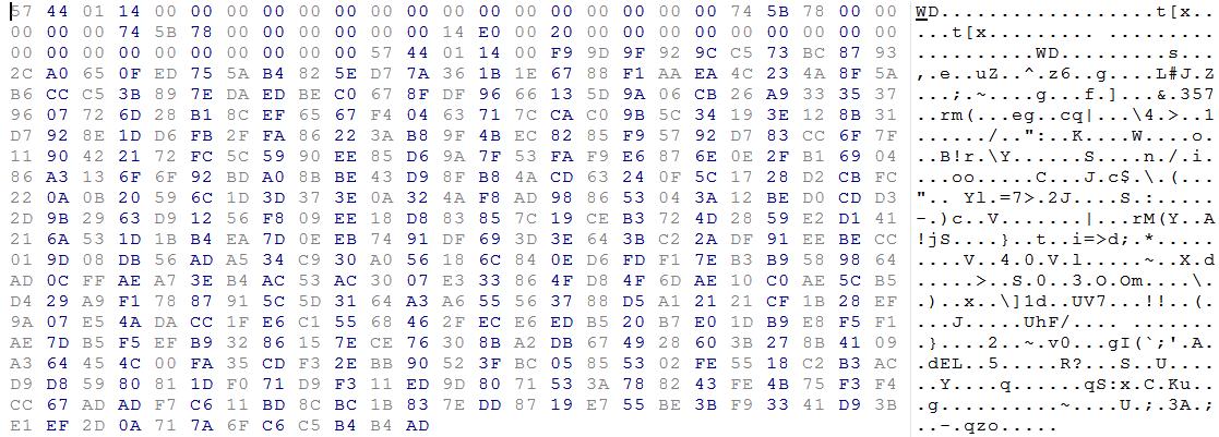

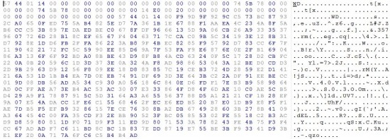

Thanks for your interest, as you see in the pics the difference is in the last 448 bytes of the sector. The sector starts with 'WD'.
File comment: VCD sector unlocked
File comment: VCD sector locked

Replacing the sector with one for which the password is known did not work either. I guess the encryption key is stored in those 448 bytes, anyway I ran out of ideas hopefully someone here can provide some ideas
