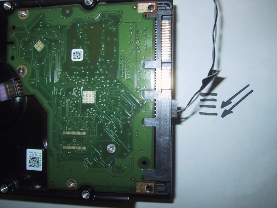

I have a Apple branded Seagate 1TB ST31000528AS with Firmware AP24 that does not transmit via terminal connection. A comparison to a none branded Seagate 1TB drive to thew Apple branded shows the MCU is different a LSI instead of ST. This 1TB has the Apple cable for temperature monitoring connecting to the terminal output.
Is terminal mode disabled on these drives?
thank you
Can you post a picture of this?

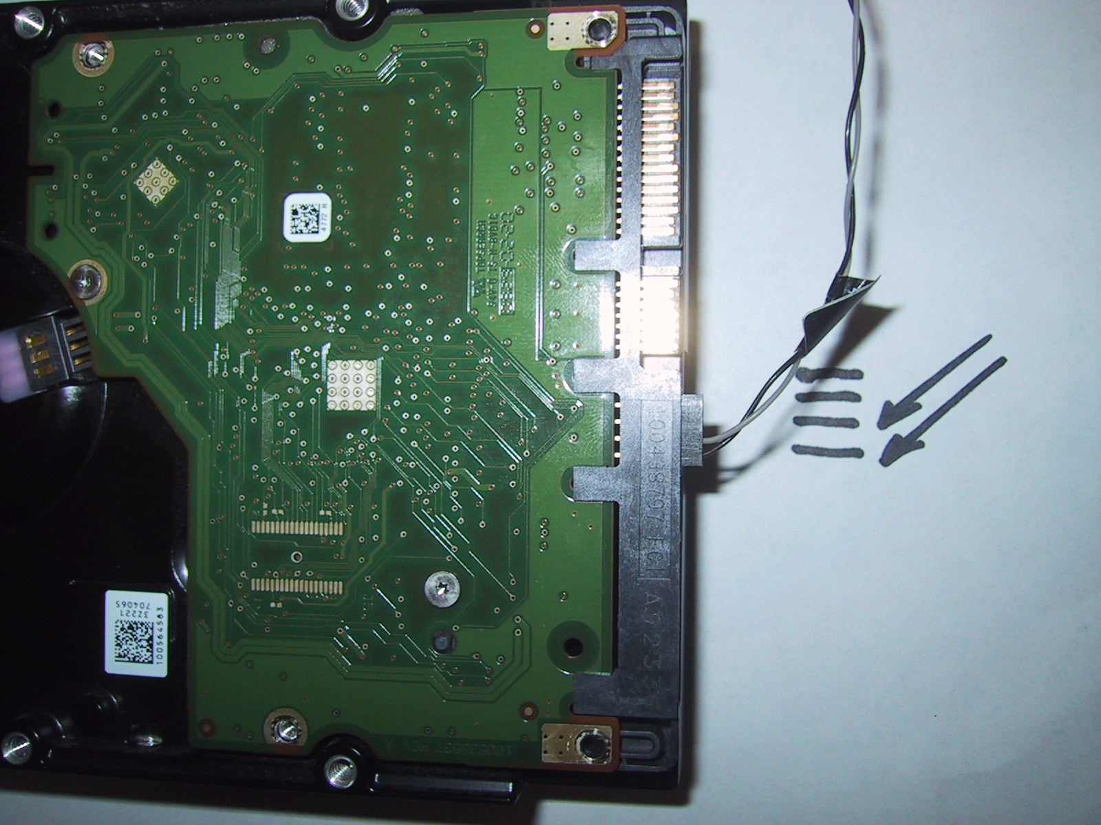

DRC,
here are the images of the Apple Seagate 1TB hard disk
cheers
 Post subject: Re: Apple AT31000528AS FirmAP24
PostPosted: October 27th, 2011, 11:25
Posts: 3235
Location: USA
This in itself shouldn't have any effect on terminal, as it is not using the pins for terminal connection. Having said that, it wouldn't surprise me if the terminal was disabled. Have seen that on some other newer Seagates.

Those two pins are set aside for a jumper that sets the SATA interface speed.
No connection = 3Gbps
Jumpered = 1.5Gbps
See Section 3.2 of the following document.
Barracuda 7200.12 Serial ATA Product Manual, Rev. B:
http://www.seagate.com/staticfiles/supp ... 29369b.pdf

drc wrote:
Not in this case, obviously
It would seem strange for Seagate to redefine the end pin for some other function. In any case, if the relevant Apple product supports a variety of HDD models from different manufacturers, then it would seem unlikely for Apple to modify each and every model in this way.
Moreover, since the OP referred to these pins as "terminal output", then it may be that s/he is not aware of their original function.

So you are saying OP is lying, or plugged his plug into the wrong place, or what?
PostPosted: October 28th, 2011, 9:33
Posts: 3235
Location: USA
http://blog.macsales.com/2751-proprieta ... e-09-imacs
http://www.ifixit.com/Guide/iMac-Intel- ... ent/1766/4
http://www.ifixit.com/Guide/iMac-Intel- ... ent/1634/4

I received two drives on the same day exhibiting the same problem. Both are Seagate ST31000528AS, both clicking, shutdown, and identified as St_M13FQBL both have the new terminal connector for temperature sensing and both do not detect via terminal cable.
Initially i suspected ROM failure, Pass coded or Encrypted ROM or simply... Apple requested no access via terminal connector. The change to LSI MCU From ST also could have played a role.
According to the following article ...
http://www.salvationdata.com/blog/error ... r-7200-11/
... your drive could have a head problem, firmware problem or bad sector problem. The result is that the drive is unable to read the firmware which is located in the hidden System Area on the platters. It then reverts to identifying itself with a factory alias (ST_M13FQBL) which is stored in the serial flash memory chip on the board.
The Salvation Data article states that it may be possible to "solve it as fix the LBA=0 problem (yes, the LBA=0 problem caused by verify code error)."
Although the article refers to the 7200.11 drives, I have seen statements by data recovery professionals that the 7200.11 LBA=0 fix can also be applied to the 7200.12 models.
Of course you need to be able to communicate with the MCU ...
